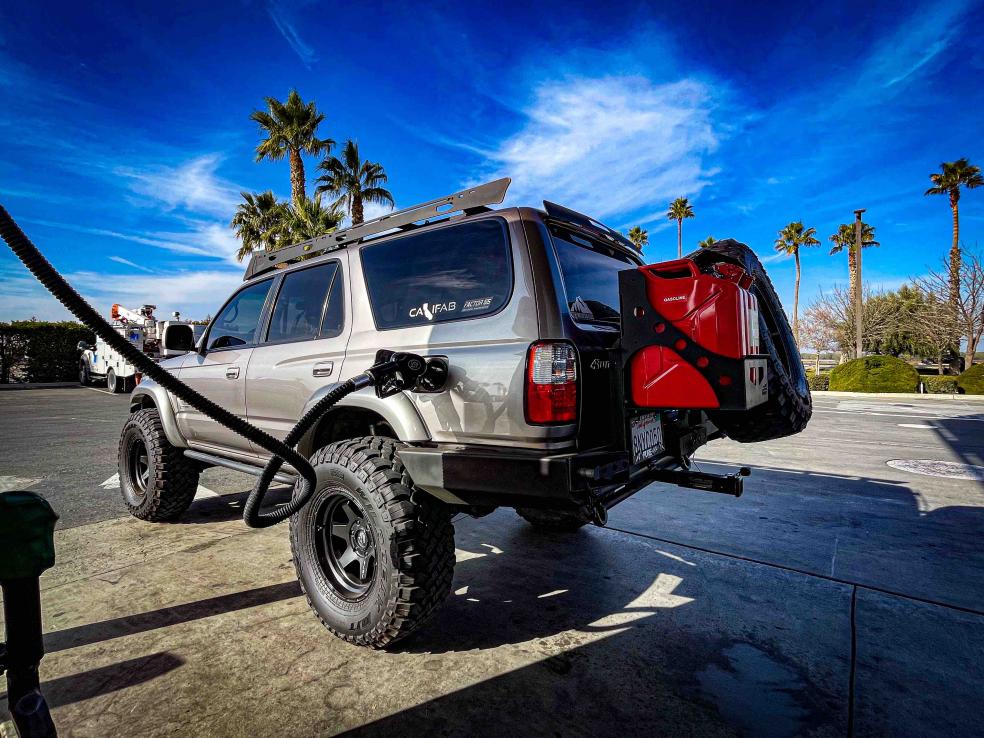

I finally installed my jerry can holder on my CBI swing out. Got a pair of Wavian cans from 4 Wheel Parts. Filled the tank, filled the cans, now I'm good to go.

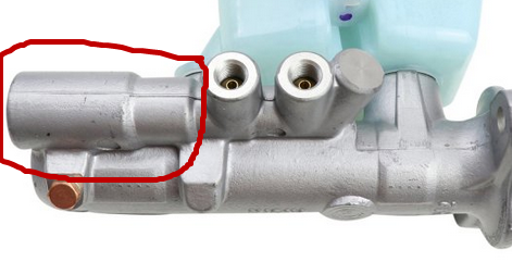

Finished up everything today. And bedded the brakes. It feels so damn nice! So much better then properly adjusted drums. Though it feels like the bias is more towards the front. Does anyone know what the extra cylinder does on a 2000 abs master? See pic circled in red. I'm guessing its either a internal proportioning valve or a type of accumulator due to ABS. Nothing in the FSM regarding that thing on the master.

Your brake symptoms sound like the booster is losing vacuum. With the engine off you should still have a couple assisted brake pedal pushes. You might try replacing the booster vacuum check valve and grommet before you try anything else.
Bit the bullet, ordered a 1996 ford f350 1 1/8 bore master and adapter fittings yeah it has a m16x1.5 port . More driving around today made it very clear the bias is more towards the front, that's a bummer. So hopefully this master which is from a disc/disc vehicle will solve the bias issue. I could have also tried a non abs 4runner master but they are pricy. Maybe a residual pressure valve too, but that is somewhat a band aid. Best to just use a disc/disc master. The master was only 35 bucks too.

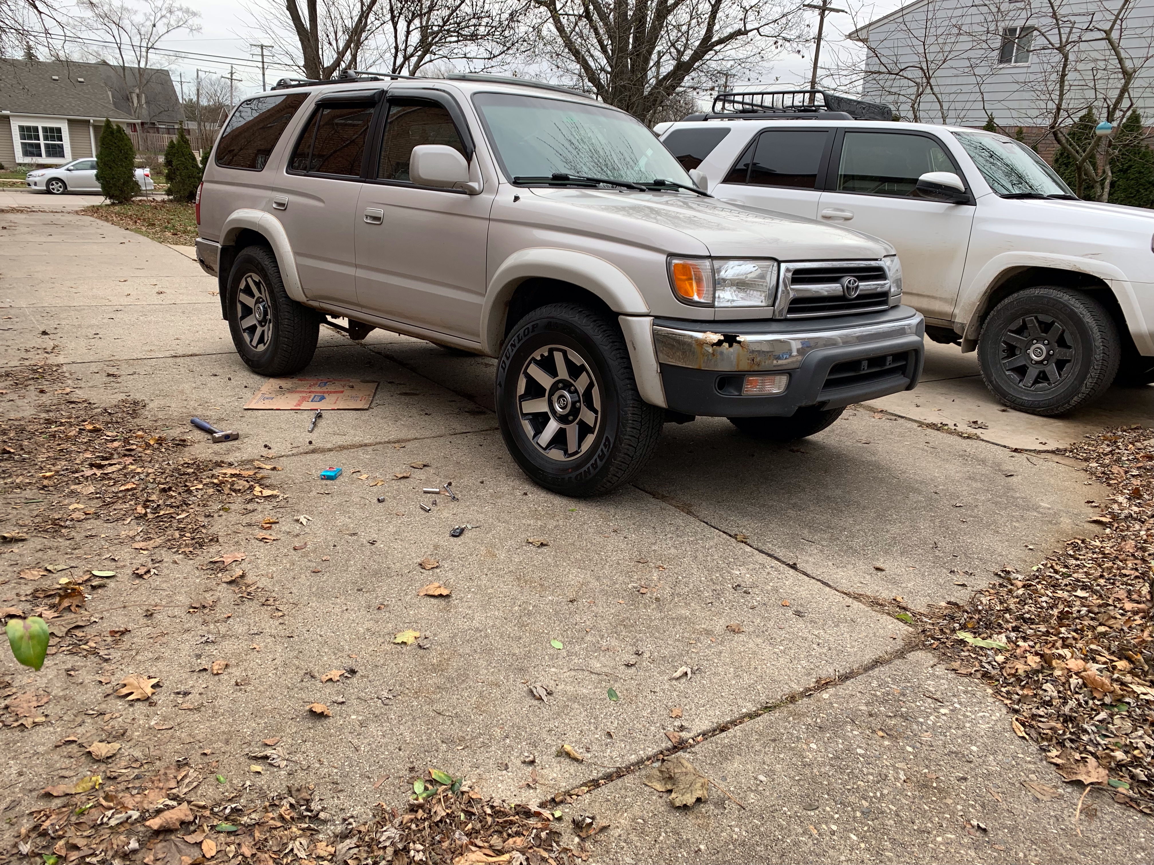

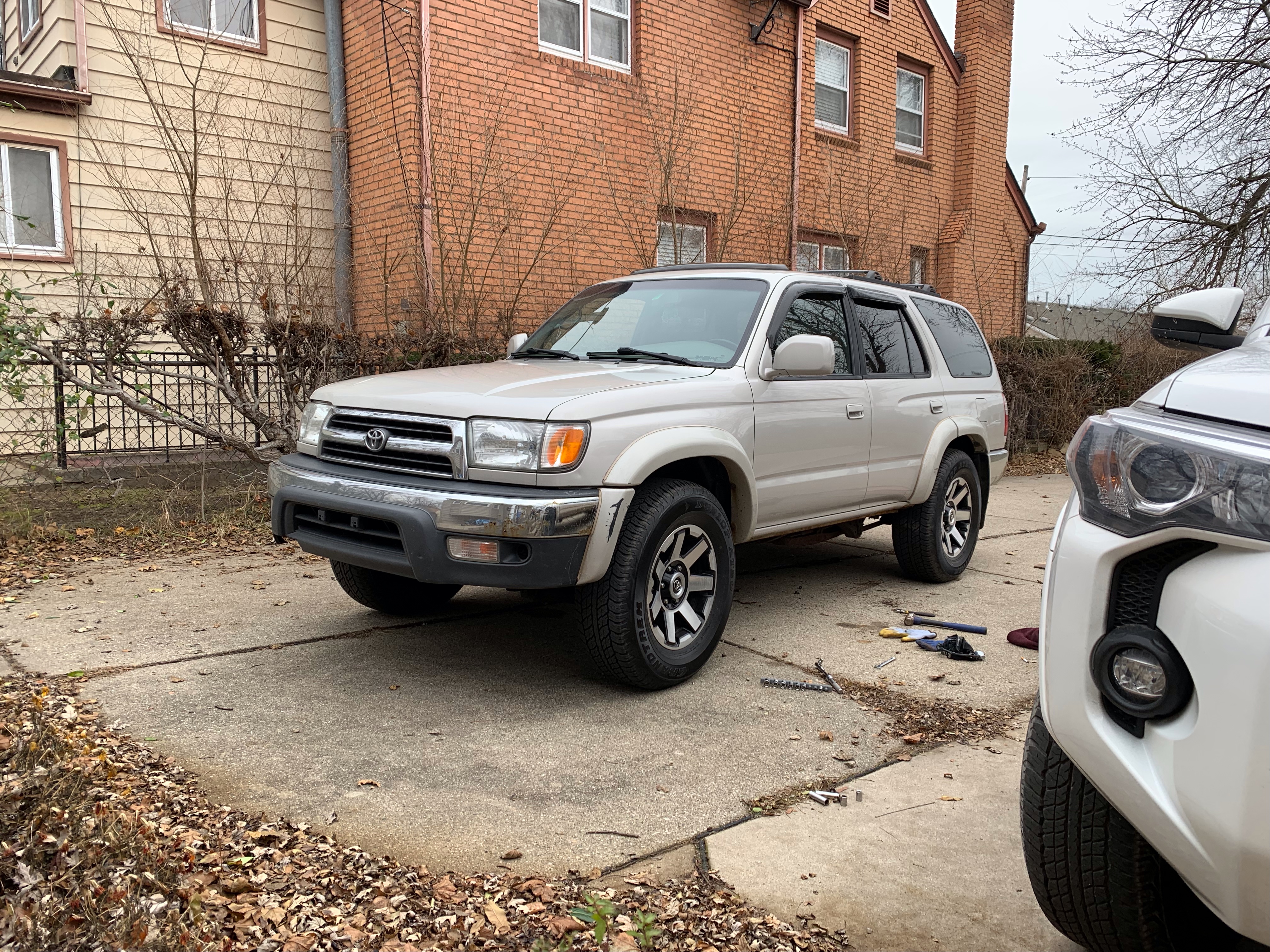

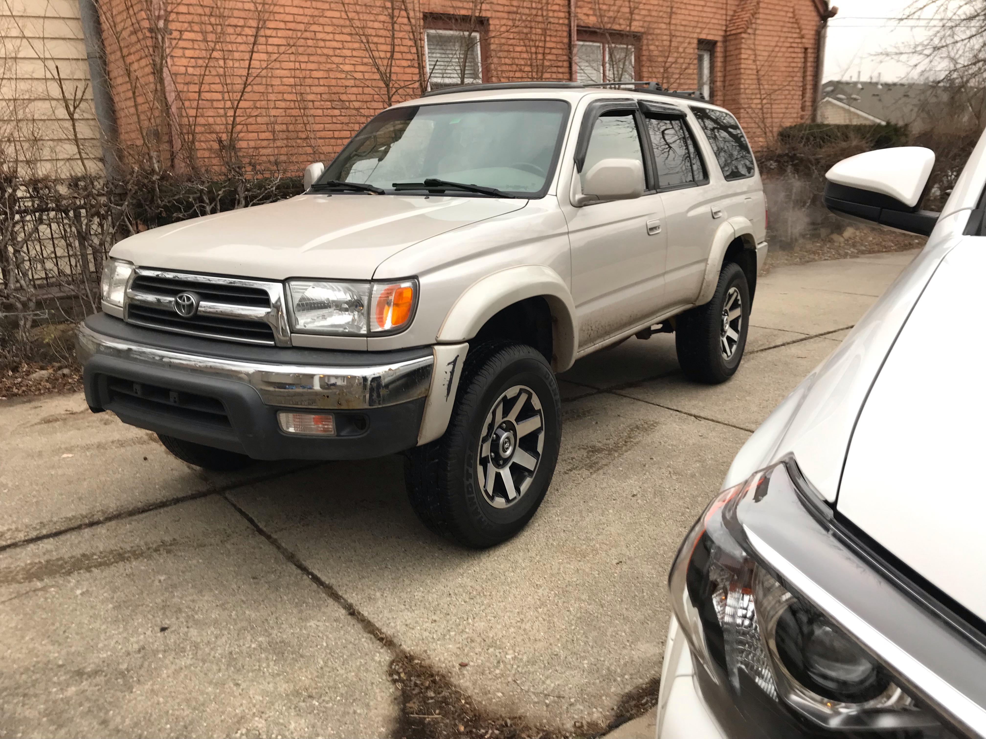

I took some time off of work to give my new-to-me 3rd gen 4runner some Christmas love.
What we did together:
Dobinsons 2 lift kit
Rear diff love: diff relocation mod (fabricated at home), drain & fill, replaced both plugs with new OEM
Rear hatch struts
Lower ball joints Driver's
Passenger's
Super excited that I accomplished the install by myself. I have never done anything like this DIY before. The process wasn't with some hiccups, but I'm proud to share the successful outcome! I would never had attempted doing this without the wonderful resources shared online by the 4runner community. Thank you all :hatsoff:

Yep, well I too have the blazer master as well. Not going to install it as I'd much prefer to use a master from a vehicle that is disc all around. As per my calculations the fronts piston area is smaller on the tundra vs the 4runner, but the mustang are significantly larger then the 4runners wheel cylinders.
Currently, the pedal has longer travel then normal and is soft (NOT spongy). It stops the runner nicely, but after driving around the other day it is very clear the bias is out of whack, way more to the front. Only thing I can diag it back to is that whacky valve thing on the abs master (pic I posted a few posts back). Swapping to a different booster and toyota master ups the price substantially. I am tempted when I pull my oem master off to pull that valve thingy apart and see what it is/does.

ETA - just checked my stock master, tracing the lines it is indeed a backwards master, the front port is the rear and the rear is the front. That needs to be noted when swapping masters. Make sure you install the lines on the correct port.
