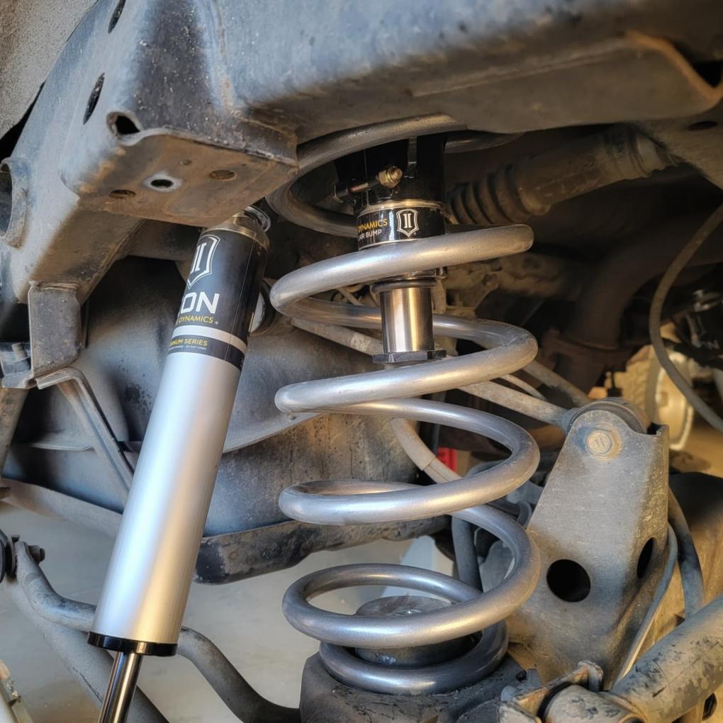

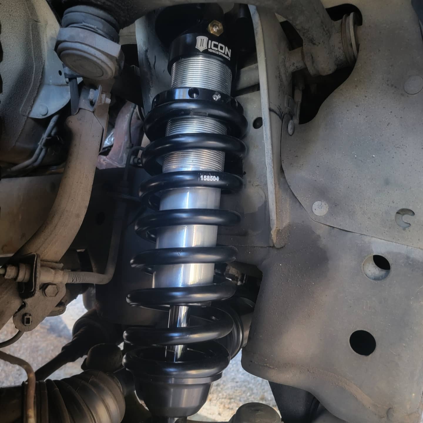

Installed the Icon coilovers and rear shocks/ bump stops. Had a set of RoughCountry 3" springs sitting around that went on as well. Got rid of the squat from the worn out factory springs. Have to raise the front a bit from their shipping height to level it. Waiting for the spanner wrench I ordered since it's not included with the kit. Rides better than I could have ever imagined for a 24yo truck

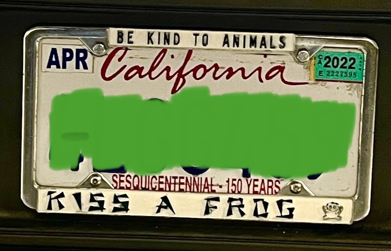

It's been pissing down rain out this way so I haven't done anything lately. i will admit to a strange habit of swapping out my rear license plate frames depending on where I am hanging out. I have vintage Barstow and Indio frames for that part of the CA desert, Eureka for Humboldt trips, Yuba City for the Lost Sierra, even Salem Oregon for Bend or Oregon Dunes trips......keeps 'em guessing. Here is a generic 70's looking frame I came across, complete with the (now-culturally-insensitive - sry) Chop Suey font that basically says "I'm ugly". That's all I got this week....

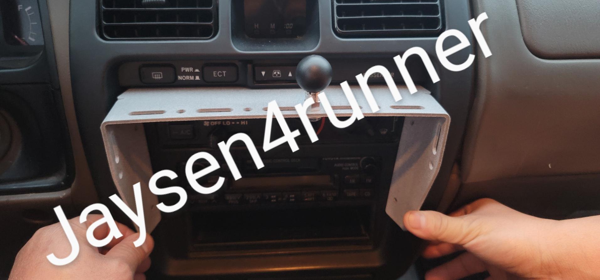

I want to replace the dimmer/rheostat switch, but can't figure out how to get the assembly off. I got the knob off, just can't seem to find some info on how to get the assembly off the backside of the bezel. Any help? thanks.

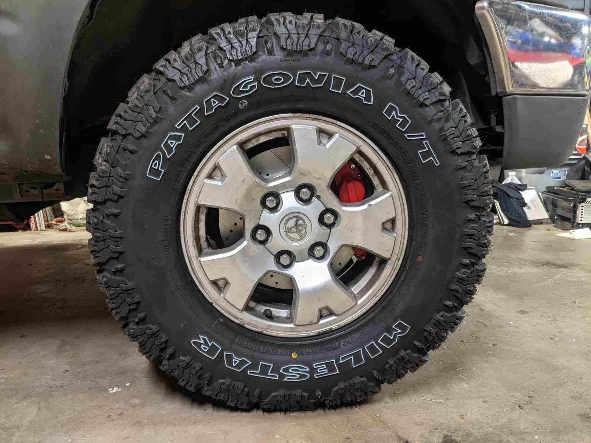

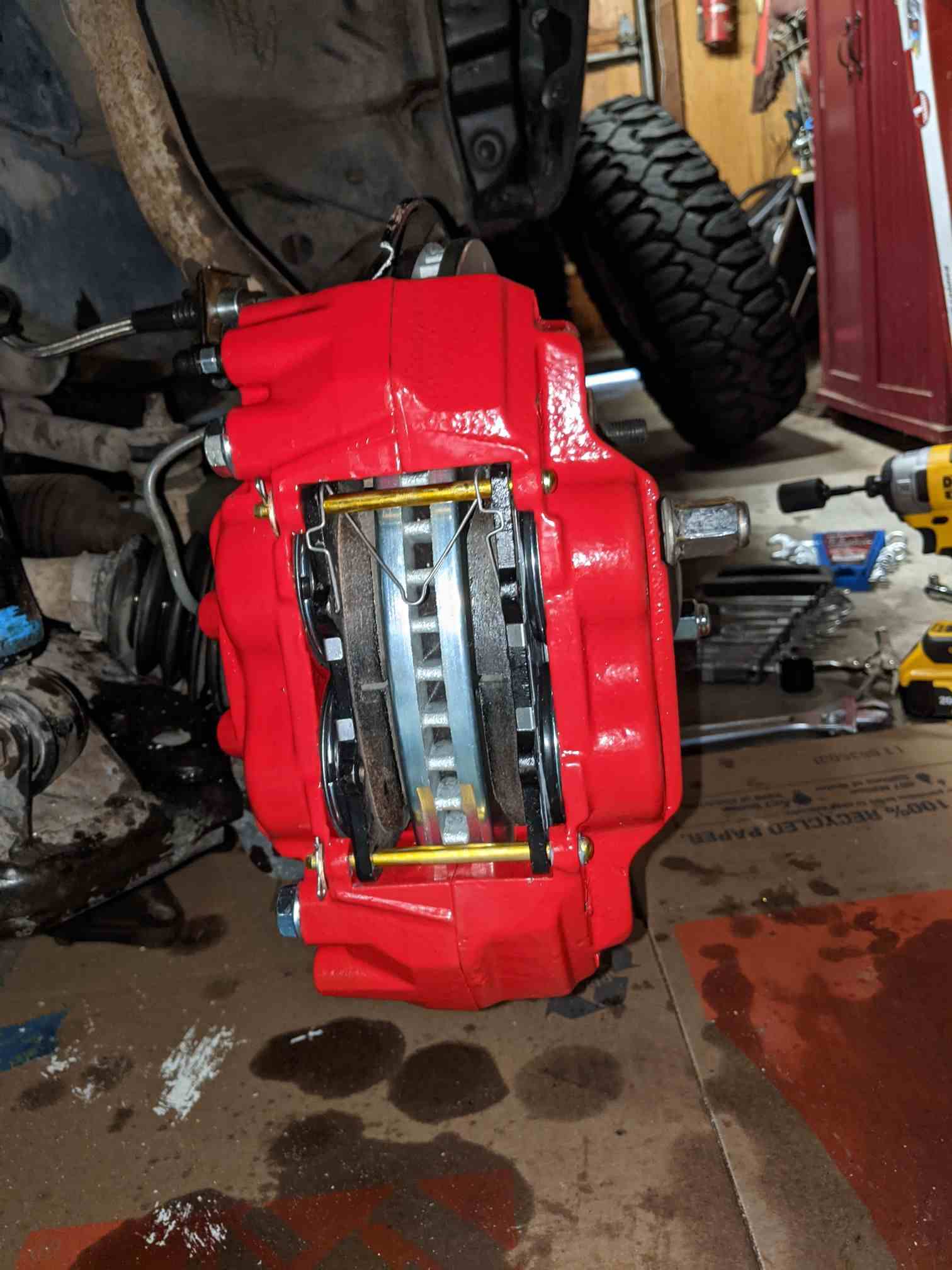

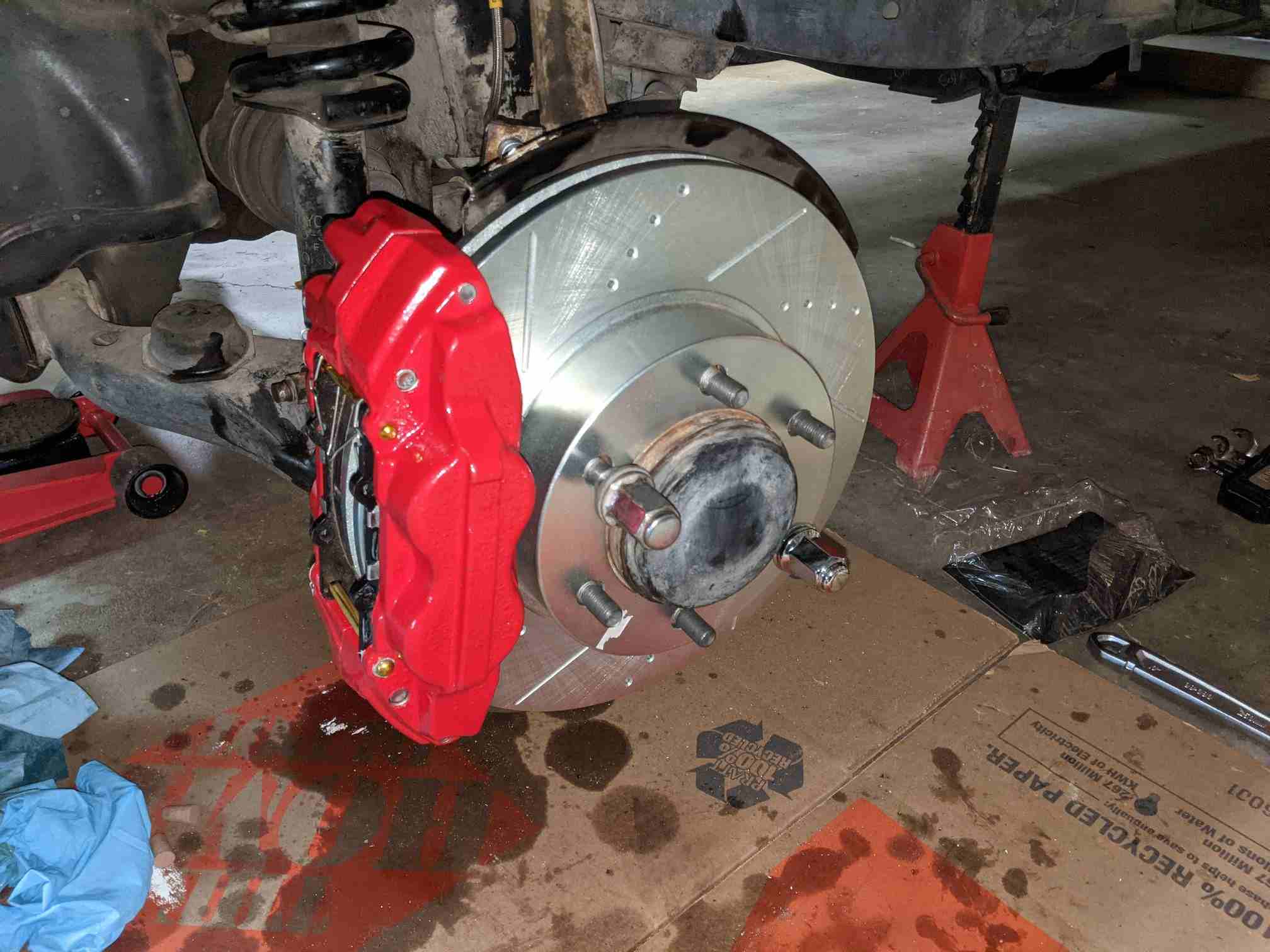

First set of M/T tires and 231mm TBU!
I went with the PowerStop kit from Amazon for the 231mm Tundra brake upgrade, also upgraded the hose to stainless steel while I was there. The brakes have been great; they feel a lot stiffer than I expected, which I guess is a good thing? They're super smooth though, much nicer than the rotors that were on there.
I went with the Milestar Patagonia 265/75r16's and I've been really impressed with them. They are my first set of M/T tires and they ride smoother than the cheap all-terrains I've used in the past. They do have road noise but it's really not noticeable unless you have the radio/AC off and are listening for it. They rub a tiny bit at full lock in some situations, but I'm also running the 2nd gen taco "snowflake" wheels, so that might mess with the spacing.
I got them stuck once, trying to crawl up a hill made of loose dirt right after it had rained, in 4HI, and at 34psi. So not really the fault of the tires :D I'm excited to get them out on more trails though!

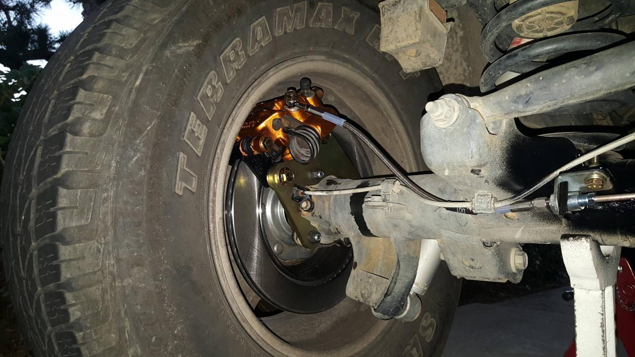

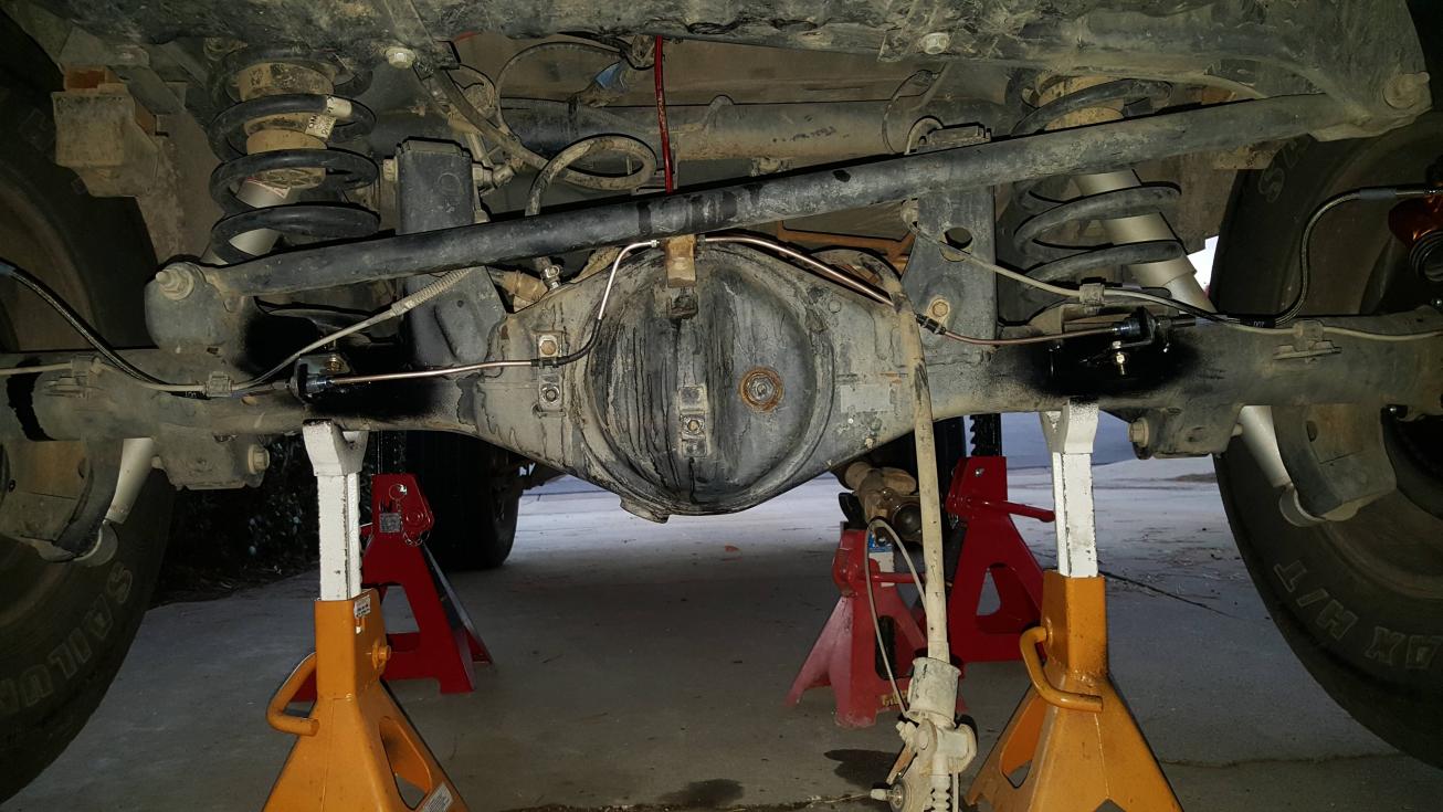

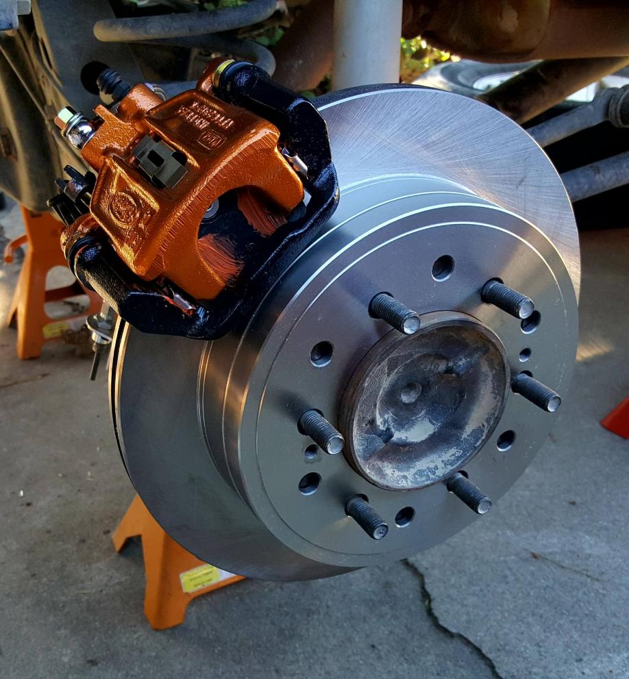

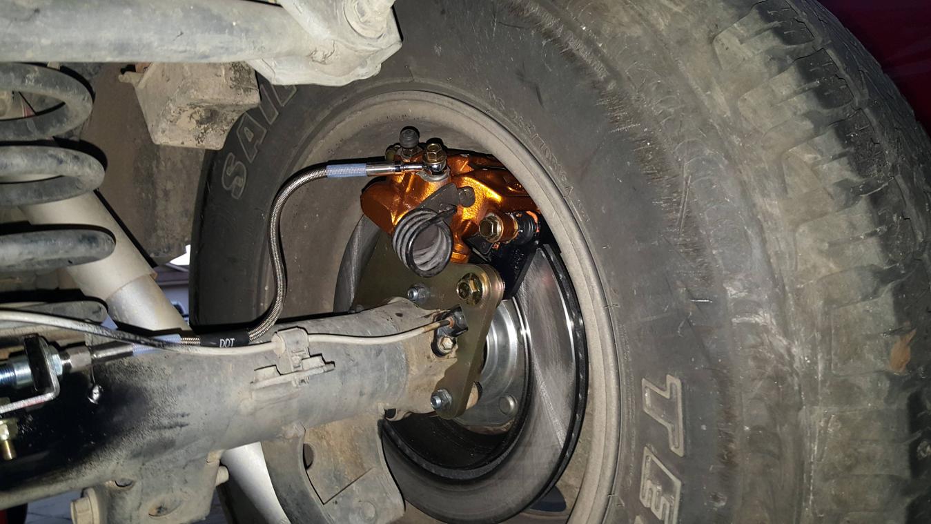

Got the midcoma rear disc conversion installed, well most of it. Just need to do the parking brake stuff tomorrow. Damn stuff is wicked. Brake bleeding went smoothly. Rear bearings and retainers and seals went smoothly. So nice not having drums anymore.
Now I don't remember if my pedal did this before, but with engine off the pedal is solid, rock hard (w/disc's on all 4 corners). With the engine running, it is firm then starts to sink. I don't recall if it did this before I did all this brake stuff. 231's up front, mustangs in the rear. I have a feeling its the booster as the pedal is rock hard with the engine off. If its the master it would do it with the engine off and running.
Also looking at swapping masters too, either a f350 or a caddy es-kool-aid. All depends how it feels when driving it.
