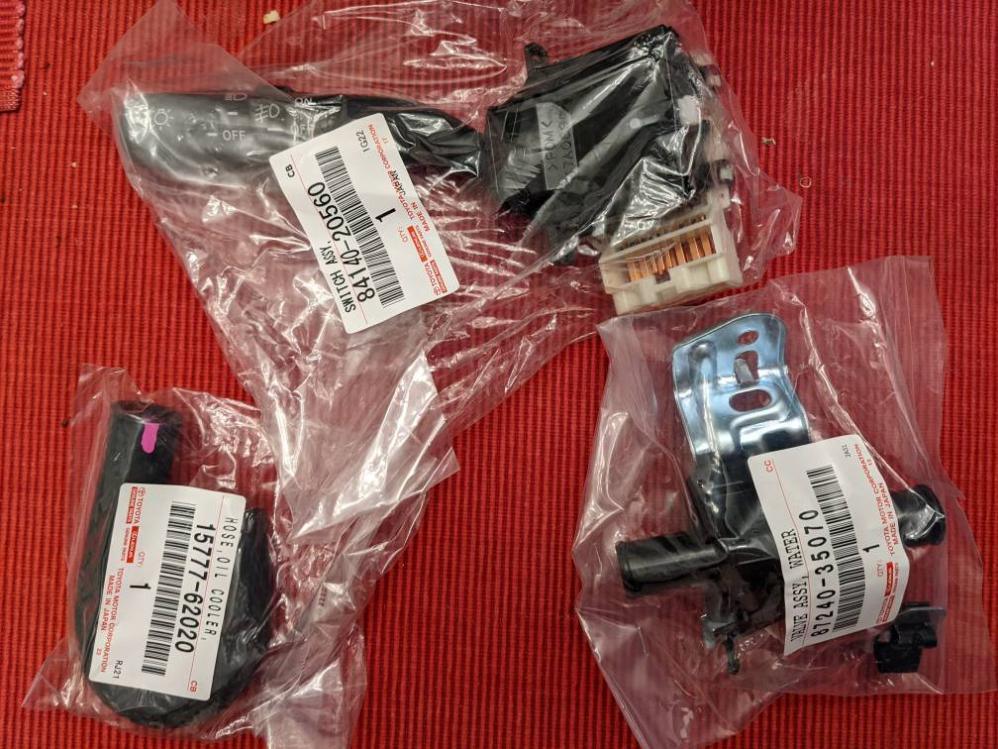

I'm gonna add fogs to my factory wired 4WD inside my 4XI bumper at install and mod the wiring for anytime useIs Amayama suspect for sending non-legit parts?
I did the same with the factory fog light wiring to aftermarket lights. Just make sure to check the current draw on your lights to see that it doesn't exceed the factory circuit. It's only 10 amps I think.
Most normal sized LEDs will be well under that, but the large round ones I have up front now are like 7 or 8 Amps each so I have one wired to the fog light switch for easy on/off use as a high beam and the other wired to a standalone switch for when I'm on the trail and want both on without needing to be able to switch it off fast.
