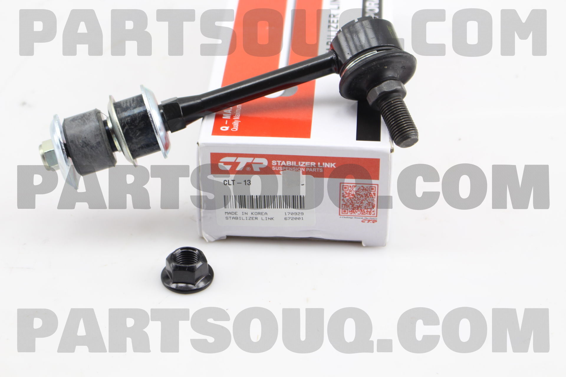

Speaking of end links, I replaced mine with OEM ones from PartSouq today and it doesn’t look right. Shouldn’t the teeth be in the sway bar? And yes, I reused the metal cushions because I forgot to order new ones.
That looks right, according to their website:
I don't recall seeing the teeth on my links, I think they looked more like these, but maybe they are aftermarket:
The teeth/texture is to grip with pliers to keep the stud from spinning when tightening/loosening the nut.
I dug up my original end link - it looks like your end link, but has an additional piece that is pressed over the serrated part - that's what acts as an anti rotation feature. The weird thing is I can't find this piece on the parts diagrams.
