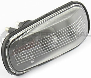

Hard to tell from the pic, but it looks like the Saab side markers I'm using on mine.
They come in clear/yellow bulb or yellow lenses.
If you wire the hot wire to the parking light circuit, and ground it to the hot wire on that side's turn signal bulb, it will do both. When parking lights are on, current will flow through the side marker bulb and on through the larger turn signal bulb, lighting the smaller side marker bulb, but not enough current to light the turn signal.
And when the turn signal bulb goes on, then that circuit 'saturates' (probably not the right word) and no long acts as a ground for the side marker bulb, so it goes off.
Net result, bulb is on when parking lights are on, bulb blinks when turn signals are on.
I saw those on your truck, my plan is to just make my marker lights flash with the turn signals but I was going to do it a little more complicated, using a relay to interrupt the ground circuit to the side marker bulb. I'm already spliced off the positive marker lights for other things so I can't interrupt that wire.
Am I overthinking it?

Give it a try wiring it the way I did, with a 'floating ground' on the turn signal hot wire. It wouldn't work with similarly sized bulbs, but since the turn signal is big, and the side marker is small, it works.
Forgot to mention, when the parking lights are off, and the turn signal turns on, the side marker light will light as well, current going the other direction, hot from the turn signal, grounding through the parking lights (again, enough current to light the little side marker bulb, not enough to light up all the other parking lights). That won't work with an LED bulb, though, those are diodes and current will only flow one way through them.
Thanks, I'm all LED
I'll PM you to keep things less cluttered here
