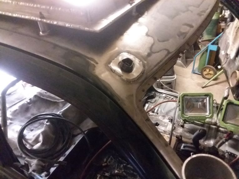

It wasn't exactly today, but, repaired my automatic antenna on my 1997 base model. The weld that holds the bracket that holds the antenna motor to the body broke. The antenna shot out of its track and landed in a parking lot. I removed the fender and paid a guy to tack-weld the bracket back in place. The radio works perfectly now. Well, maybe not perfectly, but pretty good for being 23 years old.

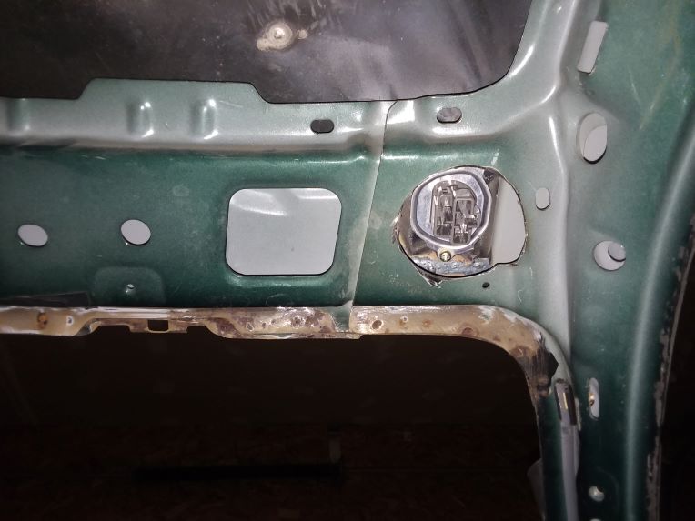

Replaced the antenna mast that decided to fly out at 80 mph somewhere near Sacramento:
New part from amayama:
Five minutes later, good as new:
The teeth didn't look all that worn, so I didn't bother to go through the hassle of disassembling and cleaning the motor of any debris. Time will tell if this was a wise gamble :).

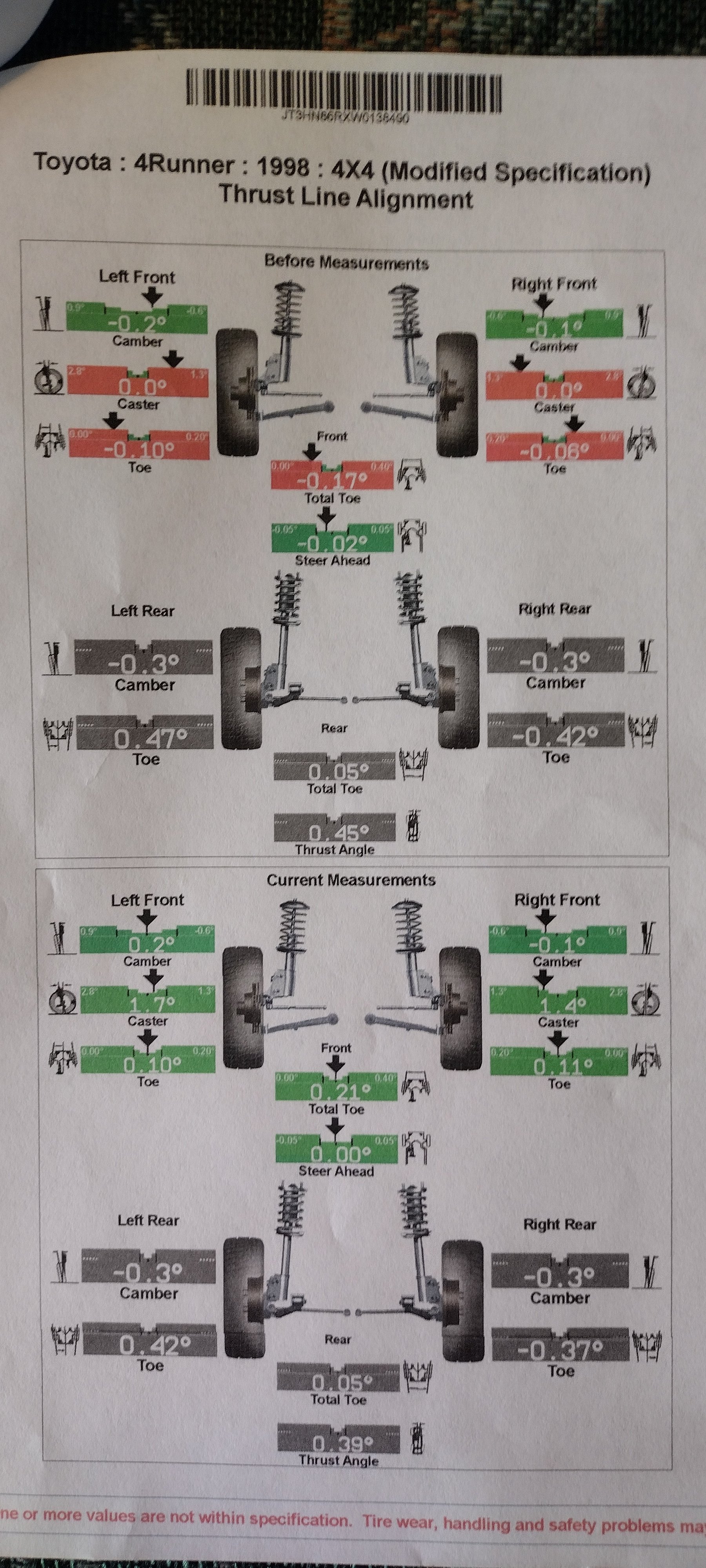

Welp.......decided since I'm going in for the alignment just to make sure I don't have the dreaded cams seized into the bushing sleeve. Driver side was great. Passenger side is a different story. Took the nuts with the adjuster plates off and doused the interface between the bushing sleeves and the cams on that side with PB. Hoping probably beyond hope that I'm one of the few lucky ones that this works for. Otherwise I guess I will install those whitelines that I have sitting on my desk currently (probably going to try the axle nut trick instead of going out and buying a sawzall and the diablo blades). Originally decided to hold off on those because most of the rubber on my truck looks great still and frankly the new rack and OTREs actually seems to have largely solved my wandering steering problem (I also wonder if the screen cleaning had something to do with it as I'm sure I now have much better PS fluid pressure).
Well bad news and good news. Bad news, cams were still frozen solid. Good news is somehow they were still able to get pretty decent caster out of that side, not really sure how they pulled it off but they obviously got some movement out of those cams just looking at them (I assume they are just binding the bushing up a bit? could that potentially cause the alignment to slip?). Also appears I managed to get the toe on the driveway alignment pretty good after installing the rack. Tru Automotive on the S side of Denver really came through for me, and great customer service as well when I decided to add in a mount and balance of a new spare last minute. Also they got my steering all reclocked on the input shaft to rag joint connection and centered out my tie rods. All for 125. She's driving great now too, wandering steering is gone now and I have a wheel that centers. Anyway here's my numbas.
