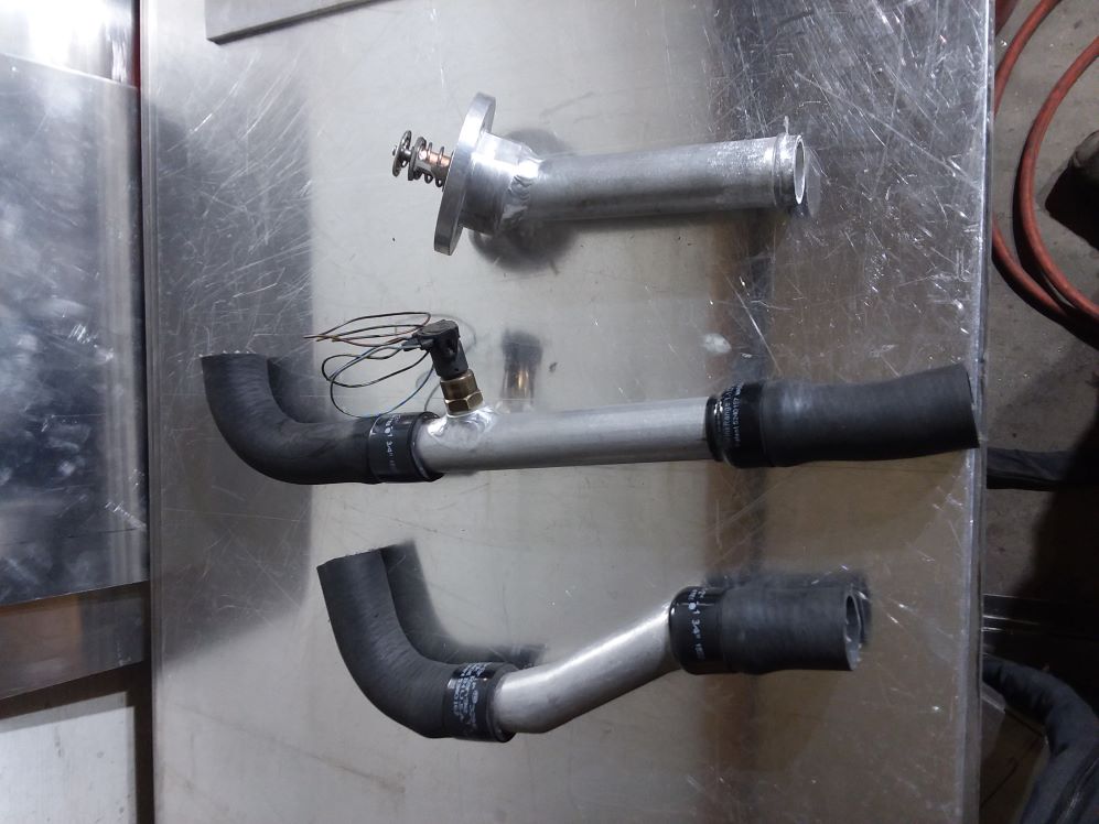

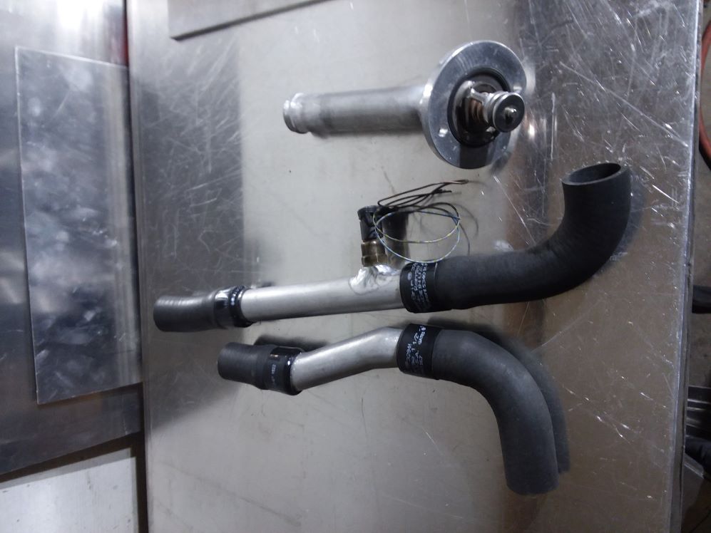

Finished up new upper and lower Rad hoses along with a new thermostat housing.

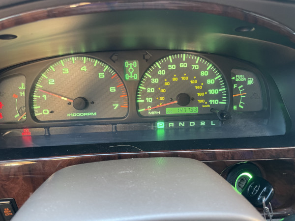

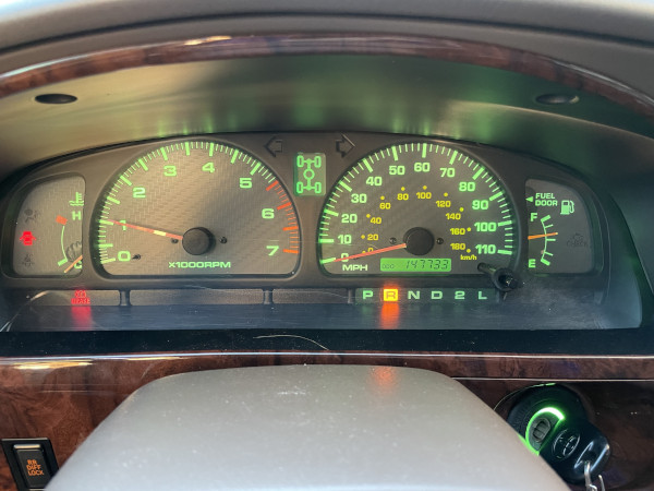

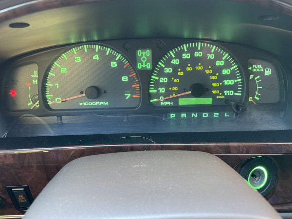

Installed green LED dashlights!!! Next up, new stereo head unit!
