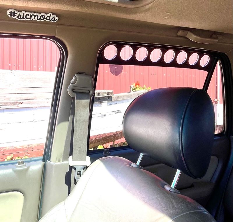

Didn't want to leave the Pick-N-Pull empty-handed, so I grabbed a pair of black Lexus headrests. Barely qualifies as a Mod and def not a #sicmod LOL.

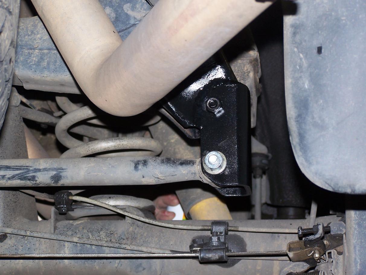

Speaking of rear end stuff. Has anyone use both the panhard drop bracket from Yotatec and the PCK from Eimkeith? Curious if the $50 drop bracket is pretty decent or if the Eimkeith is that much better that it's really the way to go. Definitely getting tired of that weird rear steer I'm getting back there.
The drop bracket from Toytec is a rip-off of the Sonoran Steel design. I've had mine on for 20+ years. The Eimkeith version is better because it raises the roll center since it's a 2-part design and will make the truck feel less "tippy".
With that said, the SS version does center the axle and helps with tracking and drivability.
EDIT: My truck doesn't feel "tippy", by the way. Good suspension bushings, springs and shocks along with JBA or SPC UCAs and upgraded rear links along with good sway bar hardware go a long way towards truck stability.
[MENTION=720569]Rushthezeppelin[/MENTION], had the Sonoran Steel on 96Red, have the EimKeith on 01.
Eimkeith design is the better keeping panhard bar level, which is how it should be
at any given lift height. The factory bar is used and centers axle perfect.
If welded on correctly.

Did you have the adjustable bar? I have the original drop bracket that Steve designed. My track bar is level with the rear @ 3" of lift.
Sure did, if you want to call it adjustable having both ends RH threads. Steve cheaped out on his
design by not using LH & RH threads so you could adjust it attached at both ends on truck.
8 wrap = 4" lift plus shortened cone bumps adds 3/8" = not being level.
Steve a OG in this but times change, You dig into the the arc swing of rear axle as it droops and stuffs
you'll see the benefit of Eimkeith's design.
