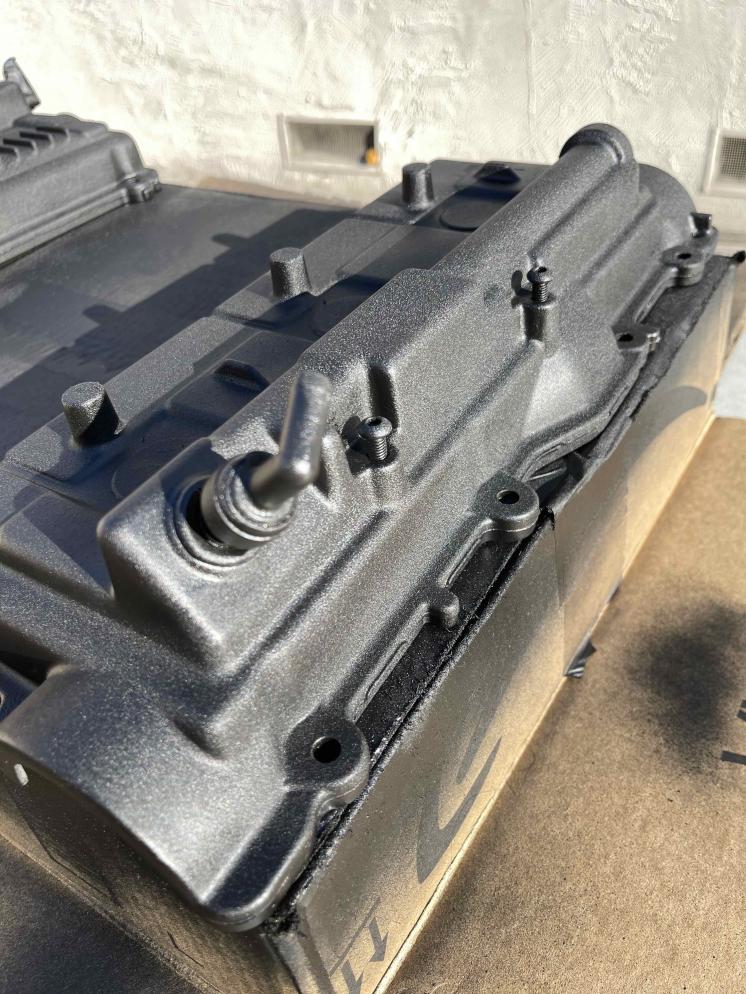

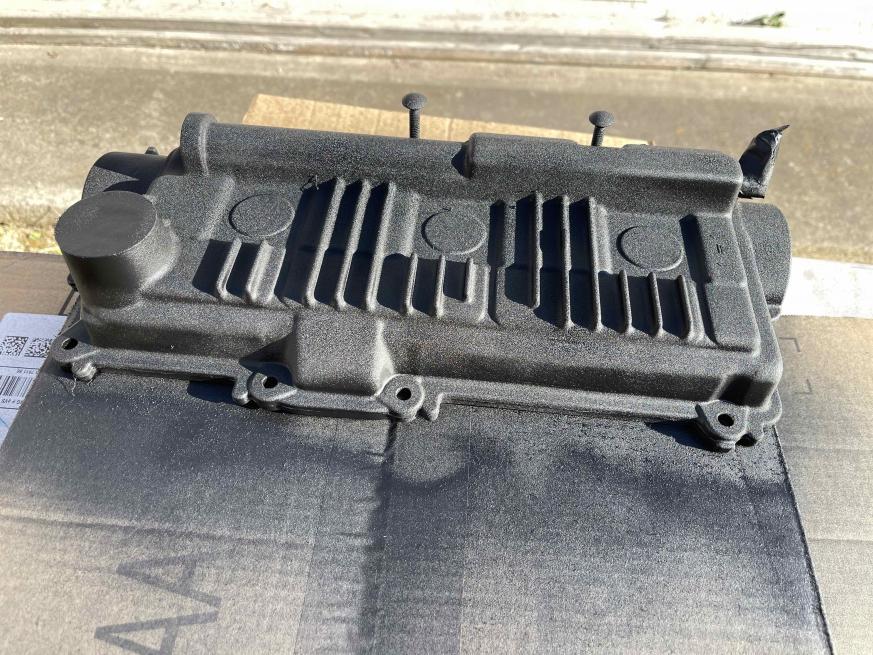

Made progress on putting some things together in the engine bay. Valve covers are back on, new injectors are in, and the intake is back in place. I really like how the re-plated parts came out, especially that throttle linkage assembly.
looks REALLY good!!!
im going to be doing the something similar went down the path of the wrinkle black look. since there will be a supercharger on top, it will "roughly" (pun intended) match the supercharger coating... hehe

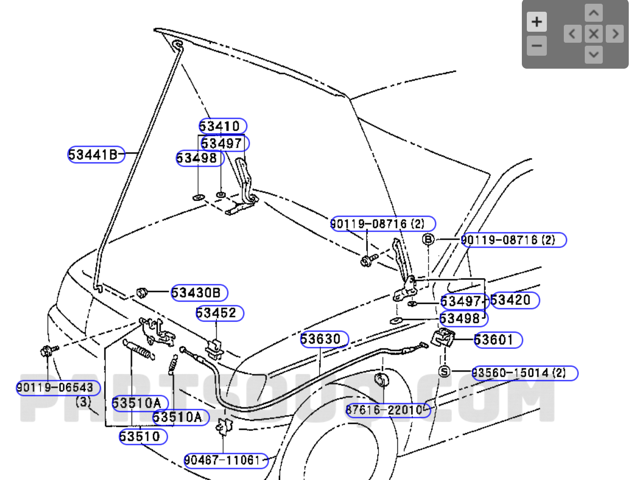

On a totally different note, I couldn't get over how out of place the hood prop rod looked to me in this diagram. Those Spiker Engineering hood struts have really spoiled me!

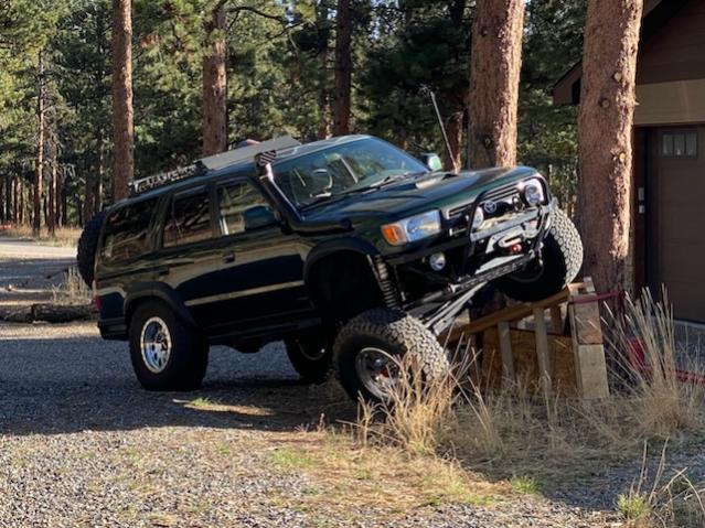

After waiting on parts, my sas is 99% complete. The front is a 4wheel underground 3 link, 14” Radflo coilovers and a Diamond axle. The rear is a self designed 3 link with 12” Fox shocks.

/\ /\ /\ Nice!!!
