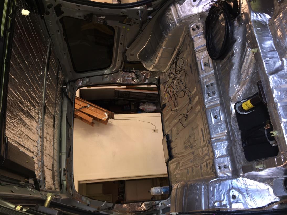

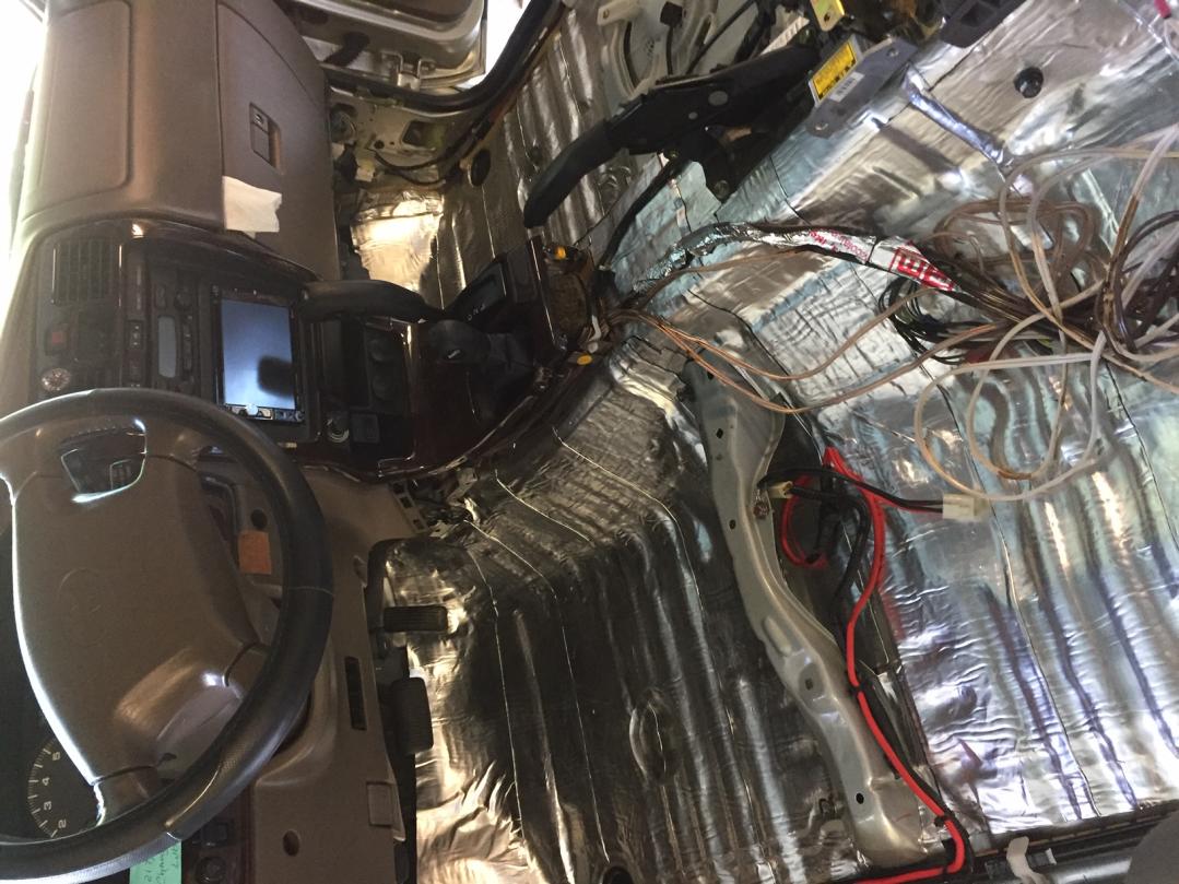

Got me to thinking of when I did lil sound deadening.

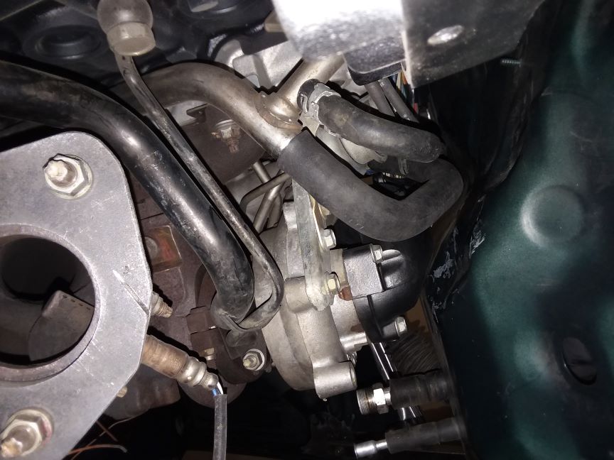

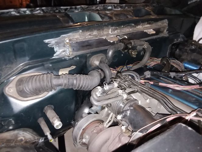

Probably doesn't seem like much... but got my heater core hoses worked out, even managed to find an over the counter for the pass side connection. Also working on how to re-plumb the AC system with the driver side compressor.

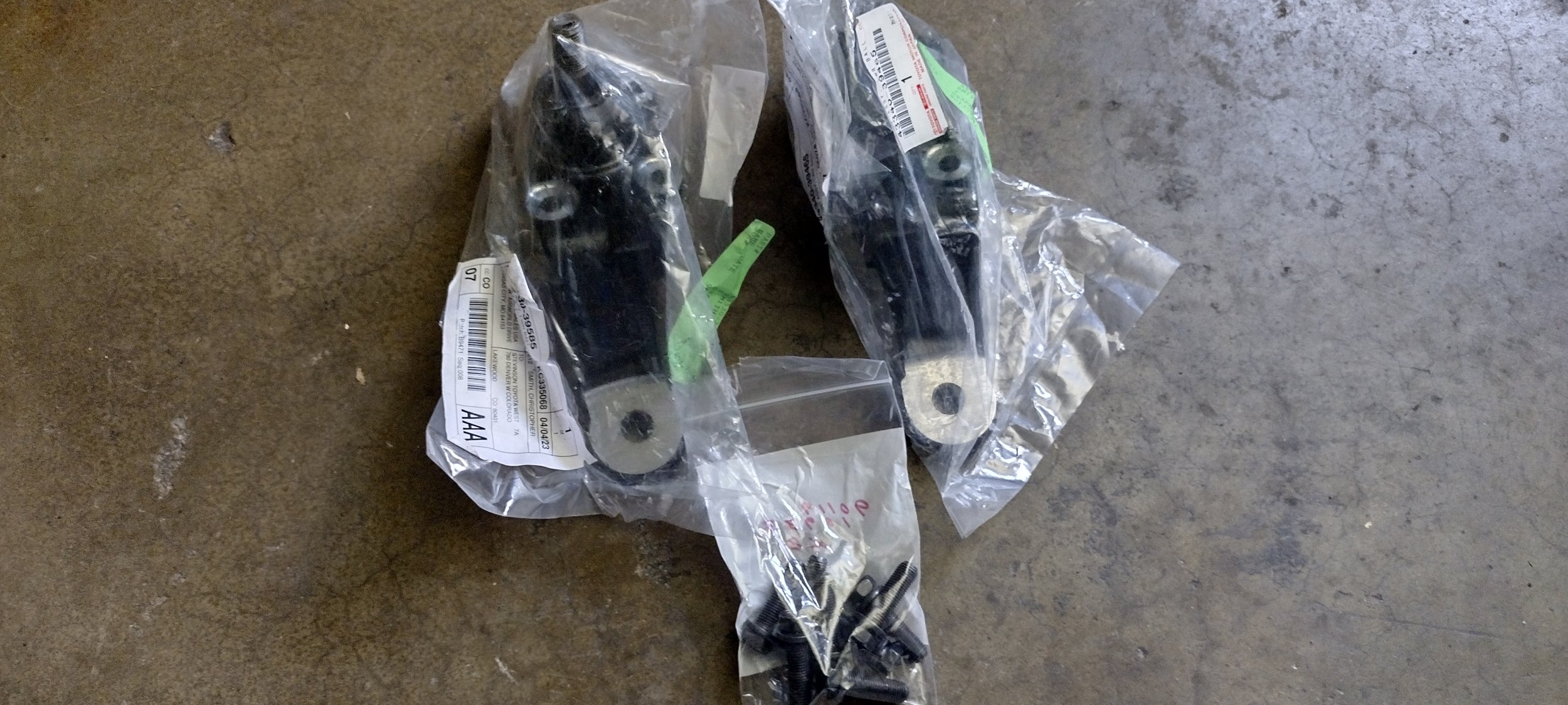

You'll have that warm fuzzy chit knowing your wheel not gona fall off :lookout:
Yeah I definitely have not so much warm and fuzzies right now. Moogs currently on there and they are fairly new, been checking for slop frequently. Then I ran into another 3rd gen on the trail the other day (living out of the 3rd gen and had just got done doing axle seals at a campsite lol) and he said he had the same situation, newer moogs and was checking slop and then one day the bolts on one side sheared and he had a 1k repair bill. Next night I ordered OEM ball joints with the Toyota black bolts. Definitely not interested in my wheels falling off lol. Will swap them when I'm in there swapping my control arms next week. I'll have supreme warm and fuzzies knowing I have good ball joints and not frozen cams (really looking forward to more caster) and fresh poly bushings. After that I'm doing rear arms and then I'll have nearly rebuilt the whole suspension on this truck (It will just be UCAs up front at that point).
That's awsome! How much of a difference did it make?
Alot, no decibel data.
Roof 3 1/4" layers corrugated poly heat shield.
1.5 Queen size 1.5" mattress pads stuffed in air space between bodysides, B C D pillars.
3/8" carpet padding old stuff removed, OE under carpet cargo area rubber mat.
I'm used to it now, yesterday alignment tech driving, me shotgun 10 mi interstate/city made comment on it.

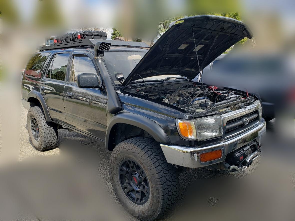

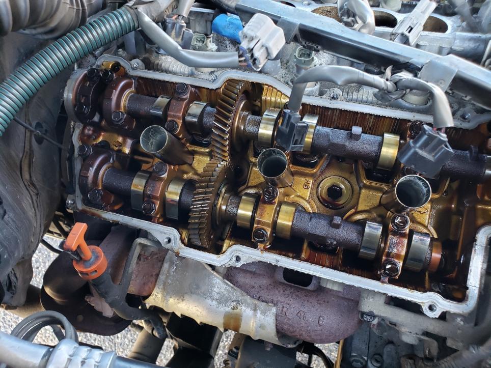

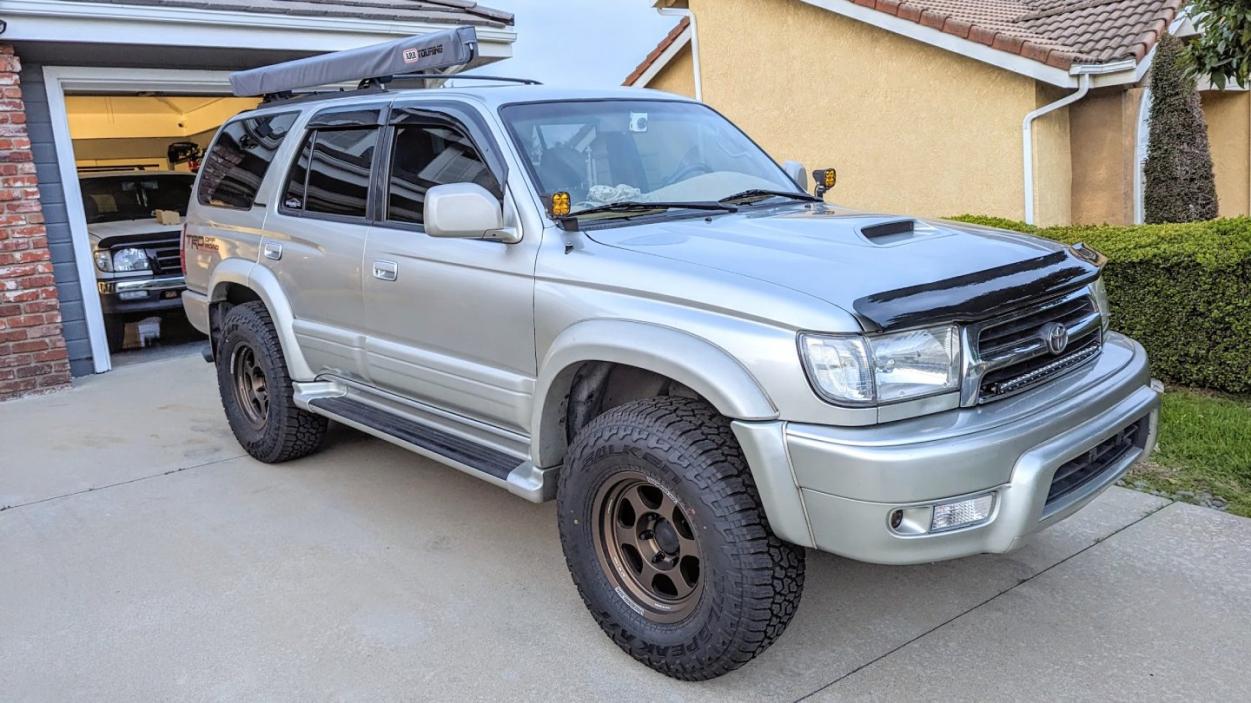

Did the valve cover gaskets and installed some fender flares and a box up top

nice! i'm getting ready to do mine with dynamat, probably wont be quite as thorough as yours looks like you went all out. beautiful!
the fender flares look great, who makes em? i've got a 98 that i'm considering adding flares to too
They're a set of the bushwacker flares. They look pretty good, but I wasn't completely happy with the set. It sits slightly off the fender in a couple spots due to it not being cut properly. Most people probably wouldn't notice...but I do :noidea:
I have the same flares. It's just manufacturing tolerances. The factory flares mount to the body with through holes to minimize gaps. Mine have been on for 15+ years and still look good, so I'm happy about that.
Great looking truck, BTW.
