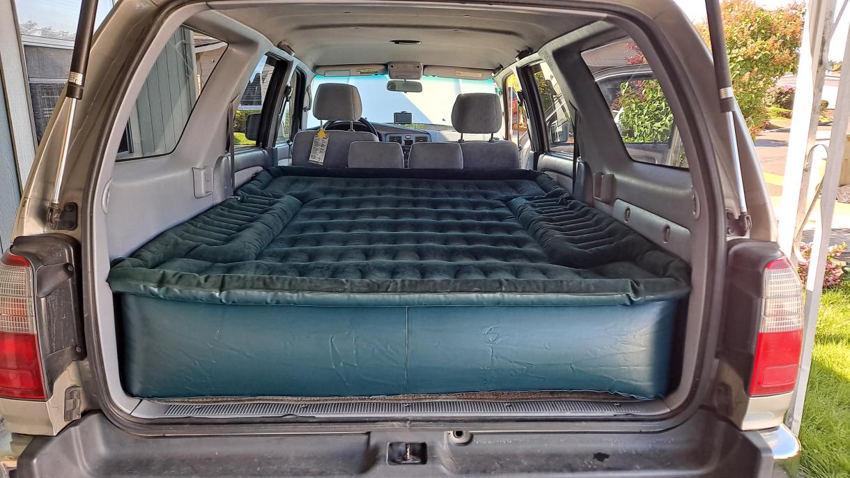

I did a test fit of my new Pitman Outdoors PPI-PV203C AirBedz Lite air mattress in the back of the 4Runner. After emptying the cargo area, I lifted the rear seat bottoms, put the seat backs down and popped it in there. Fit like a glove. It is asymmetrical where the cutouts for the wheel wells are, so the short pontoons go to the rear of the cargo area. I would remove the head rests for sleeping.
My wife bought this for my birthday. We will be using on a few upcoming trips. It comes with a carry bag, a 12V pump and a patch kit.
Here's a link: Amazon.com
Is that thing insulated? I can't tell on the Amazon listing.
I just bought mine the other day, so I just removed some windshield stickers, phone mount, random sticky gunk to clean it up some.
