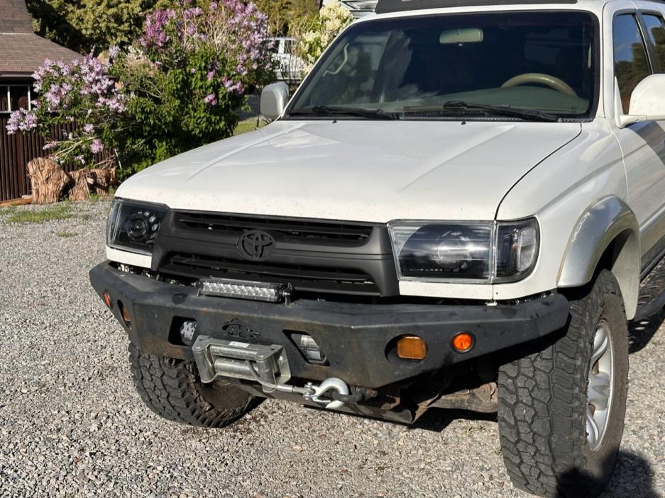

Installed TEQ lights
Lights installed may try and switch day time running to amber on Halo. The BXbuilt was a bust but TEQ assisted.
