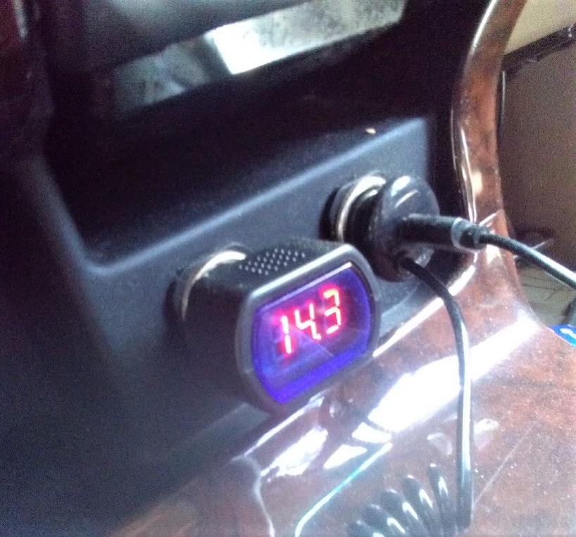

I got tired of waiting for my more complete alternator rebuild kit to show up, so I got just the brushes from Autozone.
Pulled the alternator off, and the bearings sounded great. Took the cover off and then found that while the regulator and brushes came off easily, the screw holding them together was really stuck in place. I could probably have drilled it out, but decided to just wait for my more complete kit.
That arrived, I put the new regulator and brushes in, put it back ont he car, and yay, 250K alternator is good to go another 250K miles again (hopefully).
I stuck the bearings and extra brushes on the shelf in case it ever needs that.

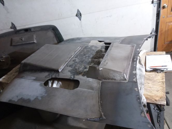

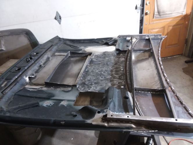

trying to c how bad I can (*^@ this hood up, the thin hood metal, plus all the welding, and my lack for know what I'm doing...
Functional hood scoops are not allowed here sir. J/K
That looks like it'll great air flow. Are the extra holes for shocks?

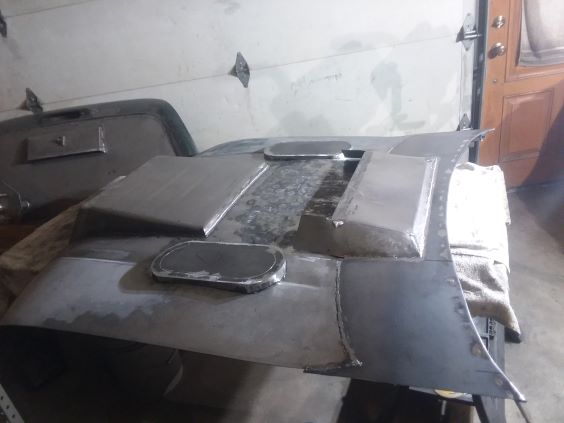

Yes, have 16" travel plus had to use long bottom shock mounts to maximize clearances when at full droop and tuck with said and what u c is the end result. trying to install the brackets/braces u c in the pic, the centers with be cut out after getting most of the welding done to help reduce warping the brackets. currently trying to figure out how to get them attached.
