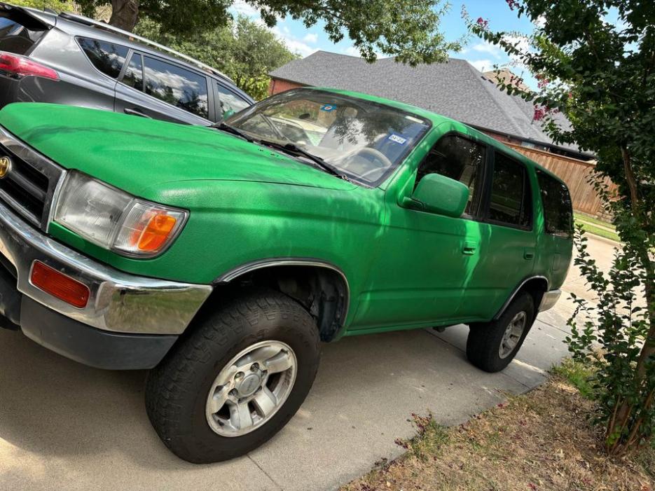

Got some ABS filament that's a pretty good match for the previous owner's bedliner paint job, and a roll of brown pretty close to the stock interior, so I'm slowly replacing various sun-rotted plastic inside with "custom accents."
Aside from thingiverse, anybody know of a good collection of 3D models of parts that could be printed for these? Of course the clock is dead, so I'm working on modding the phone mount front plate of the clock bezel phone mount design to a magnet mount instead of the ball that just doesn't want to print at the right size for me anyway.
