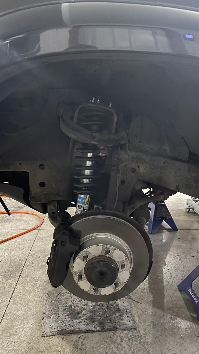

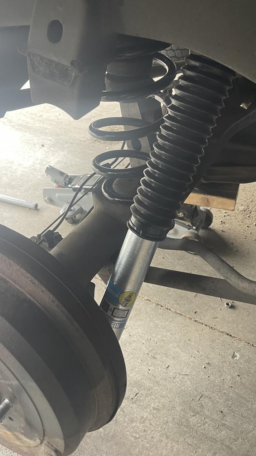

Fair shout! In-process pics below. I’ll get a pic of the side, before/after, once I’ve had some coffee.
In all, it went smoother than I would have expected. Yes, I had seized bolts on the bottom mount for my front shocks, but heat freed the driver’s side and a breaking bar was the ultimate solution for the passenger side.
Here are the measurement changes, measuring from ground to fender:
Driver Front: 35.25” -> 36.75” (1.5”)
Passenger Front: 36” -> 37” (1”)
Driver Rear: 34.75” -> 37” (2.25”)
Passenger Rear: 35.5” -> 37.5” (2”)
I’ve a full gas tank, so I’m guessing a wee bit of sag is expected, and it’s a far cry better than what I had before.

My OME rears were labeled and different lengths, OME non-adjustable strut driver side had 3/16-1/4"
shim washer between perch and spring to compensate for lean. May have to adjust D/S 5100 perch setting to
eliminate last bit of lean. SOP running Bilstein 6112's same spring length per side.

That’s very good to know, thanks. Yes, mine were labeled as well, and I made sure to put “A” on the driver/gas tank side and “B” on the passenger side, but it didn’t come with any additional hardware I could see. I’ll keep digging…
5100's with 5 positions I set perch one notch higher on DS. For rear's some use 10mm trim packer.
