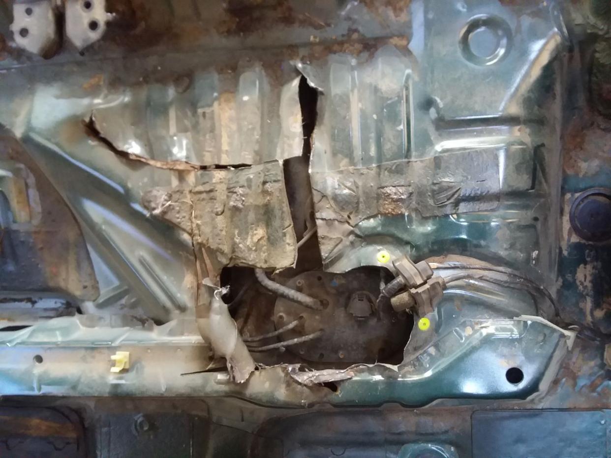

Found some top notch work on a 4runner being cleaning up to rework at some later point:
