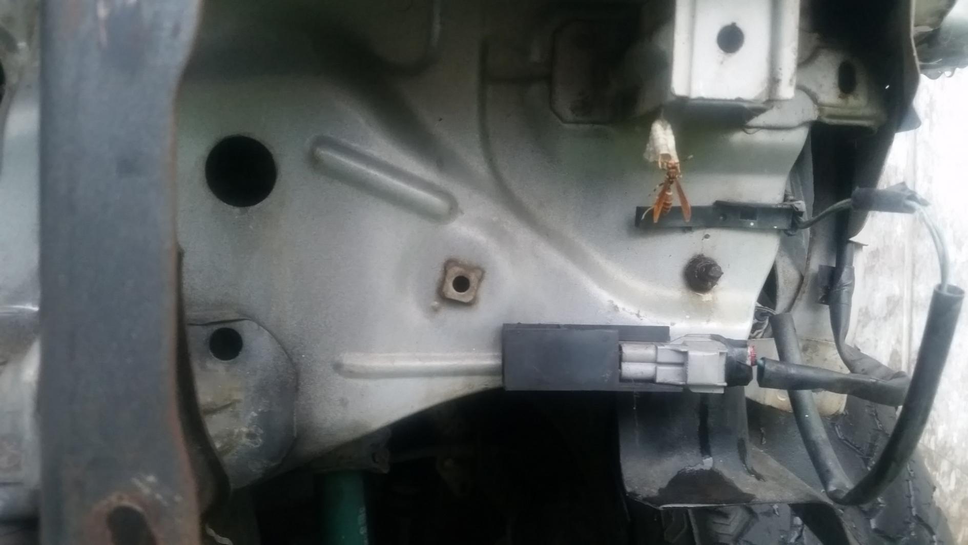

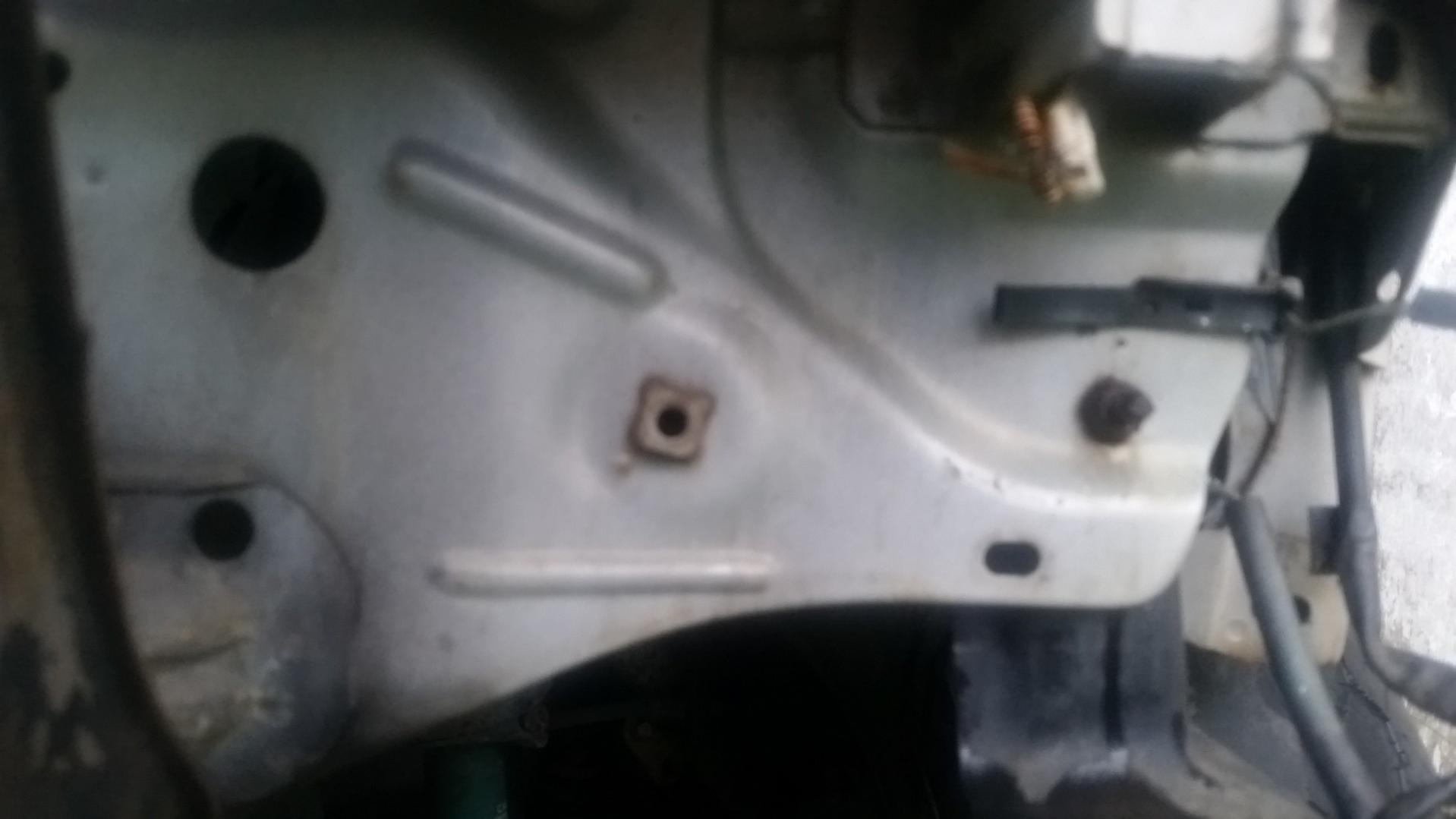

Why not use the factory location? There is even a cut out in the body that accepts the tab on the OEM sensor. It's forward of the drivers wheel well and sits between body and bumper. My front end is in pieces so can take a pic if you want. I've never had the temp above the mid to late 30's here in the scorchiest days in Nassau.

I'm not familiar with any OEM location for temp sensors on 3rd Gens?

The Limiteds (probably '99+ only, since yours is also a Limited...) have an outside temp sensor as part of the auto-AC system. The SR5's have the connector there, unused, so I used that wiring for the JDM field monitor. It even uses the same connector with different keying up front. Here it is, plugged in. I put it just above where I'm holding it in the pic:
I experimented with it here, but I don't remember why I put it back in front of the wheel well.
You want it protected as much as possible from the sun, the ground and in the radiator air inlet airstream, generally.

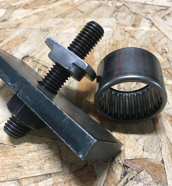

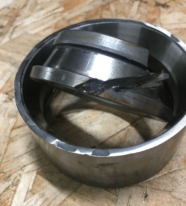

Wanted to thank [MENTION=405460]2TH4IST[/MENTION] for his help with the ECGS bushing installation - the removal tool makes it all too easy!
The wheel bearing however, took a little more persuasion...not sure if I did it wrong, but the bearing wouldn't let
go of the hub and also pushed through the snap-ring. Bit ugly, but got everything buttoned up and went for a test drive
that got me closer to the local fires than I expected. Made a safe retreat, but stay safe and aware out there!
