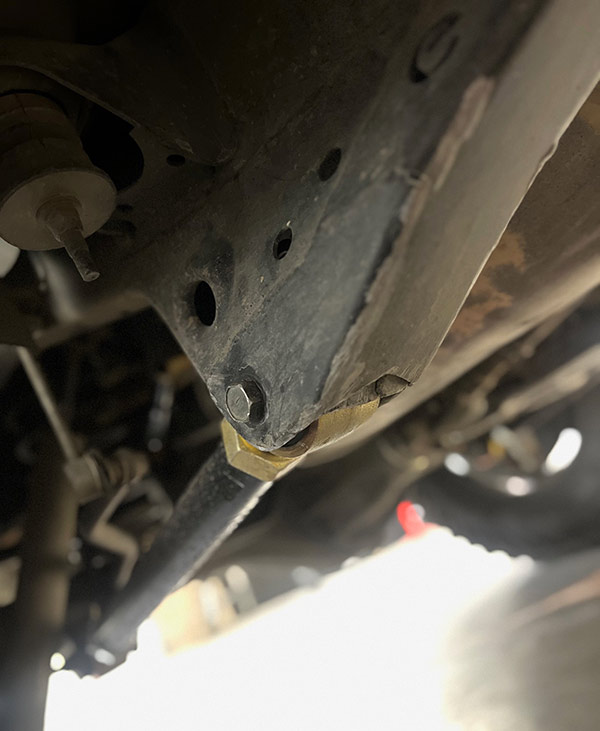

and make the axle squirm around. I am a little concerned that the nuts
on the lowers may get dinged/moved on rocks, but only time will tell.

[MENTION=93300]GhostRing[/MENTION] Beyond super fancy, like pinky out fancy.
Use tamper proof torque paint. Get everything set to where you want and tighten, clean a spot on the arm and nut (where it wont get hit). Then apply the paint. If nut or arm moves the paint breaks.
This is the best stuff I have used, it's burn your retina orange.
https://a.co/d/88CT6EN
Nice!
There's yellow paint pen lines all over the inside of the arms
but I bet can make that fancier too! My old arms have some
pretty decent abrasions on them - I've even toyed with the idea
of making mini skidplates for the jamnuts. I'll keep you informed
if I come up with something stupid enough...
