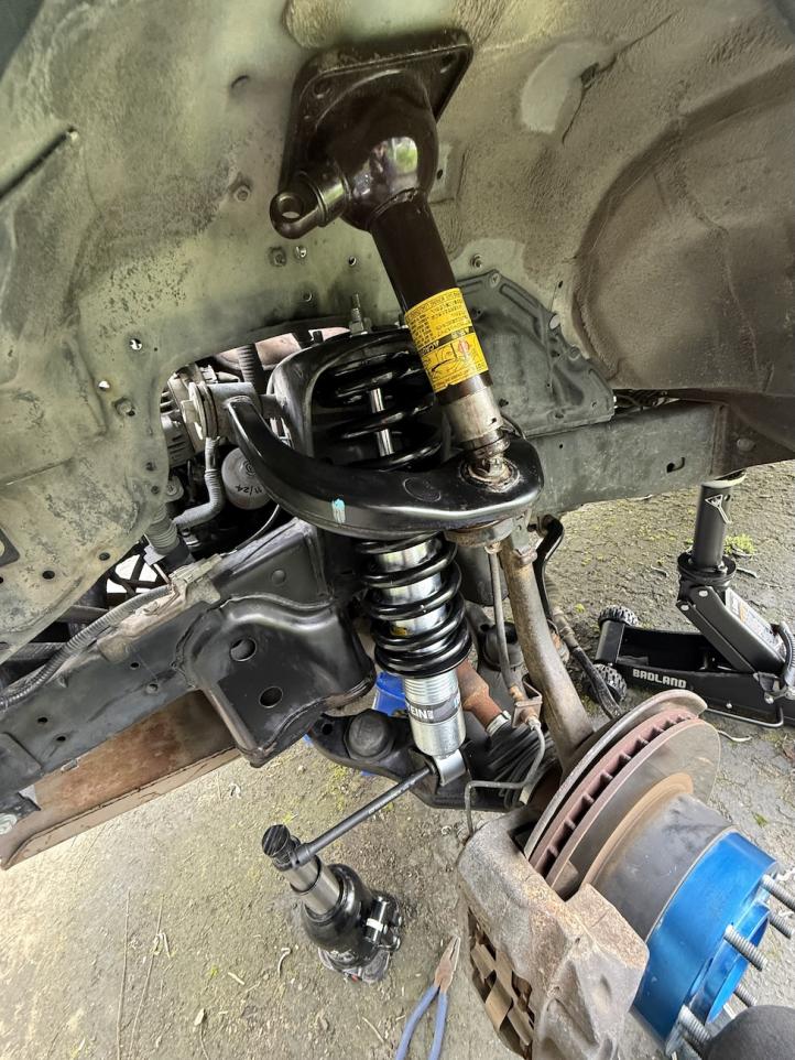

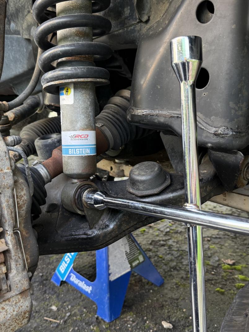

It was time for a pair of front shocks
Took me way too long (fists of ham) but I got these on. Forgot the battery to my impact AND a 1/2" drive 19mm socket ( RE: the tire iron). Out with the 5100s, in with the 6112s.

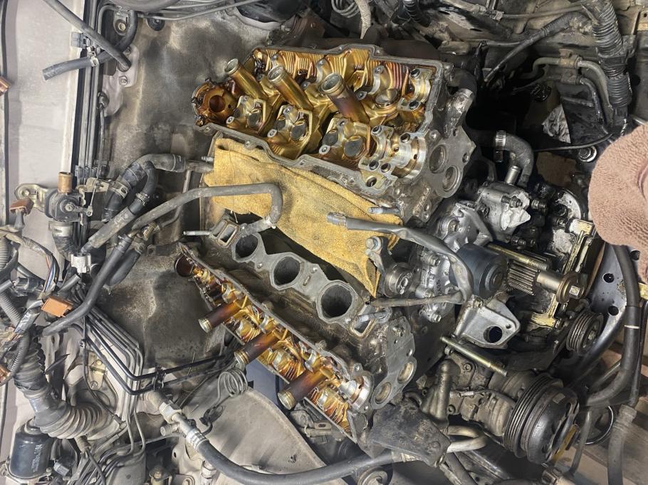

new to me 2000 SR5 head gaskets
Just getting down into the weeds with this sweet little 4 runner.

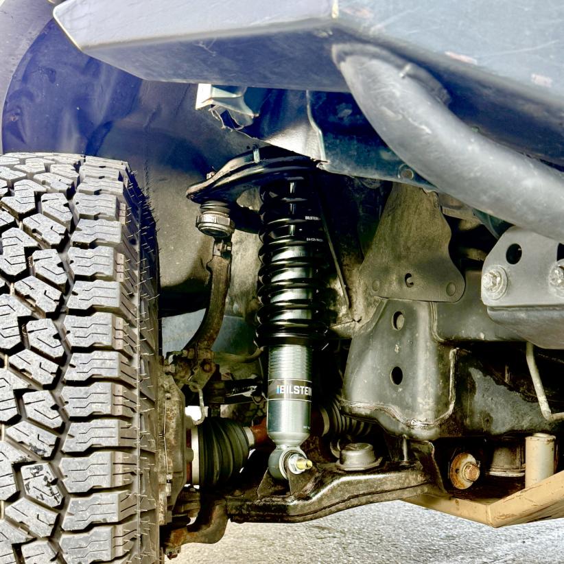

2000 SR5 4WD, auto, non locker, 265/70R16, 148K.
Needed suspension upgrade. Got a kit with 5100's, 880 front/906 rear.
For the rear, new rear upper and lower control arms, panhard bar bushings, and sway bar end links.
The front was just going to get the loaded struts until I can get the balance of suspensions parts (UCA, LCA, LBJ, UBJ, inner/outer tie rods, etc).
Anyway, the rear parts went in, with some issues, but everything went in. Got about 2.5" of lift on the rear. Did that on Saturday.
