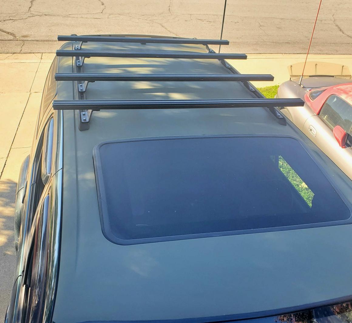

Sanded and painted the roof. Flat deep army green, or OD green. Was going to use a paint roller, but the pint I bought was not OD green, so just rattlecanned the roof. Came out pretty good. Now no more peeling clear coat. Got to paint the roof rack rails tomorrow and get the new roof racks on.
Then I need to decide if I want to paint the fender flares od green or black? Got to do the mirrors too.
Next up is to install the opt offroad rear link set.
Got the roof rails painted and reinstalled. Almost forgot to put the rack bolt slider things in, dohhh.

Cleaned up and made dinner. Racks should be on tomorrow, after the silicon (bolts/bolt holes) dries.

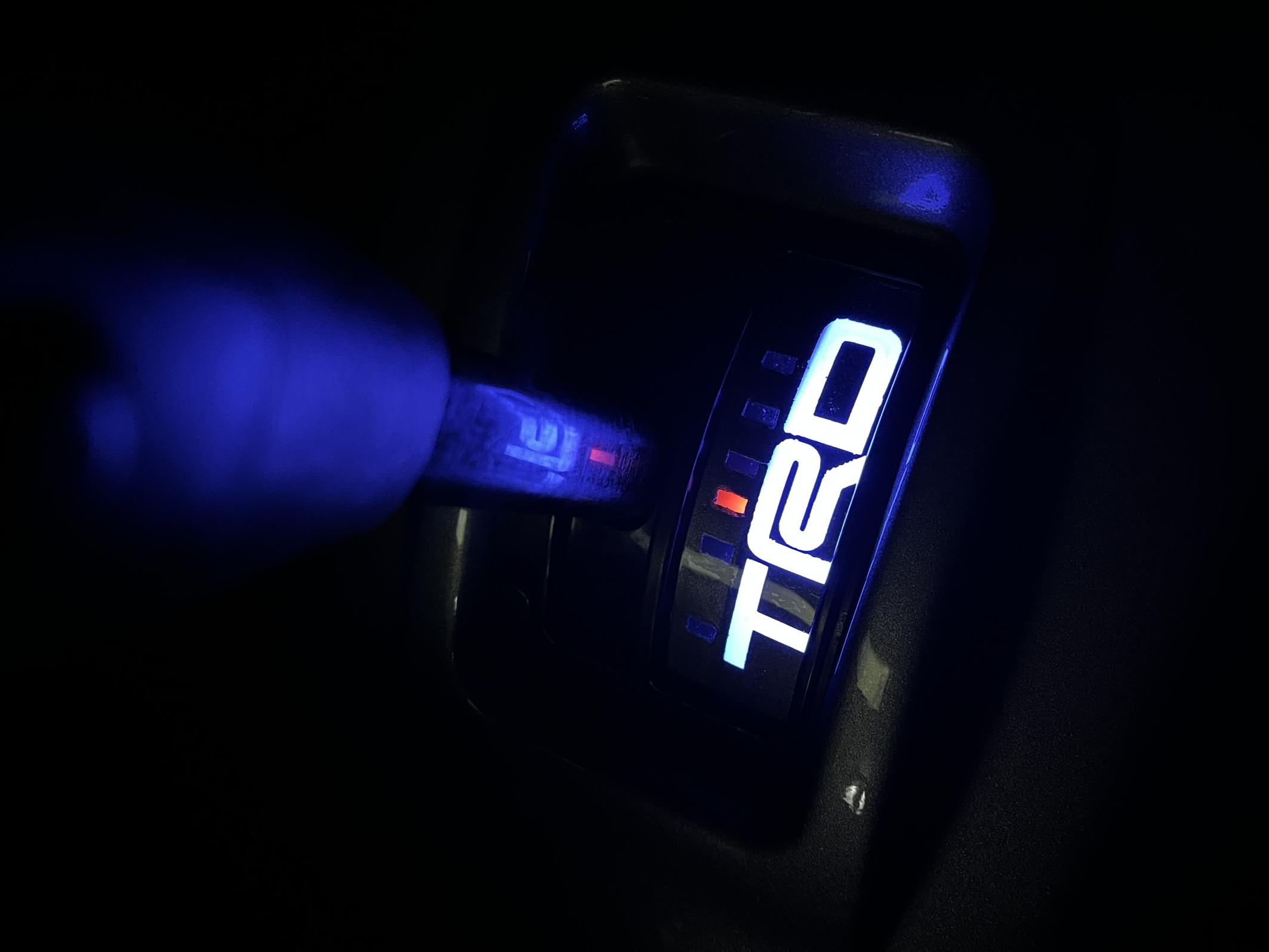

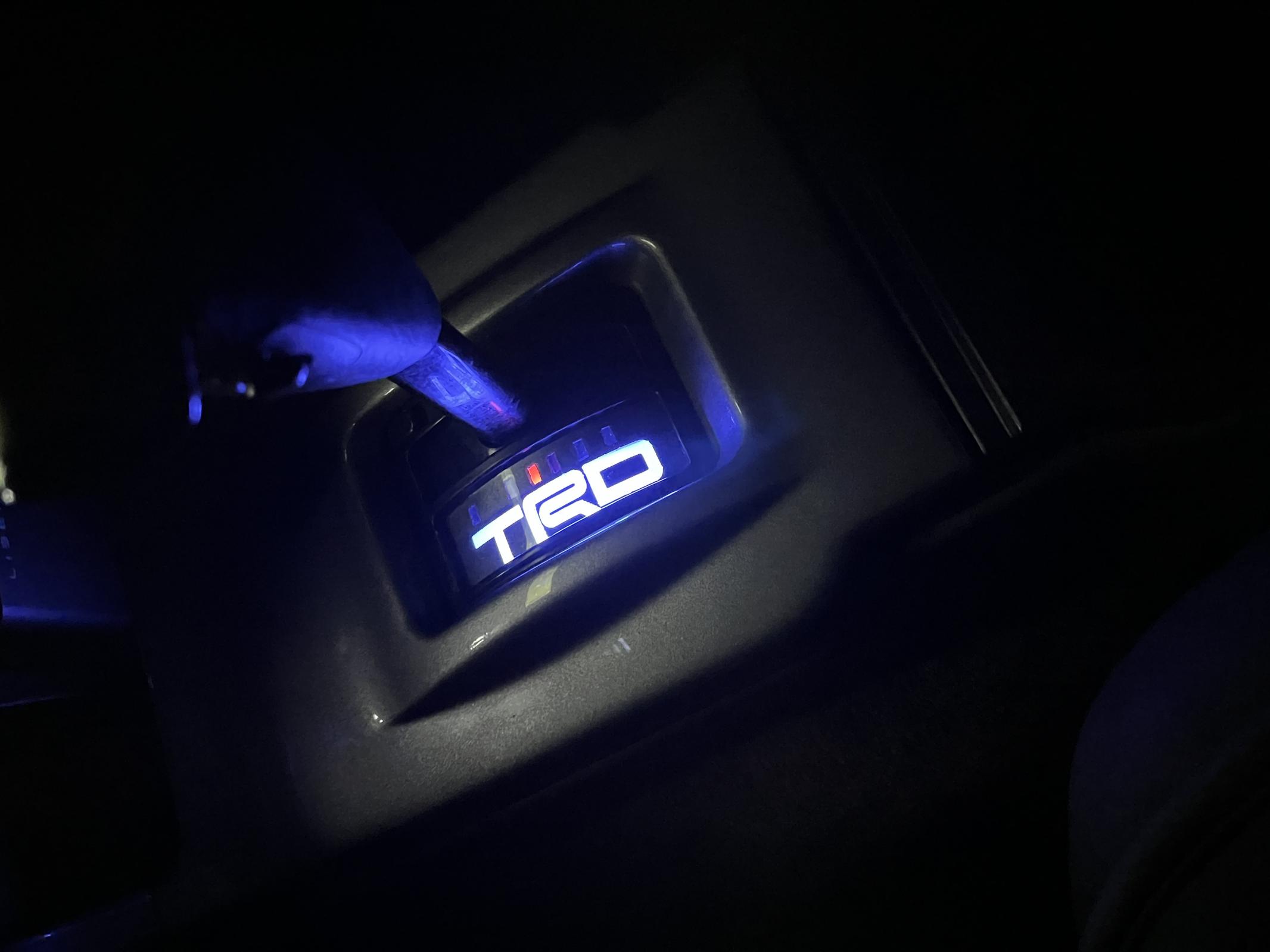

Shift indicator mod
My factory indicator finally cracked enough to where it had to be replaced. I had an idea and came up with this. Im satisfied with it, what do you think?

[MENTION=796679]NotSonyaChin[/MENTION] that looks pretty slick! It looks really bright through.
Today I put in the new drivers seat belt. That odd smell was coming from the airbag side of the seat belt. Strange. Also got the roof racks installed. Looks sweet and is nice and rigid.
