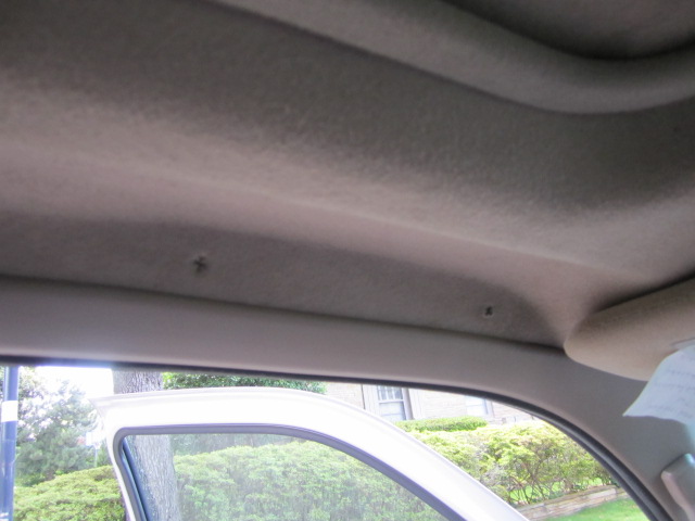

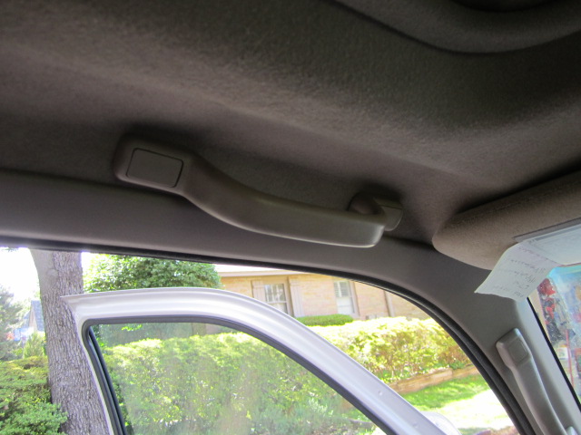

Took advantage of the factory holes hidden by the headliner and installed a 2nd grip handle on the driver side.

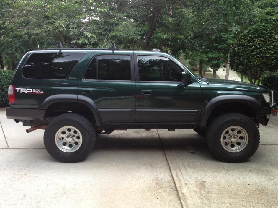

Finally lifted it
I've been staring at the Tundra/Bilstein 5100 shocks and 8 wrap LC coils I bought a while ago. They've been sitting on my bench at the shop just taunting me for weeks, laughing at me, knowing that I haven't had any time to install them. Well, today was the day. In 2.5 hours I pulled the stock front shocks off, disassembled them, put the top hat on the Tundra coils/Bilstein 5100's, put the clip at the 3rd notch from the bottom, assembled, slapped them on the truck, yanked out the stock rear shocks and coils (upper shock mounts were a lot of fun) and wedged in the 8 wraps and Tundra Bilstein 5100's. I also removed both front and rear sway bars. I'm not 100% sure I'll leave them off, the sway is pretty bad on the road. All I have to say is that the ride is sooo much better with this combo. I guess my stock springs and shocks with 265k miles were more clapped out than I first thought. Now I need an alignment and some larger tires!

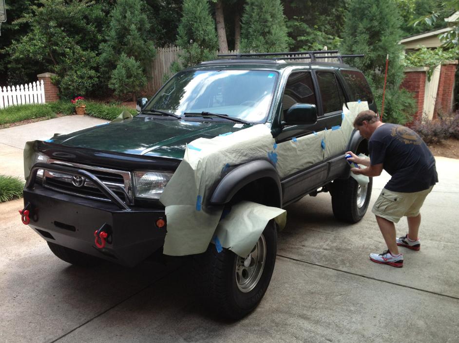

Plasti-dipped the fenders and rocker panels! Love how it turned out with the new bumpers
all runners have the factory holes? I had no idea... I would like to do that too but I have a big noggin... you know what comes after that..
nice upgrade thanks for sharing.
