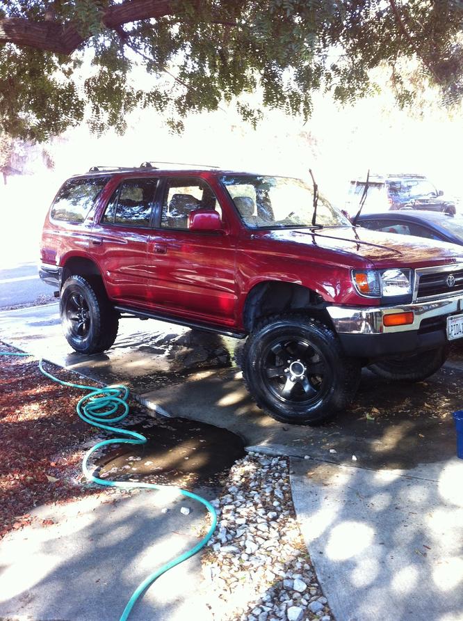

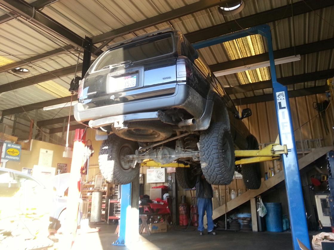

Installed 3in lift. Found out that previous owner must have lived where they salt the roads in the winter. Nothing wanted to come apart correctly.
