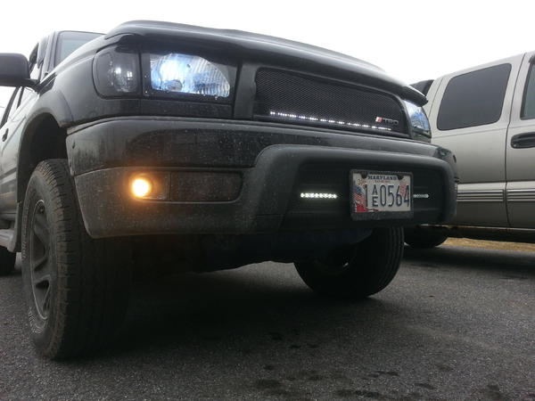

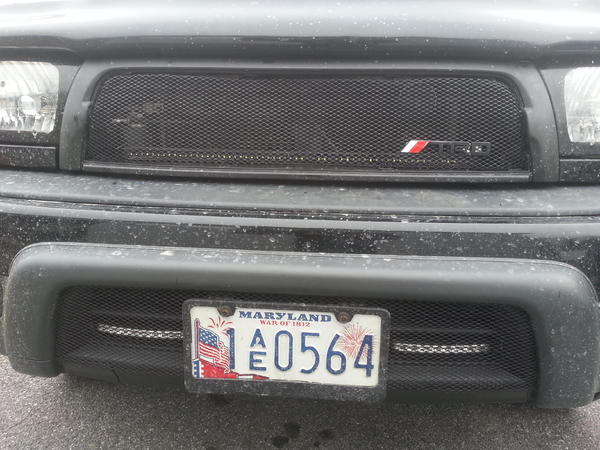

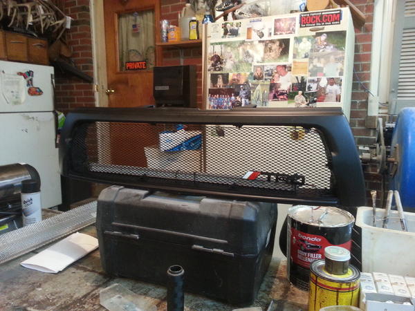

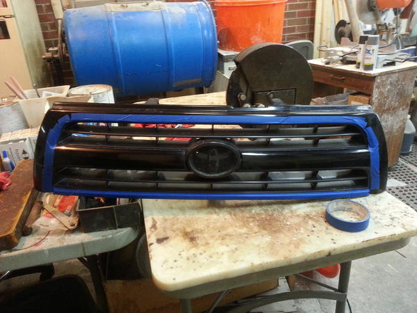

Got my Satoshi Mod just about done!!
Long time Lurker here, but i figured today i would throw some pictures up and get involved on here!!! i had the annoying grille with the big black bar thats molded into the middle of the thing,
so i need to do a little more shaving on it to get a little bit of the hump still showing out.
But other than that go it intstalled lower valence grille mesh installed and LED bar tinted so its not so noticeable.

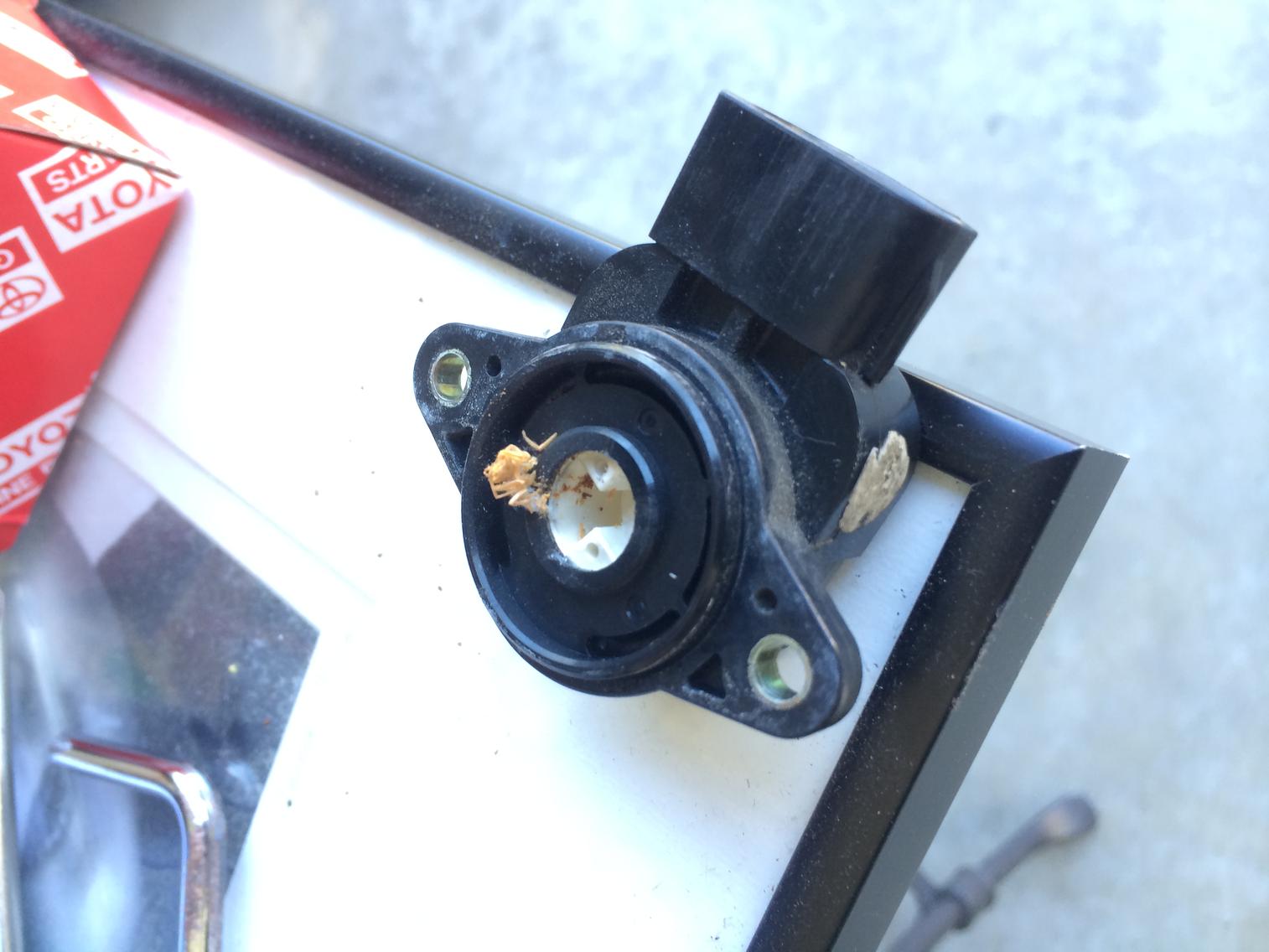

TCS Replacement encouragement!
After encountering: decreased gas milage, check engine light and rough idling, I OBII checked and got a P0120 indicating a Throttle Position Sensor replacement. After receiving my new OEM sensor and unscrewing the two screws on the old piece (which was a pain in the Ass on my 2.7), I uncovered that a SPIDER had somehow gotten in the sensor and then died. How a Spider got in the sensor I have no clue, but the fact that a runner could still perform is pretty miraculous. New sensor in, idling is lower and steady as a rock, 180k miles and still strong.
Toyo-Power my friends.

Great to see you over here! You'll definitely find tons of useful information on this forum (and you might catch the mod bug too). Good to hear you got the check engine light sorted out! I hate spiders...
