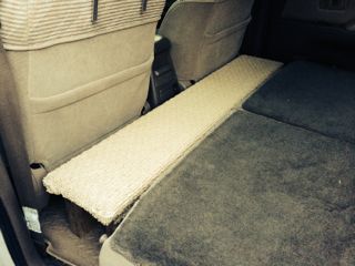

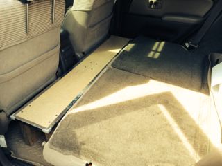

pillow rest, for camping

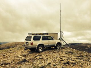

twin cones, kenosha pass, only mod is no sway bars.

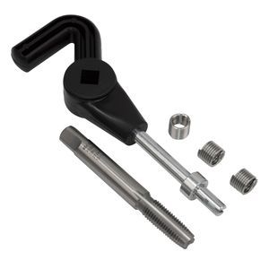

Thread repair insert. Heli-Coil.
How did you go about repairing the threads? Did you follow a write up?
last year I followed a suggestion to re-tap the threads for nominally larger metric m8- 1.25 x 25mm bolts. Toyota 4Runner Skid Plate Bolts. This has worked well. I kind of screwed up (ha ha, get it, threads, bolts, screwed up?) two of the holes because I wasn't patient. I should have cut the new threads slower and backed the tap out much more frequently than I did, especially when i encountered resistance. I don't have cutting oil any and didn't want to buy it. I used gear oil (75/90), motor oil, or WD40.
Recently I chased (ran the tap through) all 9 of the holes. This did clean up all but the 2 holes I had initially screwed up so I went ahead and repaired these.
I bought an M8 - 1.25 thread repair kit from an auto parts store.
Follow directions. Drill out existing threads with the proper size drill bit, in this case 8.3 mm. Yes, they exist but I didn't want to pay for or hunt down one. Closest standard size is 21/64ths = 8.33 mm. I used 5/16ths (20/64ths, 1/64 less) = 7.93 mm.
Slowly run the tap through, cutting/backing off/cutting/backing off. Clean out hole - compressed air, q-tip - chase threads, clean hole, chase threads, clean hole. Screw in the thread insert, break off tang, good to go. I was patient and slow this time. Very slow.
They are thread repair inserts, often referred to by the brand name Heli-Coil just as cotton swabs are referred to as Q-tips.
