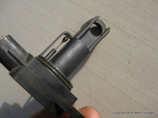

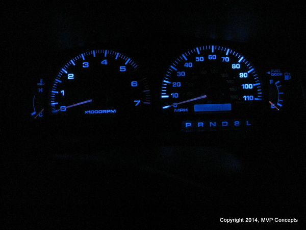

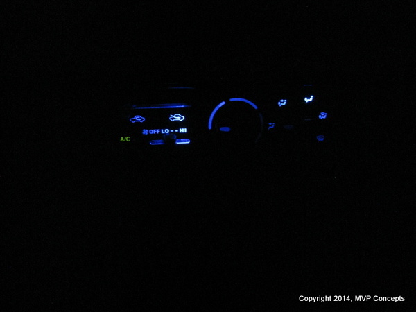

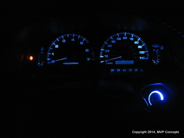

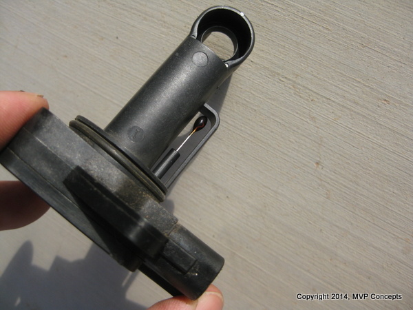

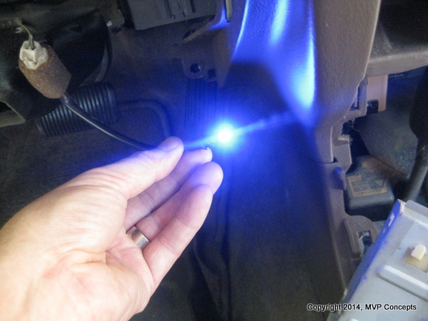

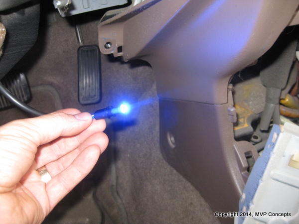

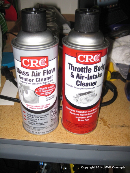

Worked on the 2000 SR5 Sport 4WD today:
1. LED dash light upgrade
2. Cleaned MAF
3. Cleaned Throttle Body
Throttle response is so much improved, it is hard to believe that it is same truck!

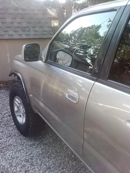

Window seals and the little mini fender flares were looking 100 years old, so I washed the truck and did a couple coats of armor-all... seems temporary, but a lot better
Also ordered some 20% window film for the front windows and some cheap black Dickies seat covers today... see how they hold up

I think ya just cleaned the air temp sensor; in order to clean the MAF look down the MAF housing tube and you will see two little filaments, similar to what is seen in an incandescent light bulb. A couple of shots with the CRC cleaner, give it a couple of minutes to dry, then reinstall.
As noted in other posts in the past, the factory screws are JIS FYI......

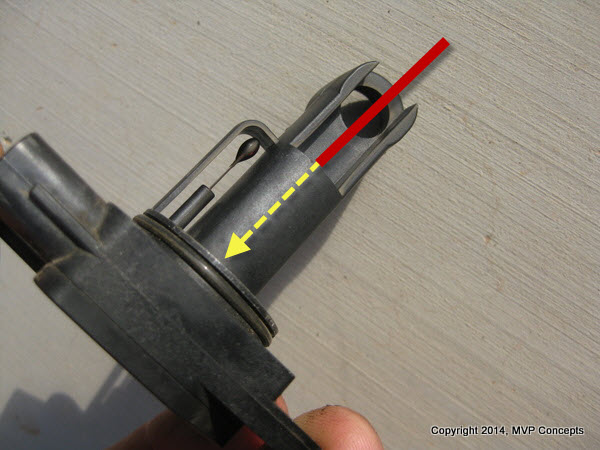

Well ain't that cool, I cleaned the MAF and the air temp sensor... seriously did not know what that thing was but cleaned it anyhow.
I stuck the nozzle near the tube and shot down into the hole real good a number of times. Was a bit messy but seemed to help Betty run a lot better than before.
Here's a photo of what I did. Action shot not available as the lighting was a pain and I only have so many hands. If I messed something up, let me know...

Nope, you are good to go. I was on the fence if you had done such or not, but my plane was boarding at the time so I ran out of time to ask.:party:
Next time grab a small light and you can see the filaments (wires) down there. IMHO it is good maintenance to clean the MAF every 30,000 miles or so. :bigok:

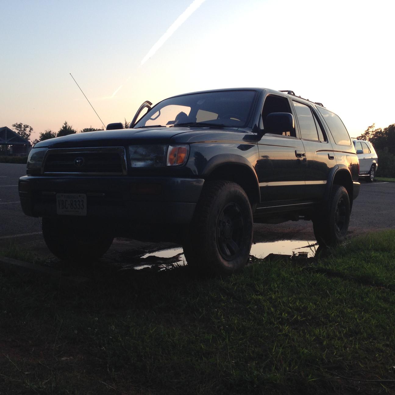

I did a few things to duke today I paint the rims took 1 running board off the other side had some sized up nuts and bolts. So tomorrow at work im taking fire to it. And I put instaaled some leds inside. non 4runner related] took my lil bro fishing and he got his 1st fish
Forgot to add pictures

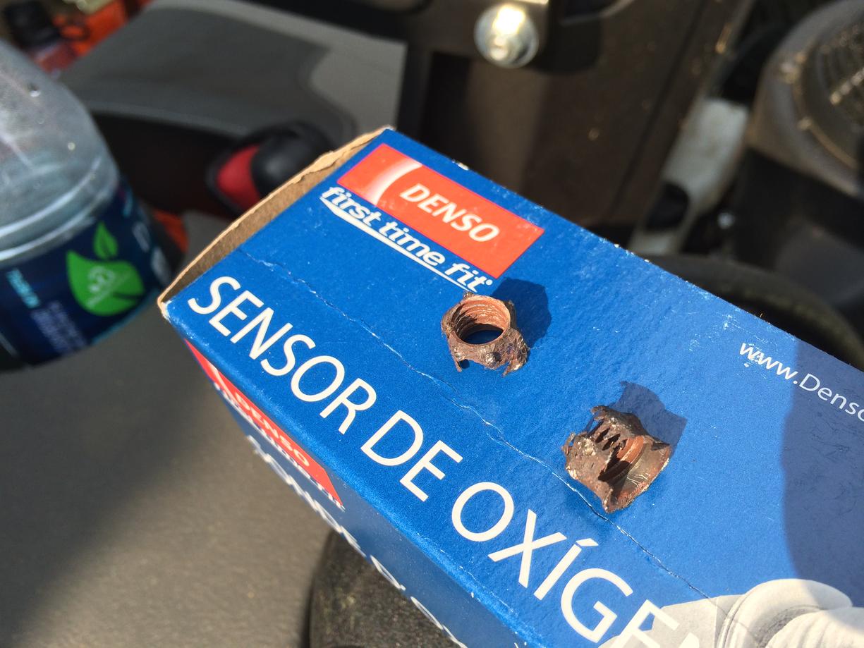

Replaced rear O2 sensor and wow what a job!! should have taken like 5 min but the nuts were so rusty .....WOW Only advise i have for others that may have to replace it is lots of PB blaster and vice grips. And patience :lookout:
