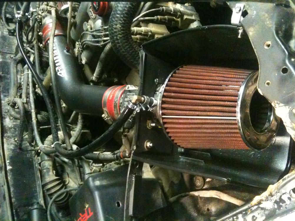

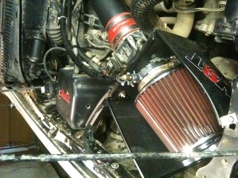

air filter box build
we've been getting just a shit ton of snow here in wyo/ colorado so i got bored and spent a little time tinkering in the shop today and rebuilt a mud,snow, and dust shield for my air filter used a square bucket and heat resistant paint. looks pretty good for what used to be a tidy cats bucket lol really easy mod to do as-well.

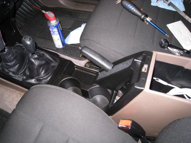

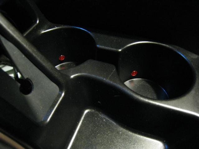

Mostly finished my 99 cupholder conversion:
Included lights down in the cupholders--I can't remember who I got this idea from, I lost all of my notes a few months ago and don't have the link anymore. They're tapped off of the illumination wire for the rear window switch, so they turn on and dim correctly:

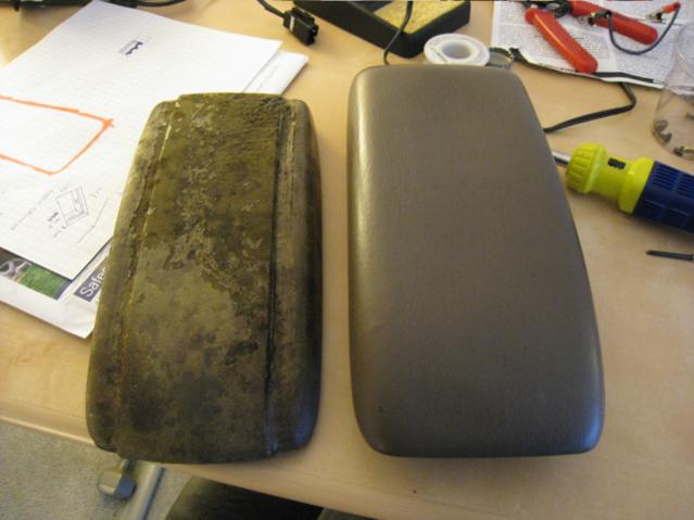

Ended up using the lid from my old 98 console, since the one I got was trashed and I didn't think I wanted to reupholster it after I looked at the foam underneath. Turns out you can use the 98 lid with pretty minor cutting and adding a new screw or two. Nasty foam on the left, old-new lid on the right:
I'm 3D printing a front panel with switch blanks so that I can keep my window switch there. It will replace the pocket on the front. I'll post a shapeways link once I get it refined (I'm sure it'll take an iteration or two to get it right.)

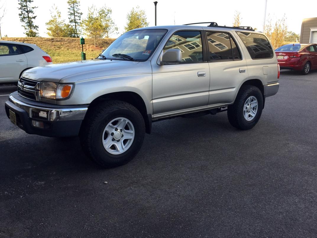

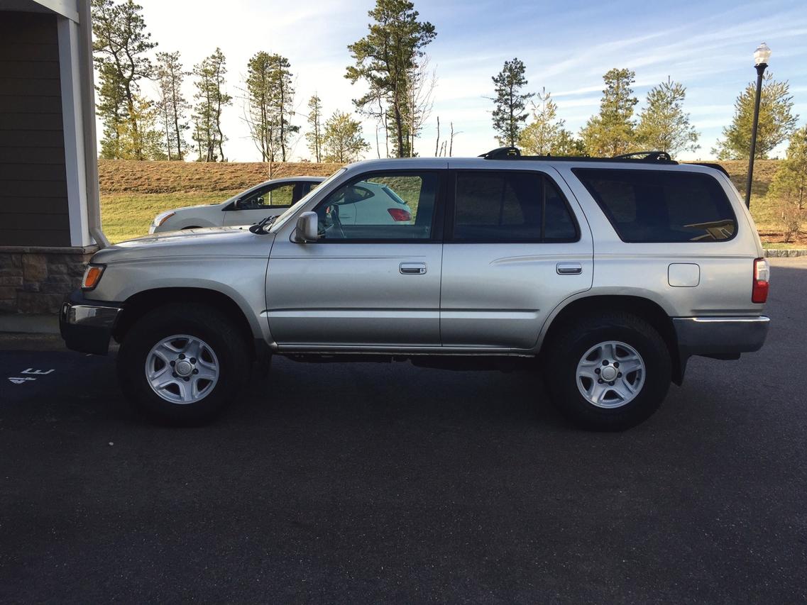

running boards off, front mud flaps on, 16 5spokes with 265/75 Cooper Discoveries...soon stickers to make it go faster...
so the 99 highlander coils really only do about 1"? thinking that and maybe level kit versus a serious lift...no rubbing with these tires btw...

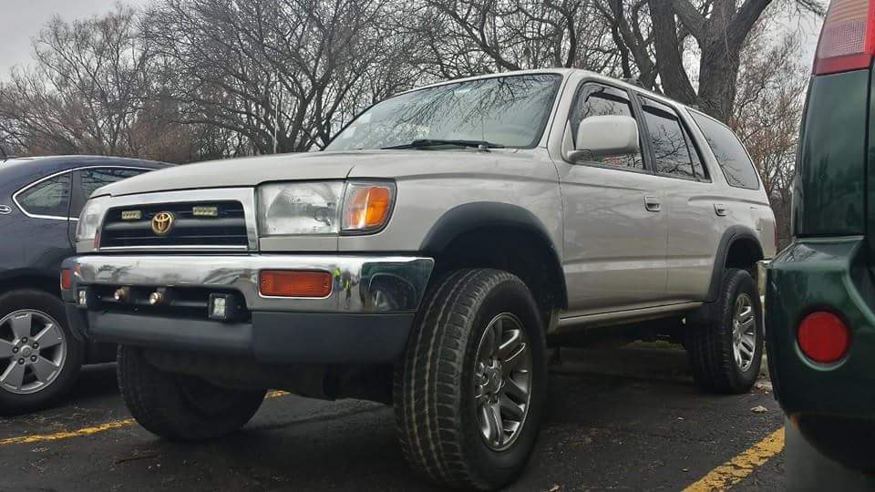

Are those Savage, All-Pro or Stubb's Sliders? Or none of the above?
They are a set of Rocktek sliders for an FJ Cruiser. The length was perfect I just had to cut off one of the 4 legs since it landed right where the body mount was. The leg I had to cut off was one of the inner legs and didn't make a difference.
