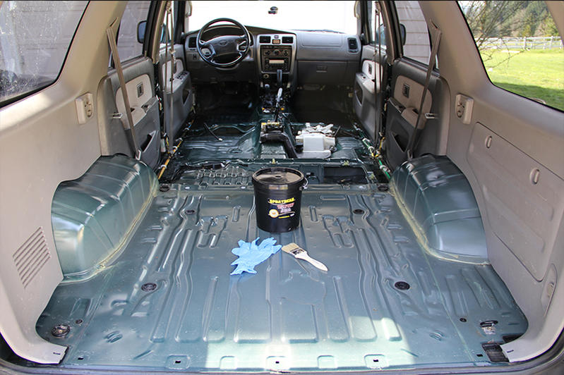

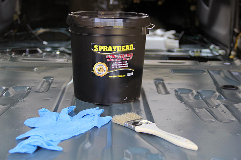

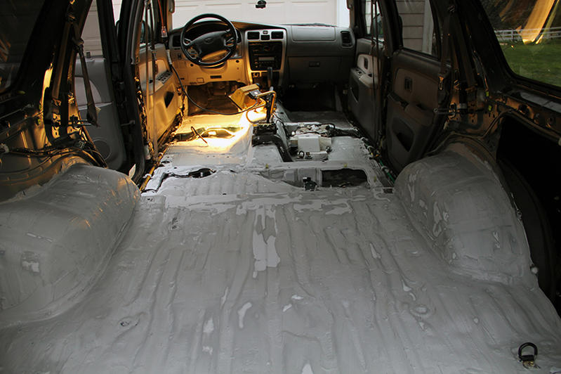

Next Project: Began my installation of the sound deadener and new carpet. Putting down the first two gallons of "SprayDead" followed by Fat Mat Rattle Trap xtreme 80ml. Hated to paint over that beautiful paint after 13 years. the inside looks brand new of a 2001. The joys of being the original owner.

would you consider making a dedicated thread for your sound proofing project?
there are already a few in the tutorial and documentation v2 thread but your does appear to be different.
that looks interesting.
Sure, let's see how it turns out first! I'll document and take a bunch of photos for everyone...cost, time etc... Wish i joined the forum many years ago.

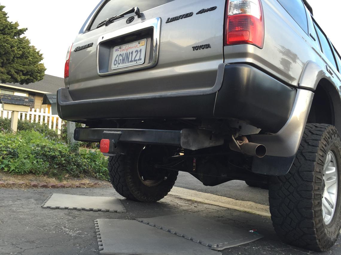

Bumper removal/installation
Swapper bumpers... from thundercloud to ARB black. thanks to [MENTION=82223]mud dawg[/MENTION]

Nice job, though I wish you could have spent another $50 for some 6ton Torin jack stands to make yourself a little safer.:juggle:
those blocks are holding up only one side. 3 tires still on the ground, though not seen in the photo.
Not trying to pick or anything, but you should really have a jackstand under that side as well. Just because it is still on three wheels doesn't mean it can't fall to the side the wheel is not on...
