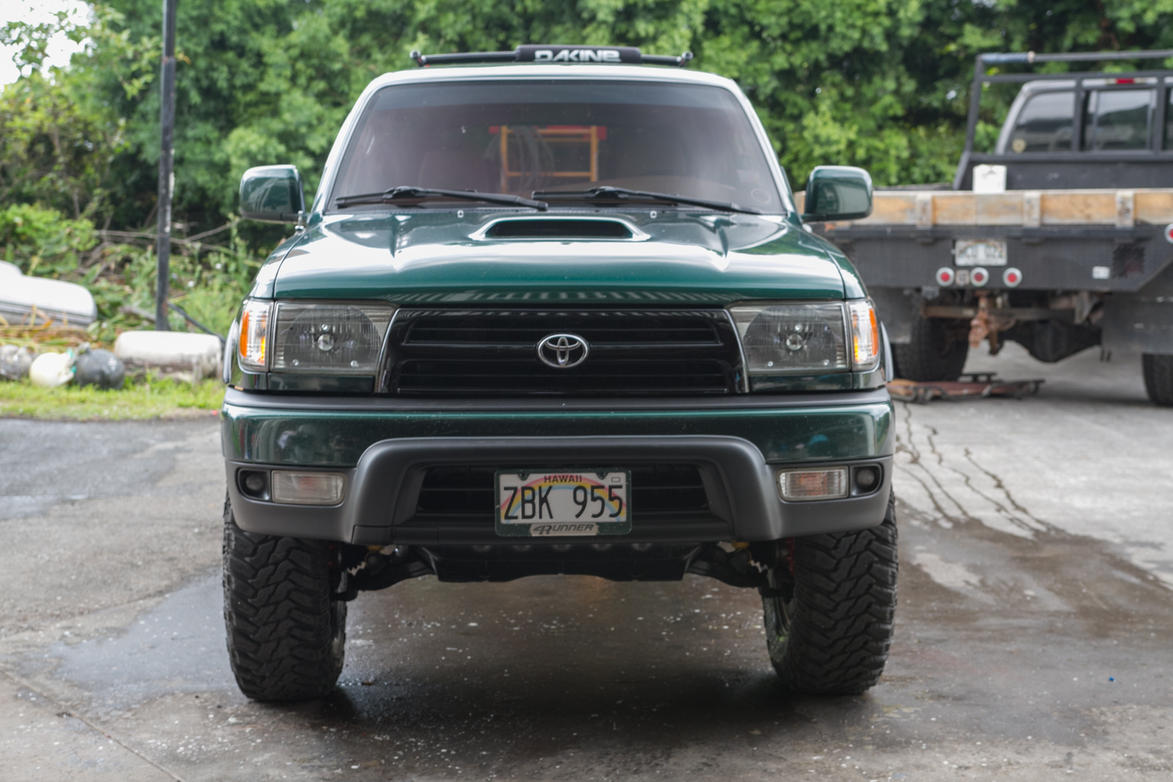

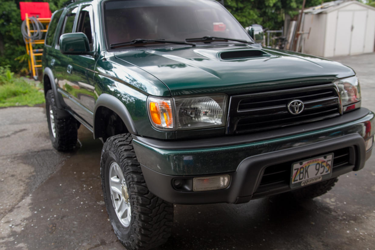

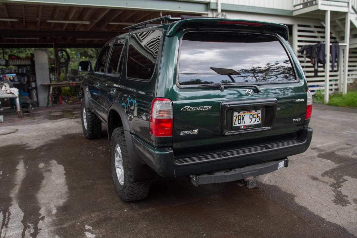

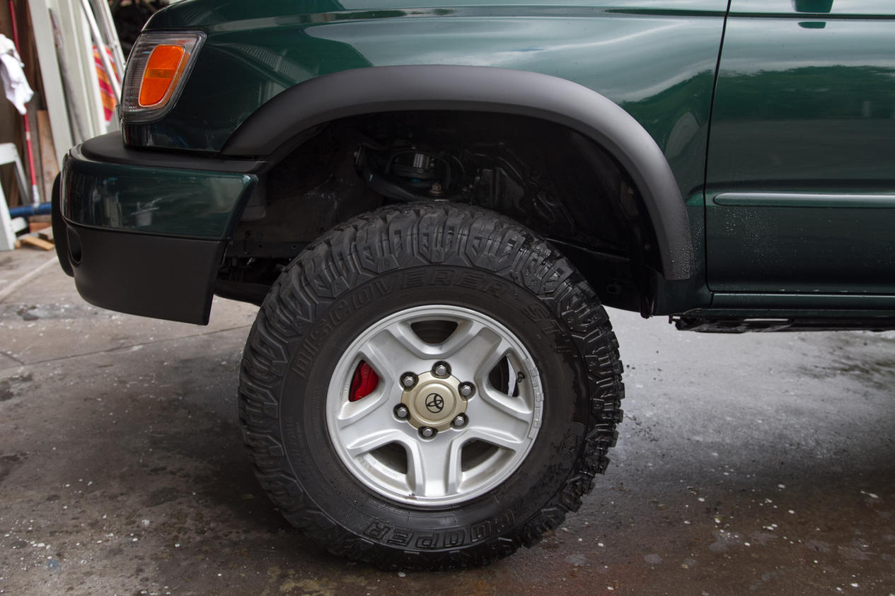

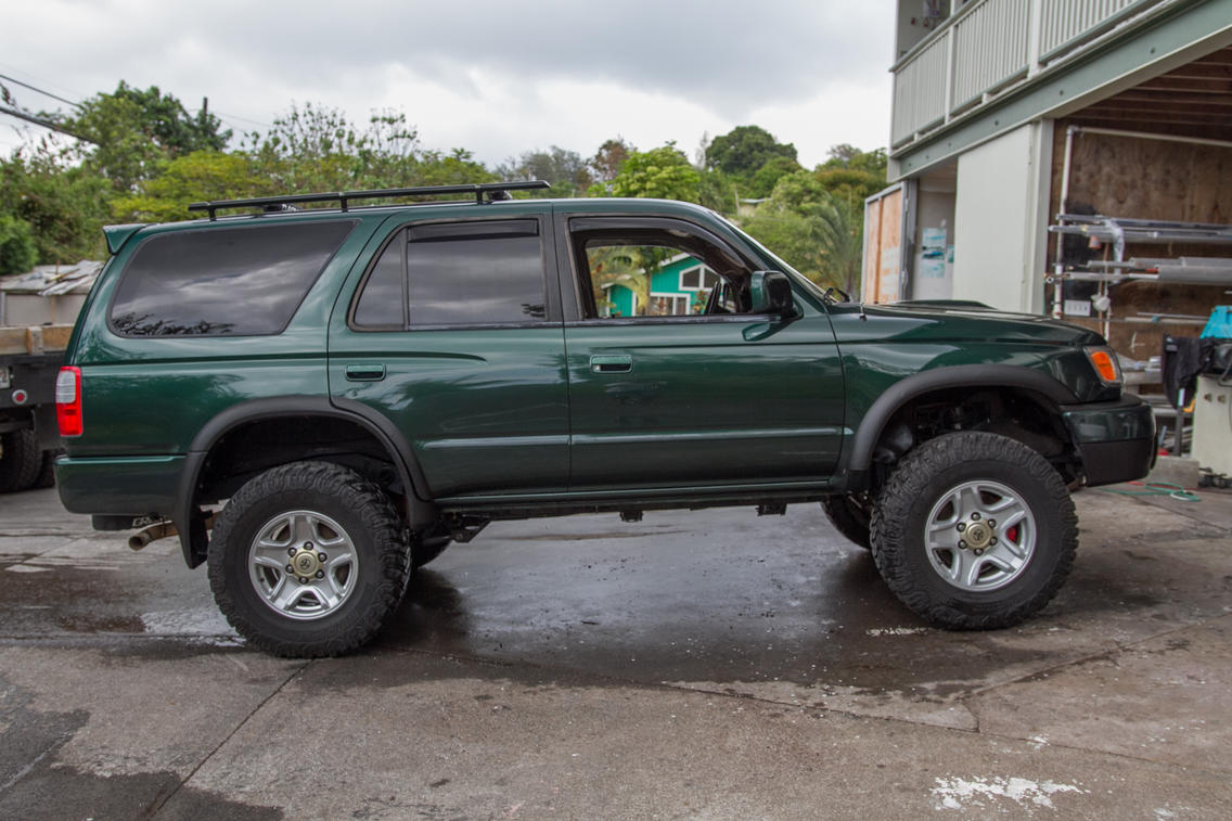

Over the past week got a couple things done:
Painted all the trim and bumper valences with black trim paint
Painted the skid plate, rear license plate panel
Replaced brake pads/shoes painted the calipers red
Removed running boards
painted rust preventative paint under the whole front end
Here are a couple pics, haven't posted pics of her in a while

Gude lookin truck bradda! All jelly.
