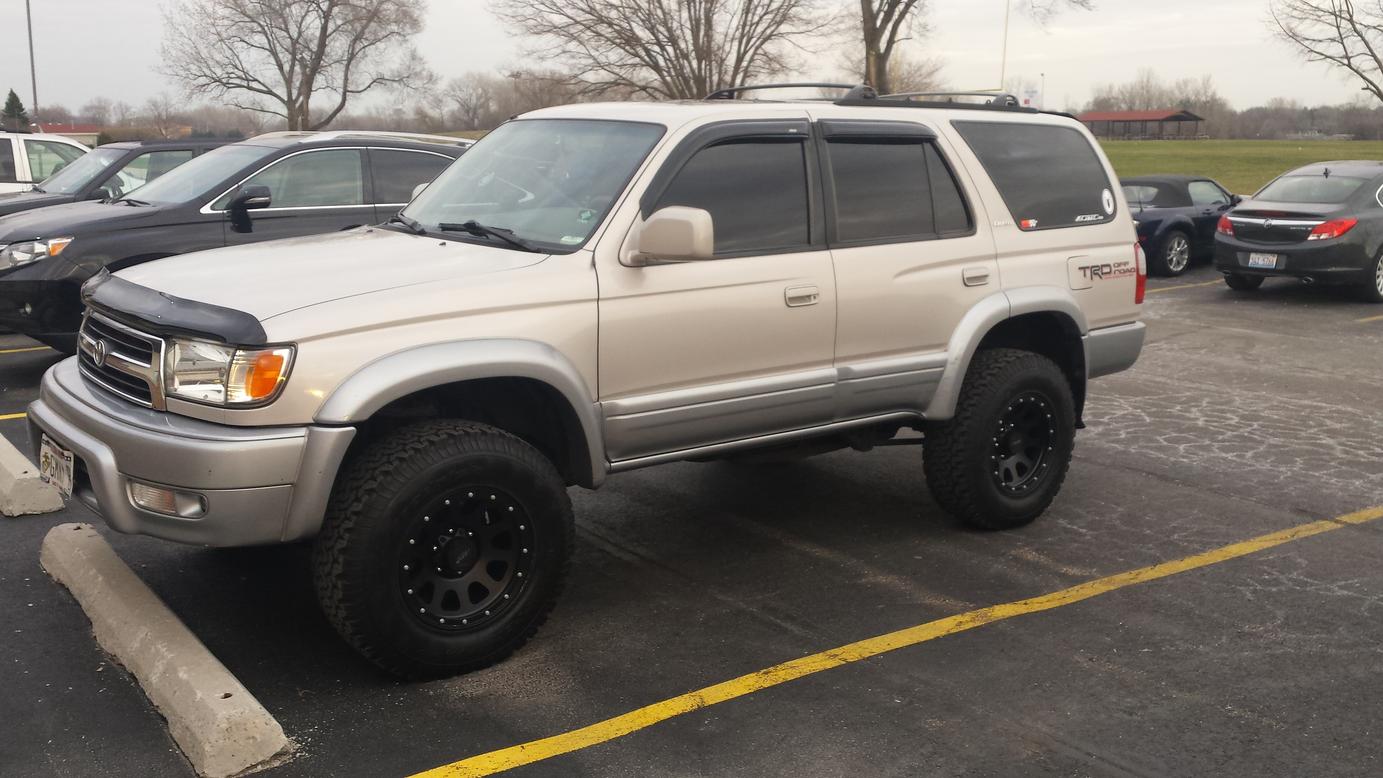

Well, I've been busy with the T4R the last couple days. Painted sliders, got the lift on, alignment, 285 75 16 duratracs mounted on 80 series LC wheels (no spacers. They barely clear the 231mm tundra brakes). Oh, and hit 220k miles!
Here's a little photo timeline:
stock height and stock tire size when I bought it
Lifted
285/75/16 duratracs w/ 80 series LC wheels. :cheers:
Oh yeah, and hit 220k!:boxer:
What lift are Ya usin? It looks really good! I'm leaning more towards the toytec eibachs in the front and lc 8 wraps in the back and hopefully it looks around level haha.

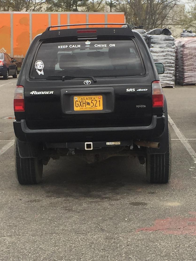

Oil change today(Mobil 1 high mileage with some Lucas Oil additive), air filter change, think I found the clunk and squeak. There was a nut missing off the passenger sway bar end link, and the drivers side was spinning freely. Got a new nut, and tightened the other one down. Hopefully that stops the clunk and squeak. Noticed this today too, anybody elses sit slightly off? Now to figure that out too....
King coilovers and the land cruiser springs. Can't remember the color codes off the top of my head though.
