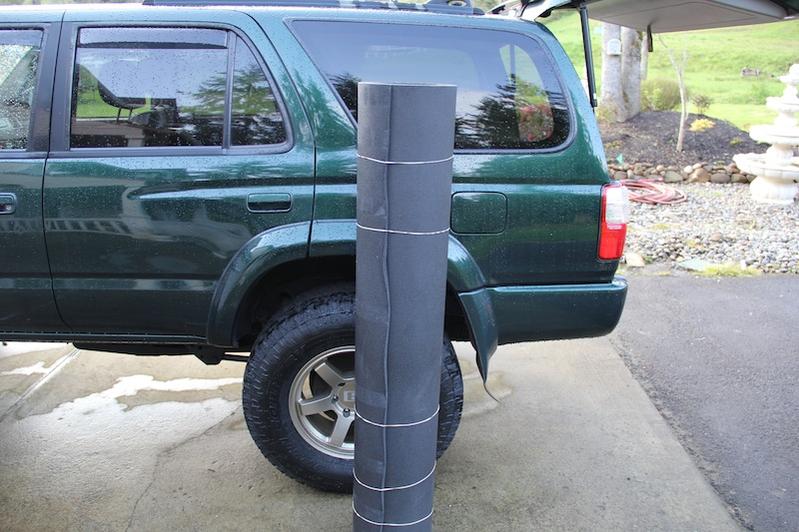

I finally got my closed cell foam in to replace most of the jute underlayment except in the cargo area.
Acoustic Insulation and Carpet
Finally put some time into my insulation project, making careful preparations for a dedicated thread on here later on this month as requested by [MENTION=65101]BrianSD_42[/MENTION]. Since I've also replaced the carpet I may combine the threads for those looking for new carpet.
The "Spray Dead" has been complete for some time along with 98% of the Fatmat 80 mil Rattle Trap Amazon.com: FatMat 50 Sq Ft x 80 mil Thick Self-Adhesive RattleTrap Sound Deadener Bulk Pack w/Install Kit: Automotive
This is 1/2 " closed cell foam

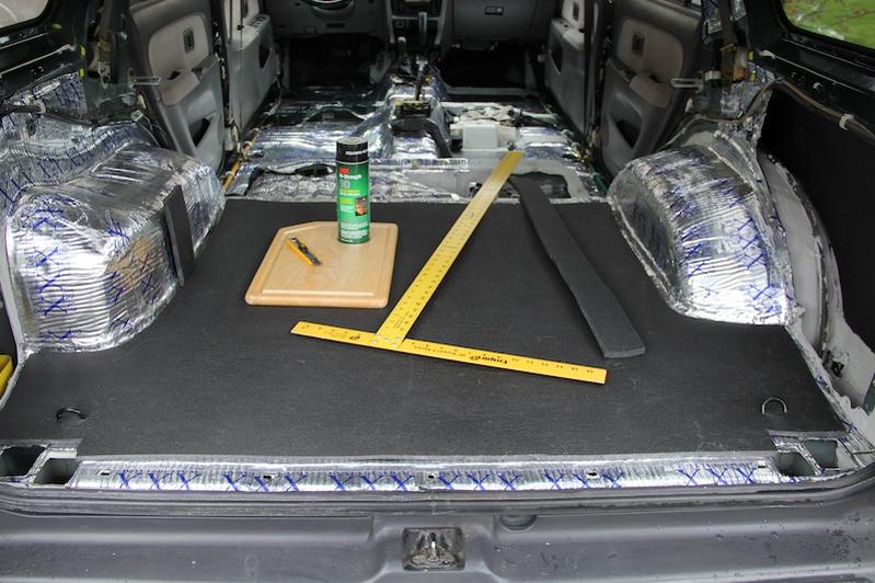

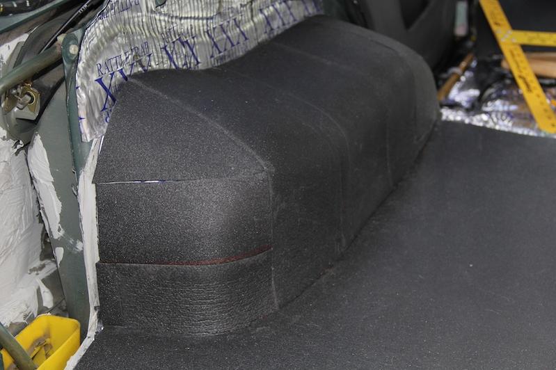

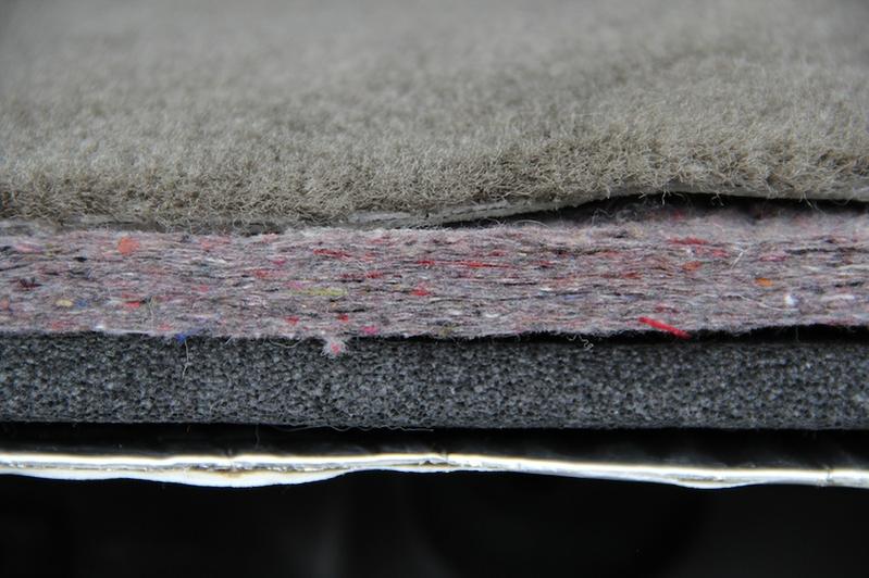

Anyone see the gap in the seam in the foam pieces on the wheel well...damn that's killing me! Anyway, meticulously cut the foam to fit and used 3M 90 spray adhesive. Here's a photo of the layers in the cargo area;
  • Spray Dead (Not shown)
  • FatMat 80 mil
  • 1/2 " Closed Cell Foam
  • Jute
  • Carpet

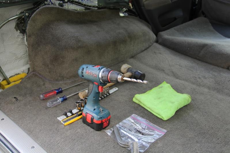

I'll save the rest for the thread but here's a few more pics of the tools I used and the carpet install:

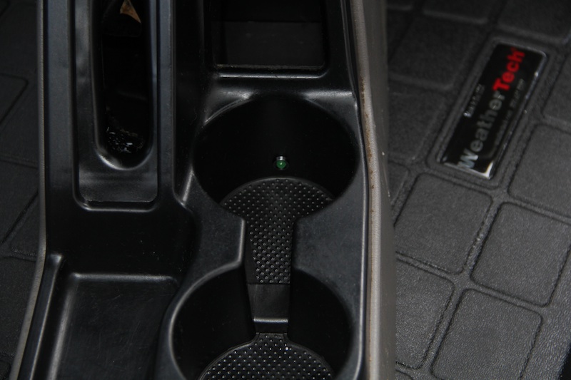

Will finish up the rest of the "small stuff" today but will leave the side panels off. I'm drawing up my schematics for a true sine wave inverter with bus bar, fuses etc and I want to do it right with minimum voltage drop, right AWG wire, perfect location, etc....

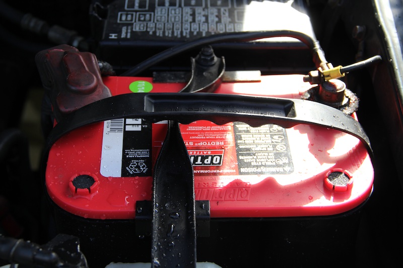

Did change out the battery and as you can see I have a few other projects to do, replacing some weather stripping and rebuilding my SC one of these days. Not in a big hurry. Oh yea, finished up the cup mod.

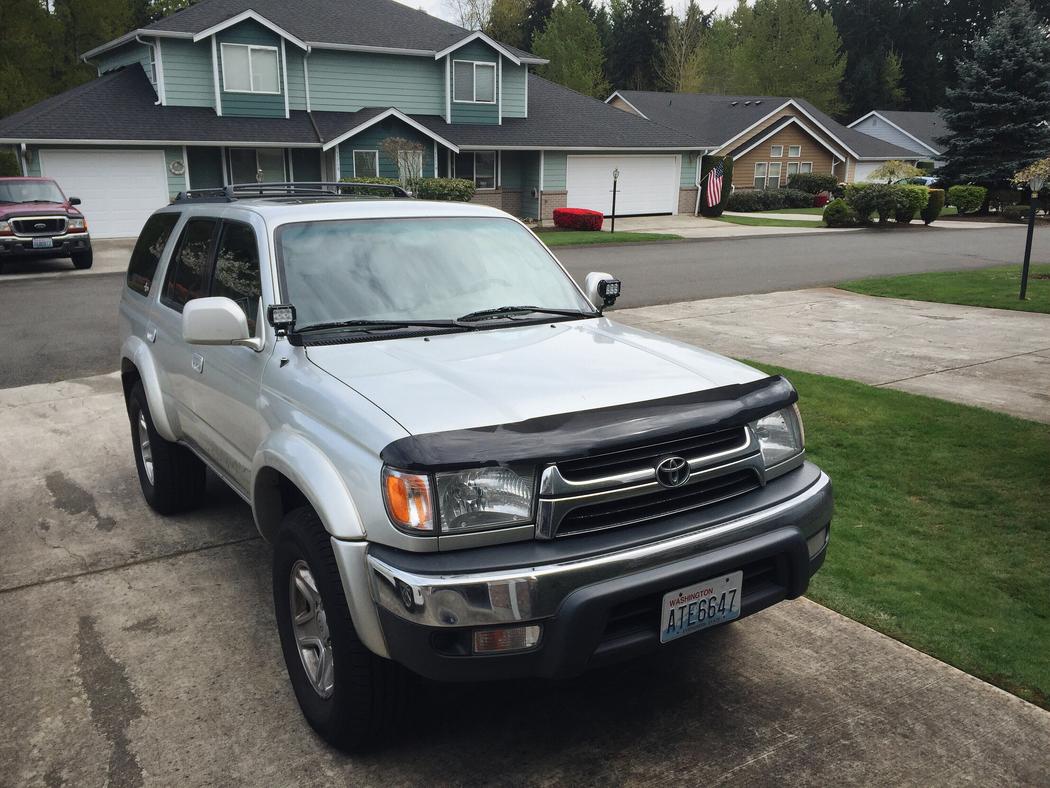

Installed new headlight bulbs, wipers & JDM Hilux Surf clear corners. Adjusted drivers side headlamp that was pointing low. Pulled grill off to change emblem from Gold to Chrome. WD 40'd all bolts that will be coming off soon. Skid Plate, running boards, LBJ's & UCA's.

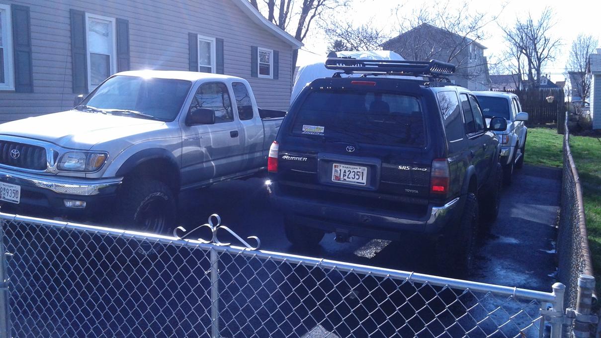

Washed my trucks today. This is the first time i had all 3 in the driveway at one time so i had to snap some pics. My neighbor told me I have too many toyotas, i replied "You can never have too many toyotas!" Lol. I'm looking for a mid to late 90's landcruiser with factory lockers to buy next.
