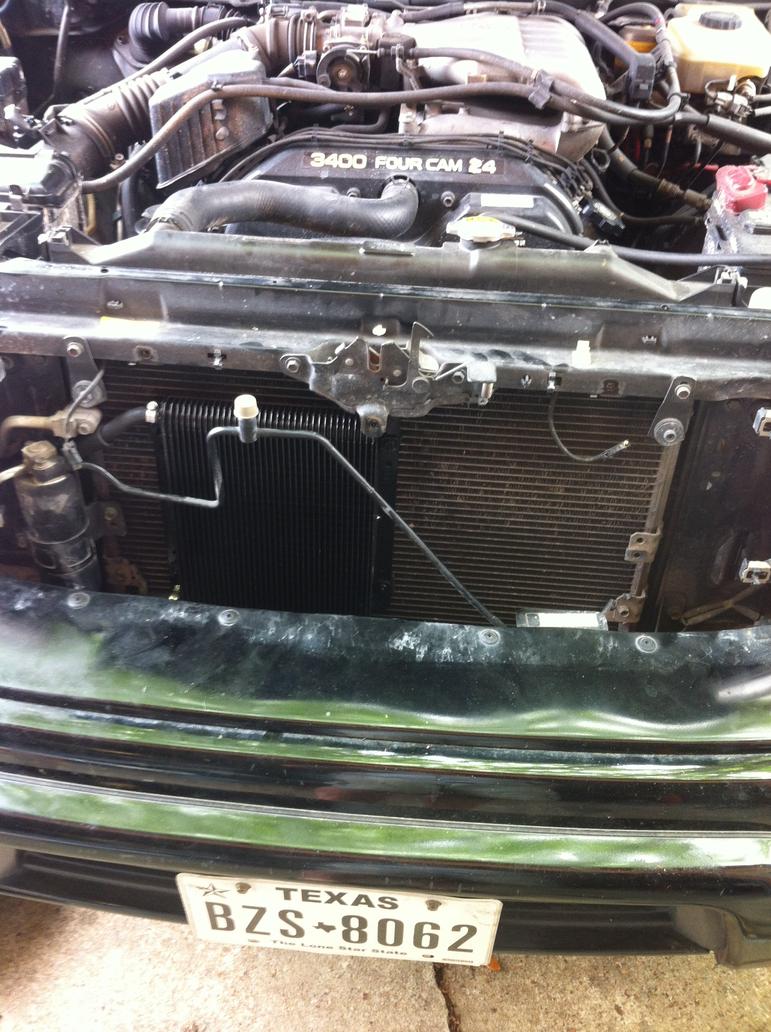

No pink milkshake for me. Removed the middle support bracket just to make installation easier. Added it back, along with the horns after it was complete.
I've got the B&M cooler and hoses at work in my toolbox, just gotta get it in the shop and do mine. Looks good!

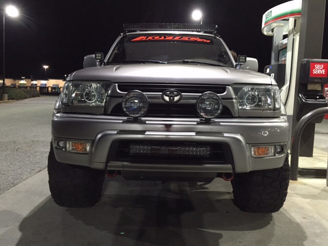

Tyr - how hard was it to do the 5 LED just below the headlights? Are yours DRL's or regular lights? That is my preferred spot to put some additional bright LED's but it seems like all the lights I have found that will fit there are DRL's.
One more thing; I can't tell from the pic, but did you remove that little panel completely or do a cutout for a flush mount fit.
Thanks, you rig is looking good!!
The LED's under the headlights where a fairly big pain to do, removed the little space cover was easy, back drill the holes for the LED to stick out of, then epoxy the entire fixture to the lip of the block (took at least half the day), then wiring, well this is it's second round since i decided i wanted independent operation instead of just with parking lights on. Now they come on with the ignition, and are switchable off also. that took about half a day also.
I really do need to straighten out my bumper! :mmph:
