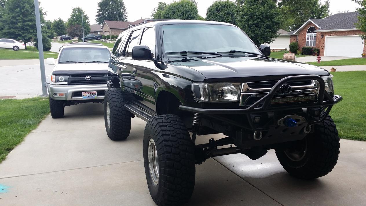

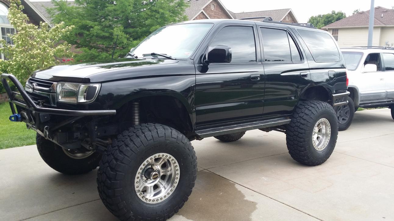

While I continue pondering the direction I wish to go with my lift/tires I decided to raise the front an inch in order to level it out a bit front to back.
I also took the grinder to my front skid when I had it up on the lift... While I was under there I noticed my LCA was contacting the skid and actually limiting my down travel. Had to take about 1/4" off of it on both sides.
Before:
After:

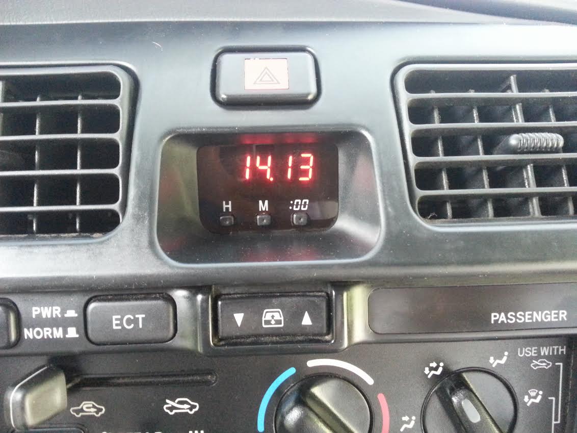

Turned my burnt out clock into a voltmeter. I really like it, very functional. Got the idea from another site.
Replaced bulbs with white leds.
Also replaced my dried out vacuum hoses with silicone.

Damn! You know what would be sweet? If I were to take my AFR gauge and put it where the clock is! I doubt it would be too difficult to swap in the display from the guage too.

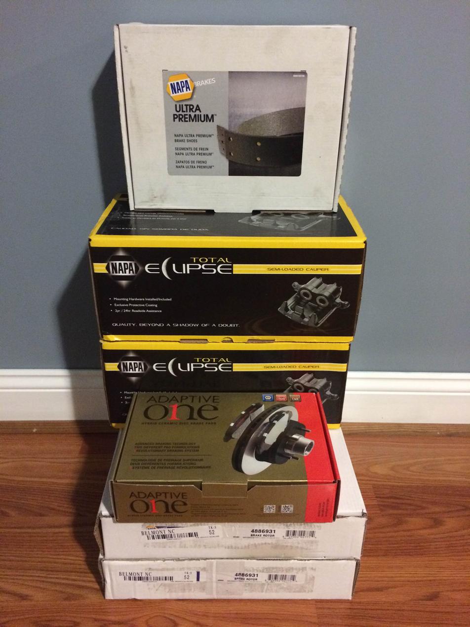

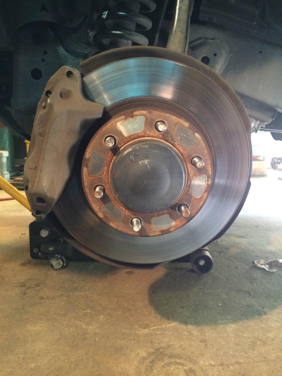

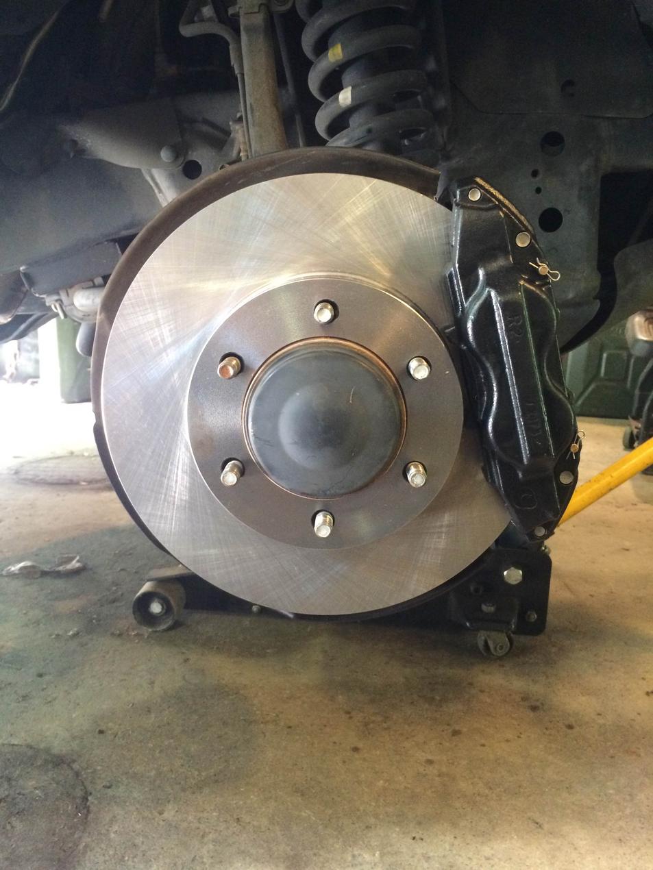

I did the 231mm 13WL Tundra brake upgrade with the help of an old friend.
I used NAPA Eclipse calipers, NAPA Premium rotors, and Adaptive One pads.
While we were at it we did the rear brakes too. My parking/emergency brake isn't working now, but I'm hoping it's because the shoes haven't seated/self-adjusted enough yet. I hope they'll get themselves right after a week or two. I don't use my emergency break much, but it's a "security blanket" I like having.
(Sorry about the super large pictures. I couldn't figure out anyway to re-size attachments.)

You need to go in and adjust the rear brakes most likely if your parking brake isn't working at all. Do a search for how to adjust them. Basically when I did mine I adjusted the shoes out until they just barely touched the drums, then I backed them off a bit. Once that is done and you confirm they are working see if your parking brake still doesn't work. If it doesn't but the brakes are properly adjusted then you need to adjust the parking brake upfront at the handle. There is a jamnut system you can adjust it with. This is also assuming your cable is good and the bellcranks aren't frozen.
Once you get it working you really should use it every-time you park it. It's easier on the transmission because you aren't rolling onto the parking pin every-time and it will keep the rear brakes adjusted properly.
