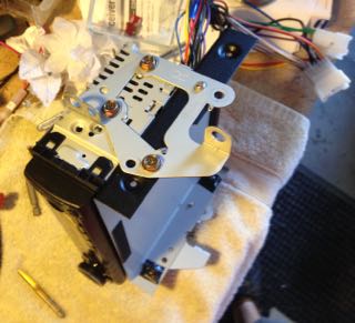

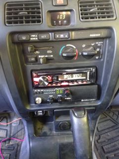

Got the CB installed...mostly. Need to get an elbow for the back of the CB and order my CBI mount.

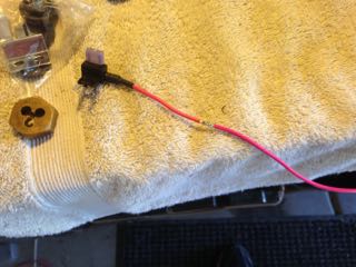

Its a PITA but I prefer to solder all my electrical connections then use heat shrink over them and if I'm really OCDing I wrap the shrink in electrical tape.
Wanted the radio to be secure so I tapped the holes up front to use the Toyota screws and drilled/tapped holes in the back for the screws that came with the CB.

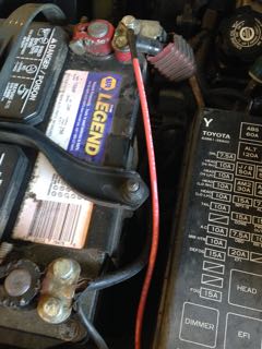

Ran the orange line to the Battery and the red one was tapped into constant power so I can enjoy CB without the ignition on and grounded to frame. Used some overkill 12ga silicone wrapped wire from the battery into the cab.
Used a FireStik fire ring 9 foot MU-8R9 with removable PL connector so I could make the teeniest hole possible in the drivers side grommet.

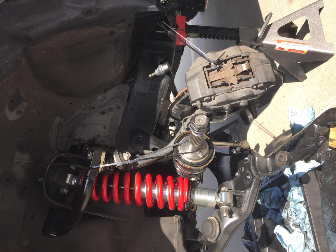

Replaced driver/passenger side cv axle shafts/LBJ/OTR/ITR over the weekend
...i'll have to look up how not to post sideways pics

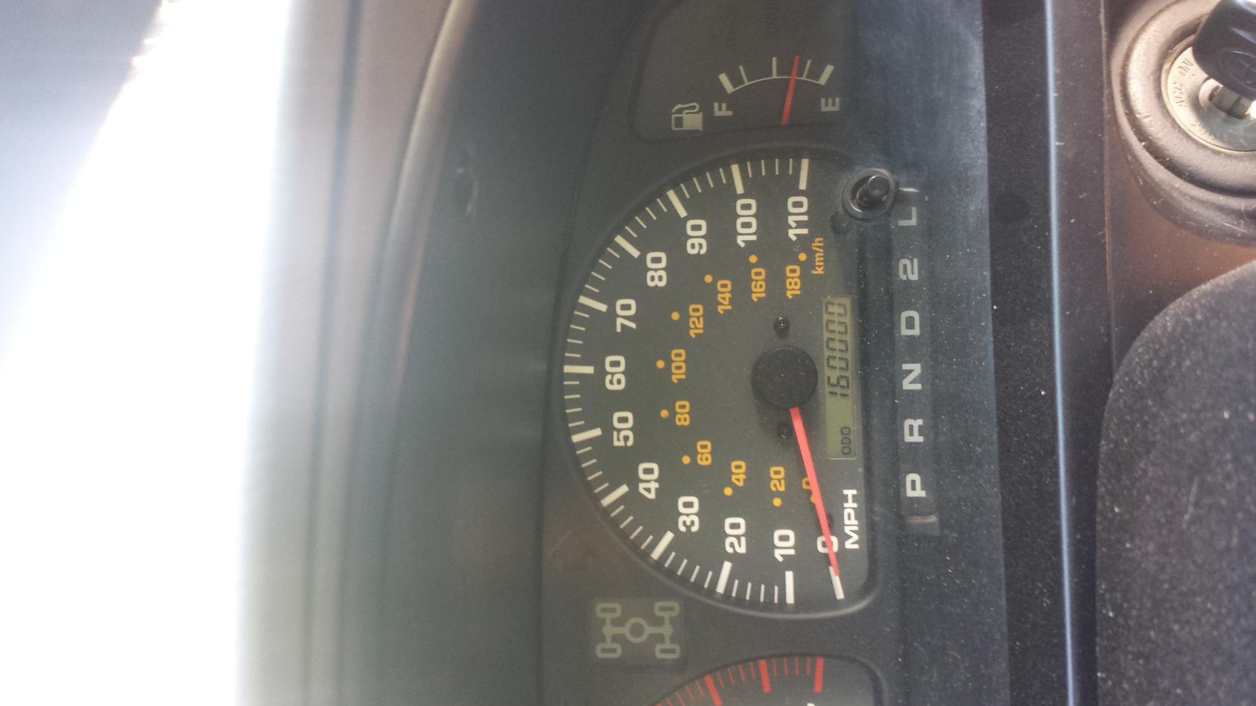

Hit 160,000 today!
Hit 160,000. Decided to do some trail riding and take some pics. also cleaned the throttle body.
