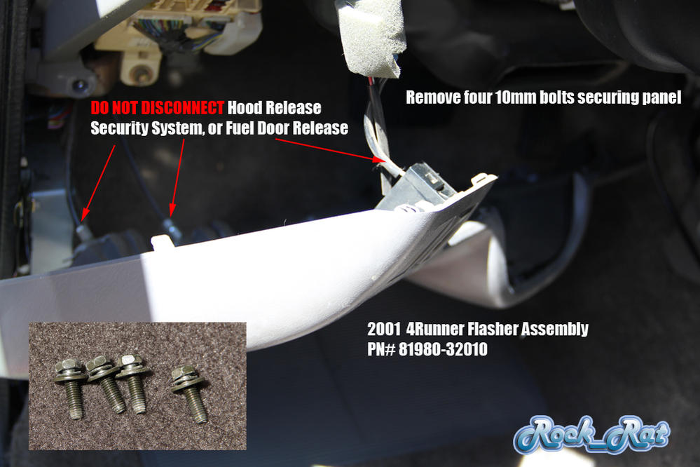

2001 4Runner Flasher Assembly
Replaced my Flasher Assy.
Takes about 30 minutes to an hour max. Location is behind the access panel on the rear top of JB1.
Steps
  1. Remove four 10mm bolts securing lower panel

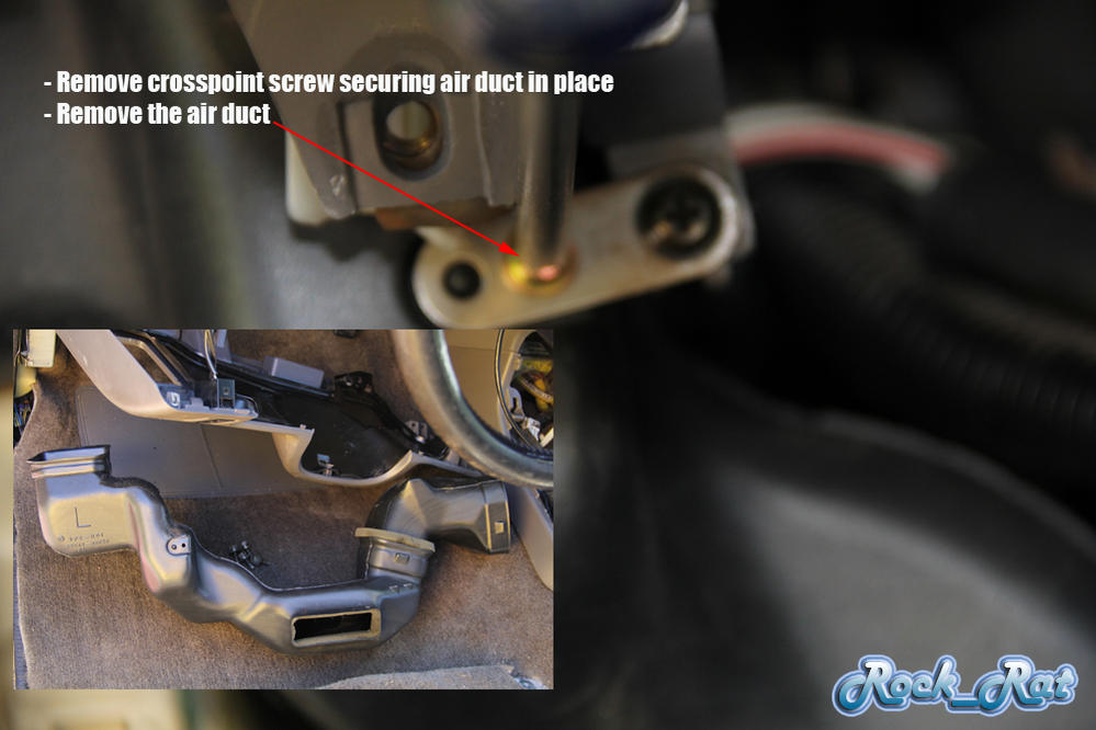

  2. Remove crosspoint screw securing air duct
  3. Remove two 10mm bolts securing JB1
  4. GENTLY pull JB1 towards you and with a pry tool remove the flasher assembly
  5. Install new flasher assembly and ops check
  6. Put it all back together

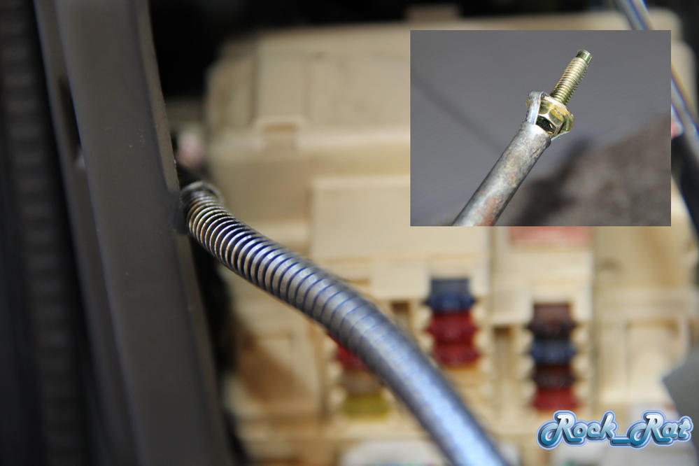

NOTE: DO NOT DISCONNECT YOUR FUEL DOOR OR HOOD RELEASE MECHANISM - It's NOT Necessary! DO NOT DISCONNECT YOUR SECURITY SYSTEM. Arrows in photo point to all three components.
The air duct is so simple to remove and install.

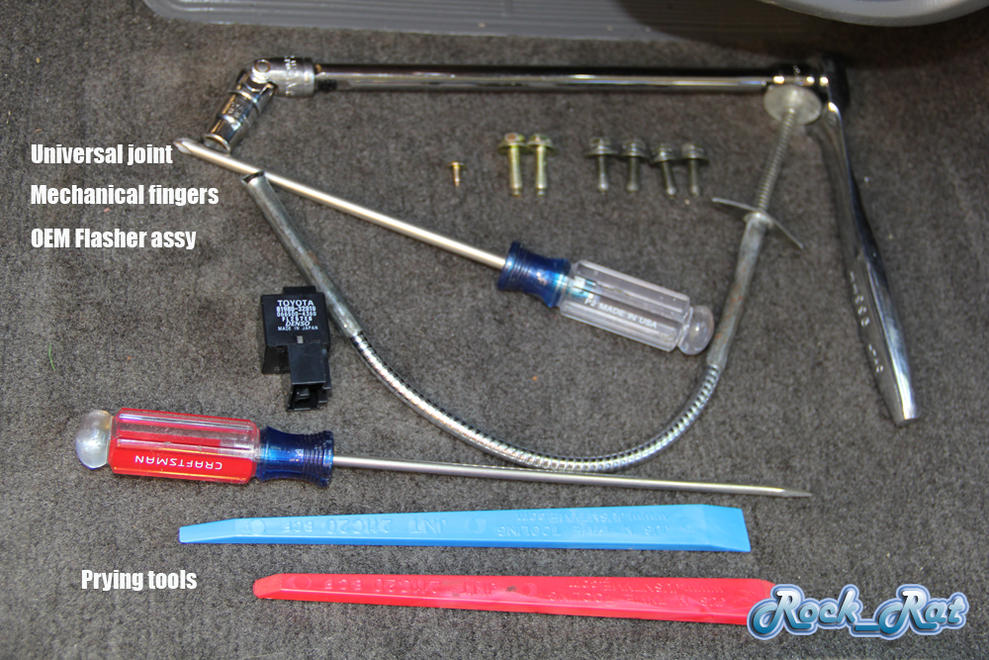

To install the upper bolt on JB1 I used mechanical fingers to get it started. Once aligned it was easy to get my universal in there and secure it down.

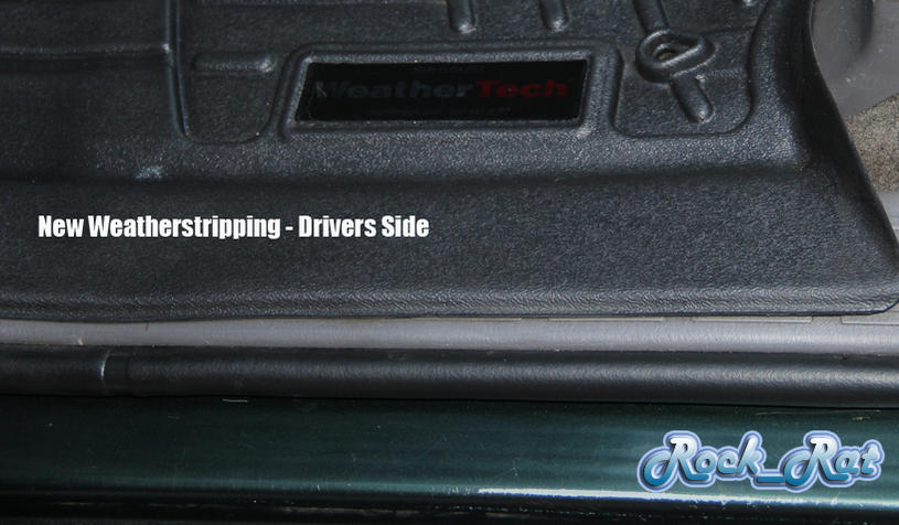

Replaced Weather stripping
Replaced my drivers side weather stripping.

When I pulled it off, the old seal left behind some grey non-hardening (somewhat sticky) sealant residue around the door. The new seal has the sealant injected into the weatherstripping where it slides onto the door surround. No purchase necessary.
Place the seal with the splice on the bottom (as shown in my photo) towards the front near the hinge and the "blue" dot towards the rear. Tap it on with palm of hand or rubber mallet. This ensures your drain holes are placed correctly.
The door sill (four screws) and the front and two other plastic interior panels need to be removed and snapped back on. (No fasteners)
PN# is 62312-35013. Cost without a discount is $109.23. I get a 10% discount, no tax in Portland OR.

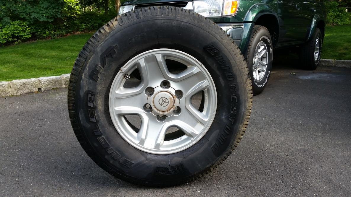

Went to the local salvage yard and bought an OEM 5 star wheel to keep as a spare. Only cost $50 and it's in pretty good shape.
