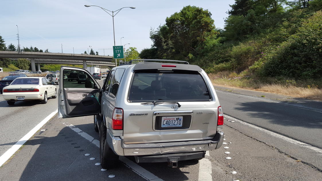

Replaced the 555 inner and outer tie rods with Toyota OE parts. The 555's lasted 18,000 miles before the left inner developed excess play, which caused a popping noise during parking lot turns and the steering wheel to shake around 40mph. Now the steering is tight like a new car.
Also installed LR UCA's, swapped my Tundra split 5 to FJC steelies, and performed an alignment
