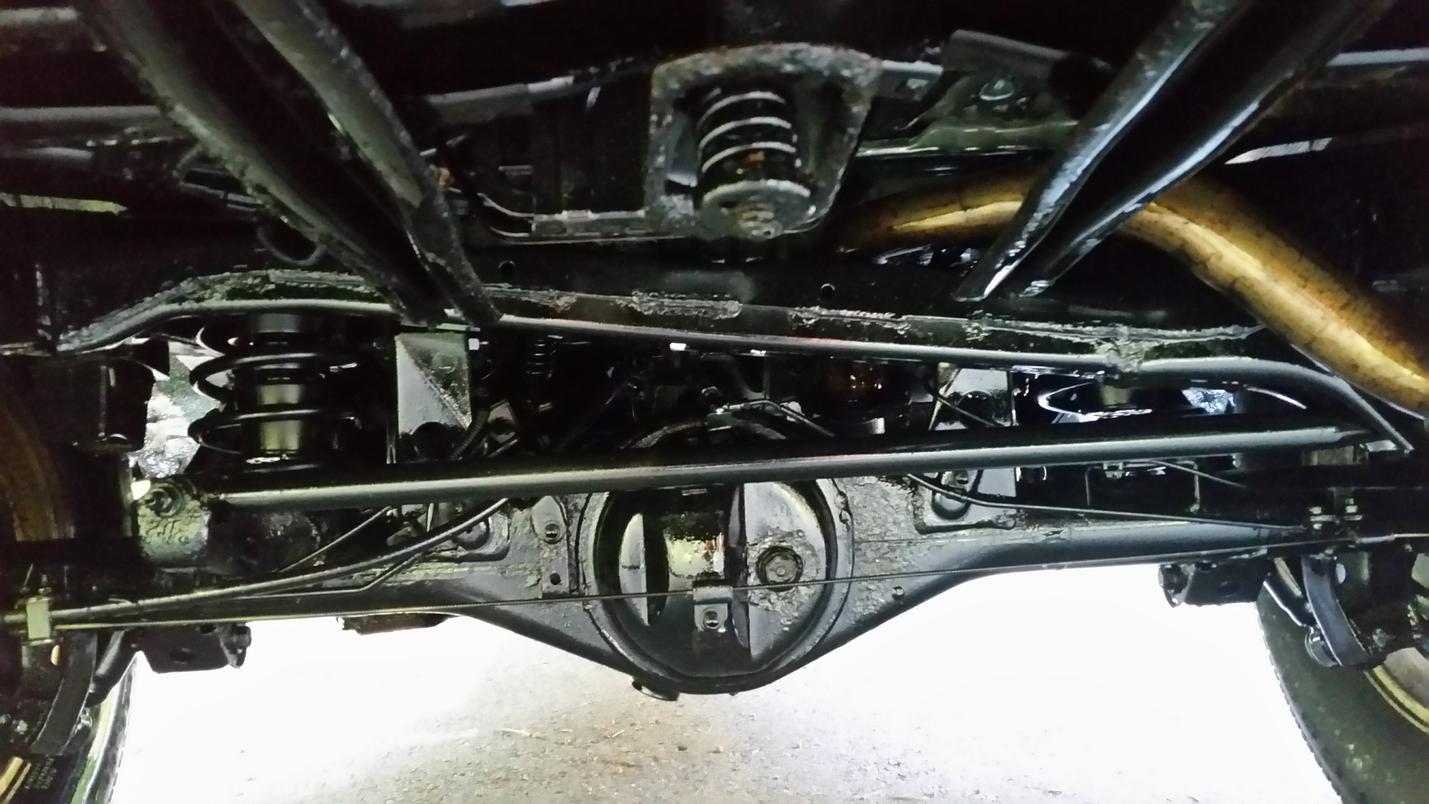

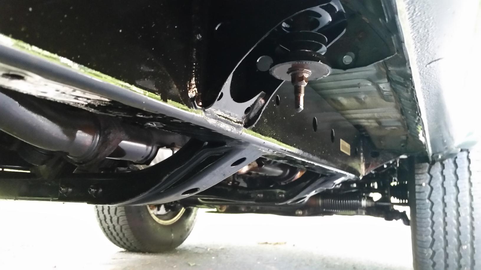

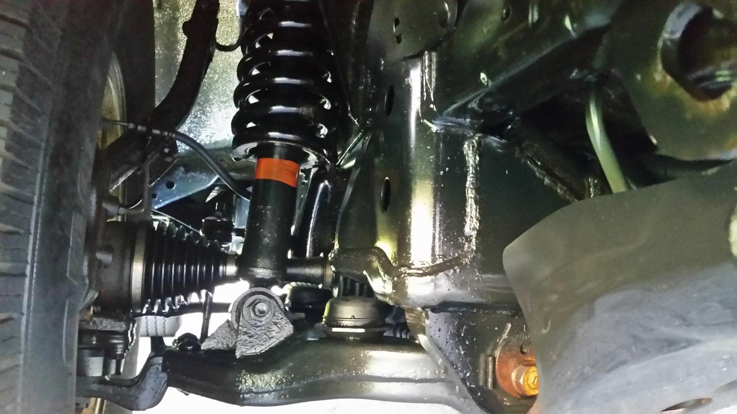

Did some prepping before winter. Like brand new...
Looks great. What products did you use?
Thanks. It is used 15w-40 oil. I saved it from when I did an oil change on my last diesel truck.
Park the 4Runner on a tarp. Use an air compressor with a spray gun. I spray everything except for the brakes and I try my best not to hit the exhaust.
I've been doing this for a couple years now trying to keep my stuff clean in the winter when they start throwing salt down. The oil does an excellent job protecting everything. The best part is that everything stays black for a while.

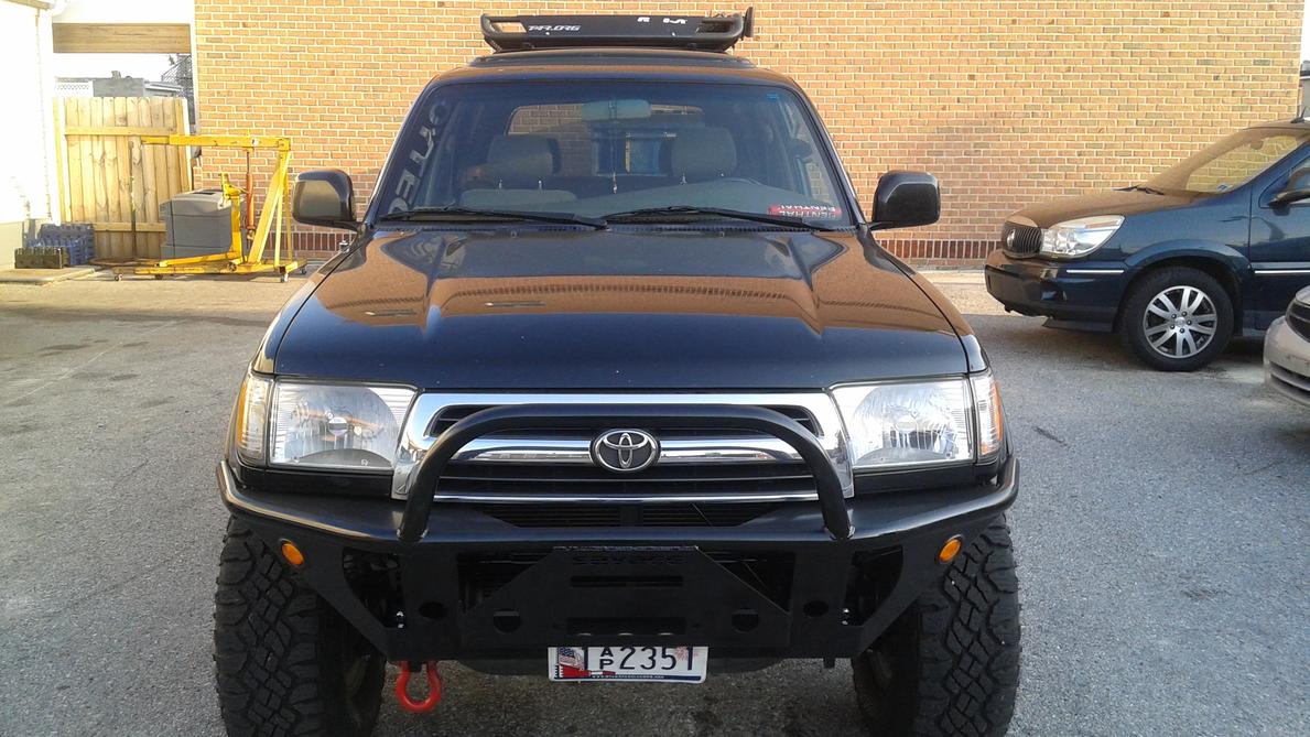

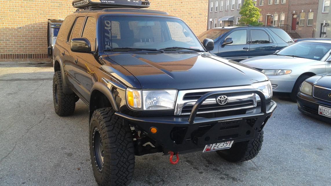

Installed my bumper this evening.

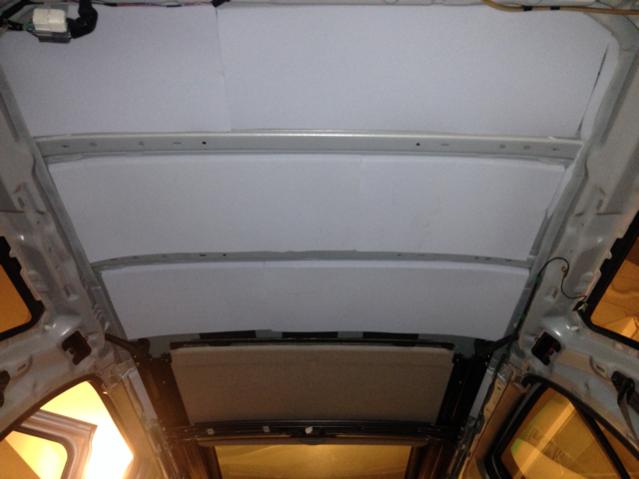

Soundproofed the roof:

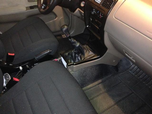

And finished the passenger compartment sound barrier + vinyl floor install:
Cargo area tomorrow, then I can test drive it and get some dB readings to see how much this hassle has changed things.
