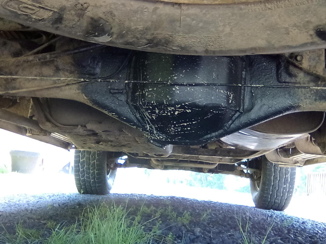

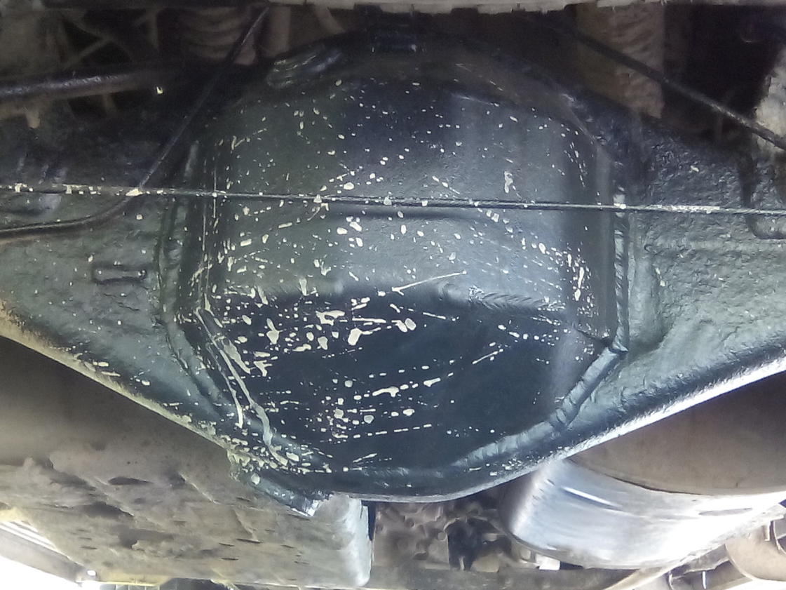

Admired the newly welded on Barnes4wd replacement diff cover.The one we cut off was like a piece of swiss cheese, 18 years of corrosion saw to that.

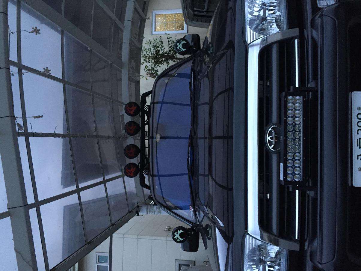

My version of taco whip mod

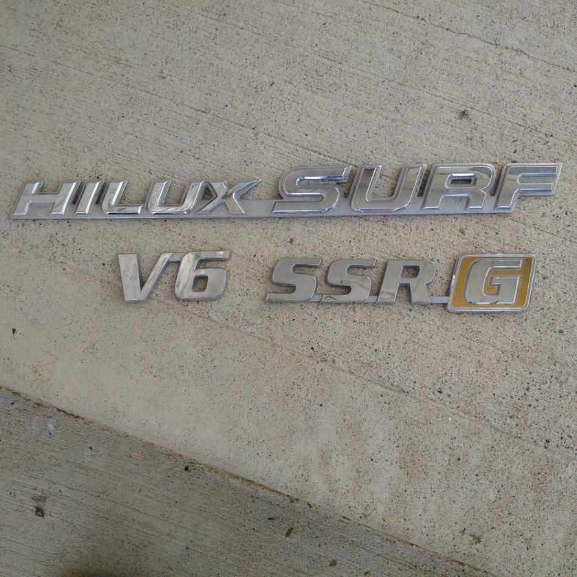

Also debadged

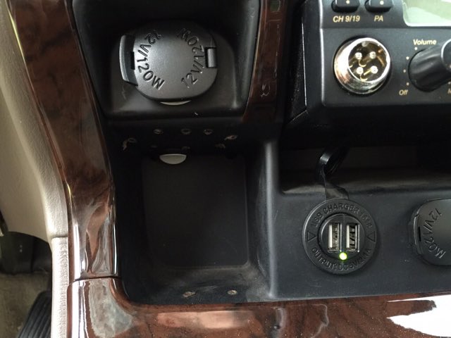

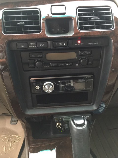

I recently installed a new Pioneer DEH-X8700BS to replace a messed up JVC DVD player. I didn't realize the Pioneer wouldn't lower the antenna when using CD & Bluetooth. If I had known in advance it still wouldn't have been a deal breaker. The other day I installed a simple SPST rocker switch inline with the blue antenna/amp power wire. I wanted to use a location for the switch that wouldn't take away from the mostly OEM look of my dash. (Plus, I had a white switch left over from something else and didn't want it sticking out like a sore thumb.) So, I installed it in the top of the small cubby beside the 12V power outlets. Works great and is easily accessible.

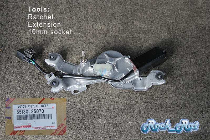

Replaced Rear Wiper Motor
Finally got around to replacing my broken rear wiper motor. Ran it through Elephant Car Wash up in Maple Valley Wa. while I was on a road trip. I had a ton of time so decided to clay bar it. Heard a snap (Clunk) going through the wash and low and behold my wiper arm was tore right off. Snapped the bolt off just below the threaded portion of the nut. The owner was great. He normally doesn't replace anything on cars older than 7-10 years but he made an exception as it was the first he had ever seen this happen, plus he saw how well taken care of my 4runner was after 14 years.
Bottom line is I made a deal with him. Told him to just order the part from Toyota of Dallas and have it shipped to me. I will do all the work. Broadway Toyota wanted $500 plus for the part and labor. Total cost for part -$238.99, and it took me about an hour. There's a small trick to replacing it. If you ever need to know just give me shout.

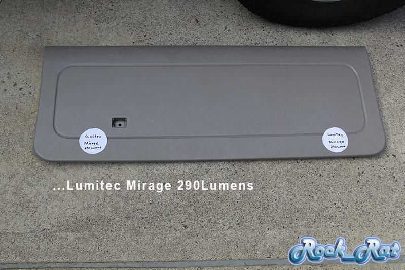

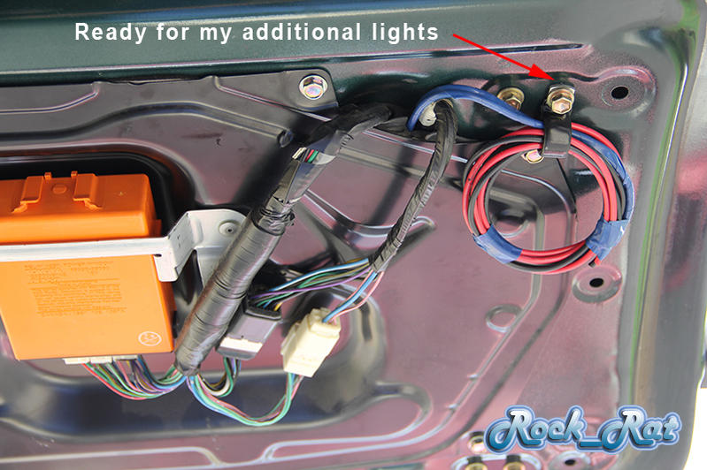

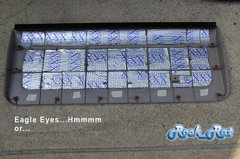

While I had the back tore apart I added my Rattle Trap and ensolite foam to the hatch and just Rattle Trap to the interior panel. Decided to run my wires for my additional lights from the rear dome light through the protective rubber boot on through the rear hatch. Wires are in a clamp just waiting for me to decide which lights I'm going to install - Eagle eyes or my marine quality Lumitec Mirage at 260 lumens (or something different). I'm concerned about the clearance and the aesthetics.
