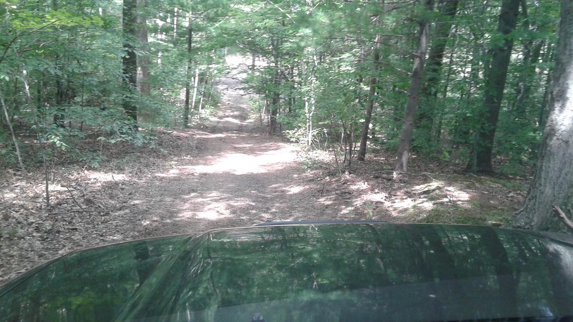

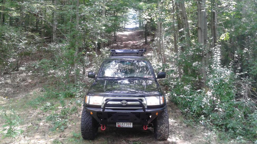

Did some exploring on the trails at Bald Eagle State Forest in Pa.

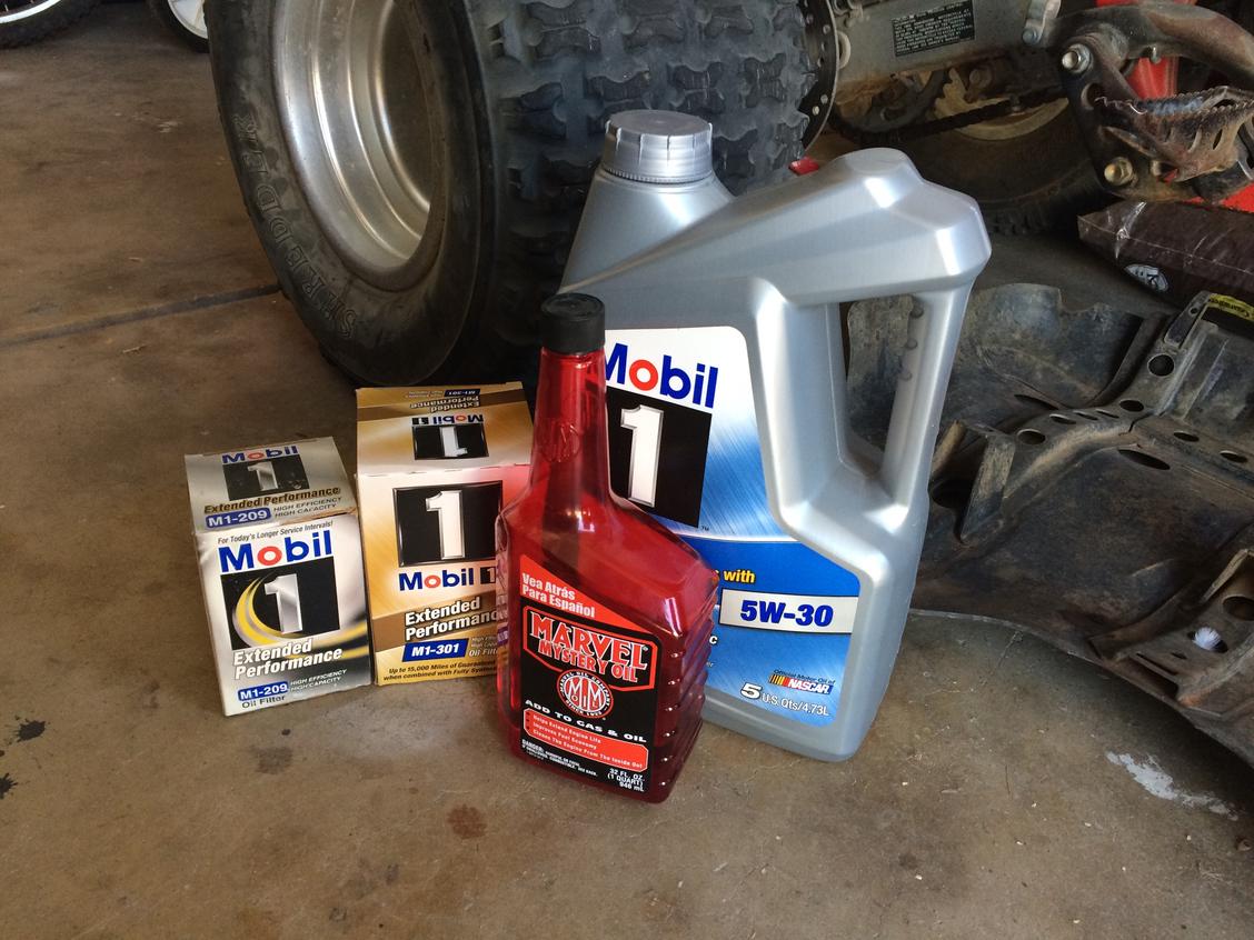

Oil change. Trains drain 'n fill. Drive shaft lube. Rotate tires.
Bonus points if you can guess what the M1-301 is for.
I am going to say for a remote transmission filter. I use a FL-1A for mine.
Why the need for MMO?
I usually use 1/2 quart of MMO just to top off the crank case.
What interval do you change your FL-1A, [MENTION=69868]LittleCaesar[/MENTION]?
Mobil1's EP filters advertise 15k mile interval, but that's working with dirty ol' engine oil. Filtering clean transmission fluid they can last much longer.
My rule of thumb has been every three years or 30,000 miles. The seal on the filter IMHO just can't go for much longer than that. I mounted mine behind the passenger headlight, but had to lower the washer fluid reservoir just a bit. Mine comes out hot straight out of the converter to the filter.
I was using a Magnefine, and it was doing well, but both of them began to leak after about 18 months at the barbs so I went for the remote set-up. Have been very pleased since.
I knew someone who ran MMO to eradicate a lifter tick in a Ford some time back. It seemed to work well for the car had over 300,000 miles when it was totaled by a taxi.

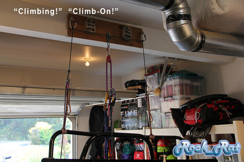

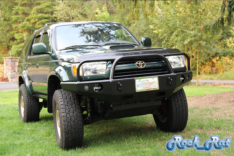

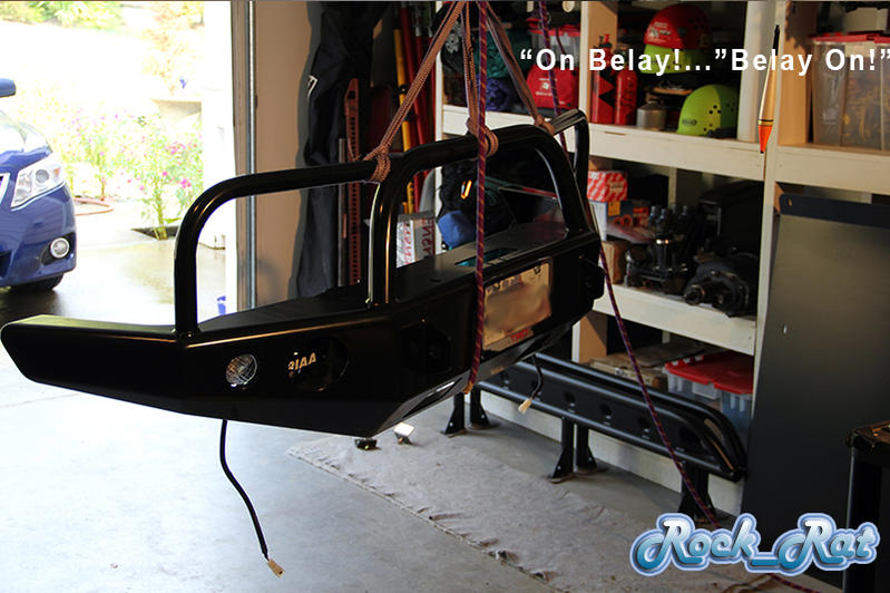

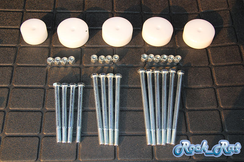

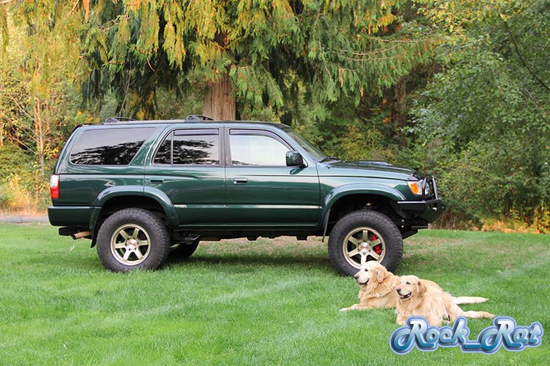

Installed 1" ToyTec Lift and Shrockworks bumper
Finally got around to installing my 1" ToyTec lift this weekend and my Shrockworks bumper. I used my trainer I use for mountaineering in my garage as a winch. Had to pull out my Yosemite big wall Jumars to hoist the damn thing. Gawd that's one heavy son-of-a-beech.
It worked fantastic having it suspended in my garage installing the lights and finally installing it on the rig. Drove it to work today just to get a feel for the additional weight. I'm so glad I did the Tundra brake upgrade first. Stopping distance is much greater with the additional weight.
Funny thing is...now I'm taking it to Broadway Toyota to have them do the oil...haha. I just bring them Mobil 1 and a filter and they do the change. Don't feel like messing with it this week. Next are the sliders and rear bud built skid.

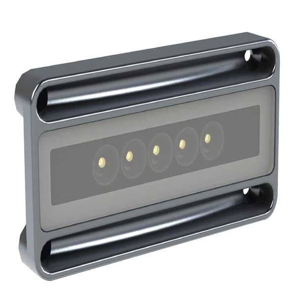

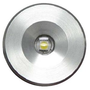

  • Sitting in my garage are five Lumitec Lite-Accent EchoLED lights for the interior panel (brushed aluminum) They are extremely low profile flush mounted and closely match my grey interior.
  • One low-profile Engine Room LED "Nevis2" White/Red to replace the dome light.
Nevis2 - Engine Room & Ultility Light, Brushed Finish, White & Red, CRI 70-75, CCT 5000, 10-30vDC, 900mA (Pretty damn spendy $169)
I want the additional bright white lights when needed for landing airplaanes but I also want to be able to switch between White and Red for camping when you don't want to wake up sasquatch and his buds. So I will need a DPDT which is what the Auto/On feature of the dome light essentially is and perhaps an SPDT for the five interior hatch lights.
Using the philosophy "Measure twice cut once" I'm still planning it all out. I want to do it right the first time. The idea of adding two more dome lights isn't that far fetched. Look at the post from [MENTION=99874]7echo[/MENTION] It's doable and with a little work I think you can expand the dome light to accept a larger CREE light and still have the auto/On feature. It would look 100% OEM.
