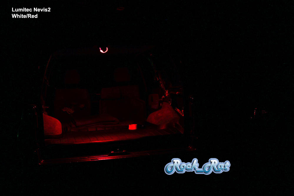

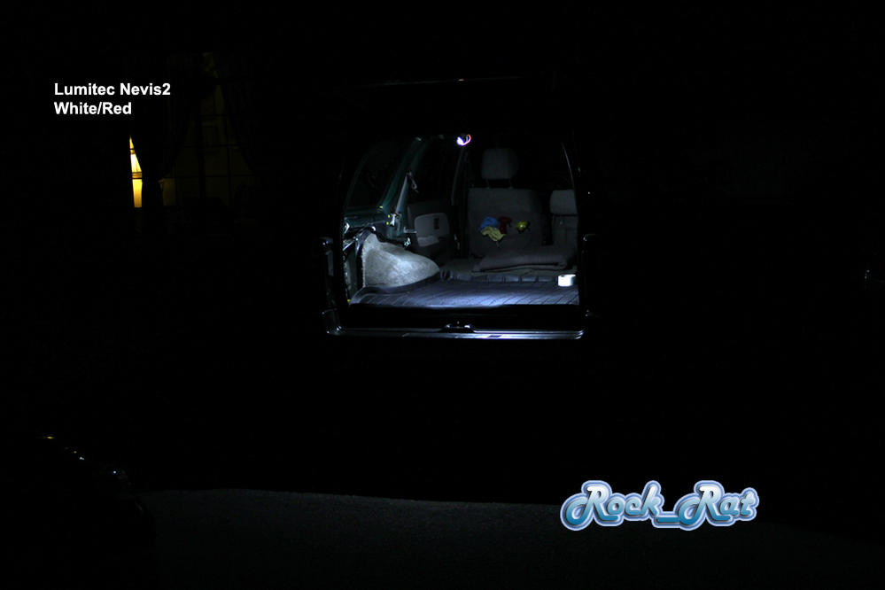

Rear Hatch Cargo Area Light

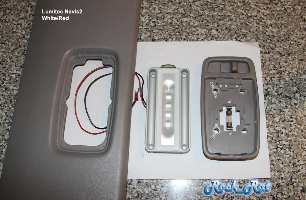

  • Sitting in my garage are five Lumitec Lite-Accent EchoLED lights for the interior panel (brushed aluminum) They are extremely low profile flush mounted and closely match my grey interior.
  • One low-profile Engine Room LED "Nevis2" White/Red to replace the dome light.
Nevis2 - Engine Room & Ultility Light, Brushed Finish, White & Red, CRI 70-75, CCT 5000, 10-30vDC, 900mA (Pretty damn spendy $169)
I want the additional bright white lights when needed for landing airplaanes but I also want to be able to switch between White and Red for camping when you don't want to wake up sasquatch and his buds. So I will need a DPDT which is what the Auto/On feature of the dome light essentially is and perhaps an SPDT for the five interior hatch lights.
So I tested the Nevis2 out tonight just to see how it looked and it's pretty awesome. I like the low profile and the ability to switch between white and red off the OEM switch.
Now the challenge is finding a way to install it so it looks OEM. Here's a couple of photos. I'm open to some ideas. 3D printing perhaps?? Fiberglass? Carbon Fiber? Re-shape the plastic interior piece? Return it and go with white on one switch and red on another?

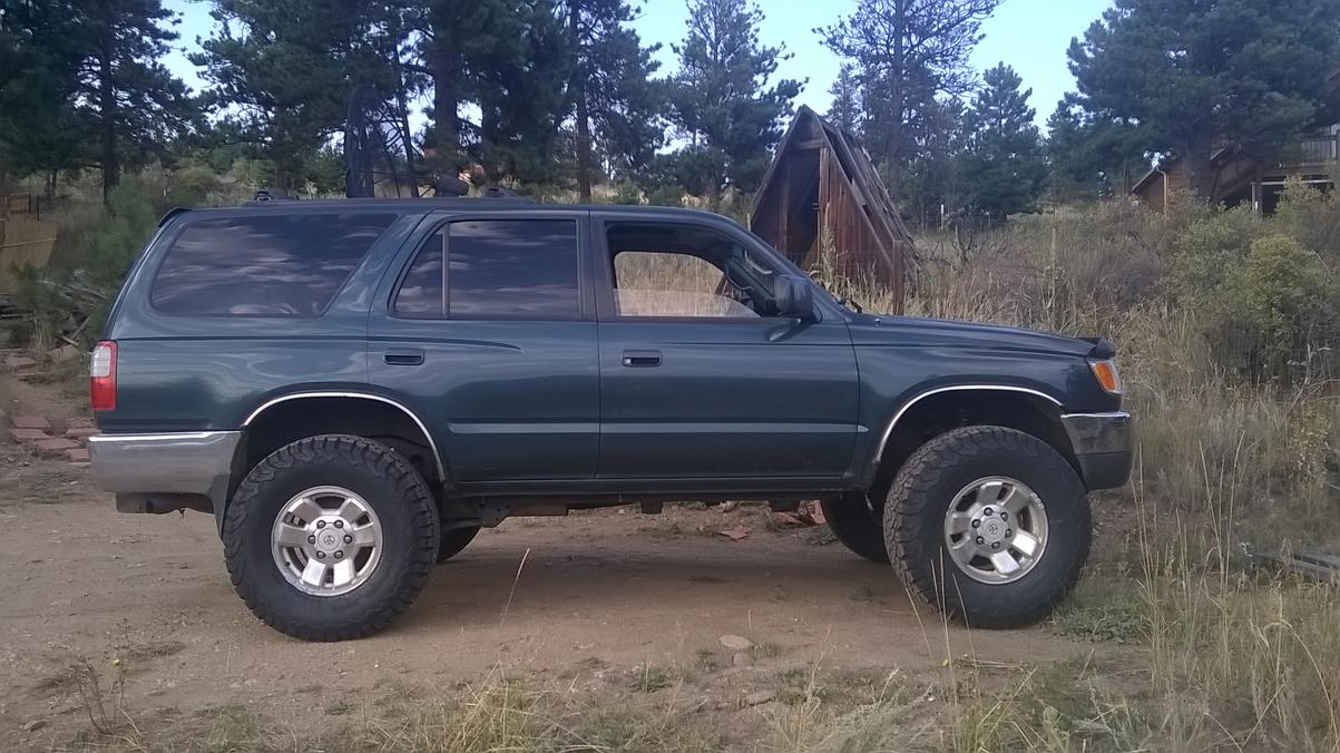

I got tires on and put Spidertrax wheel spacers on. 285 75 r16 BFG A/T with OME heavy springs f/r and OME shocks f/r. There is definitely going to be some trimming needed to wheel it.
I put it in my thread but had to share in this one because I enjoy looking back at what all your rigs look like as they transform.
I'm running the same size tires but those things look massive on your runner.
I thought so too after looking at everyone elses pics, in fact I had to look at the tire size to make sure they arent bigger lol. Not sure what the deal is. I may have to get a body lift and trim but we'll see. It's getting a test run on a close, but flexy trail tomorrow so I can mark all the spots that need to get worked over. Not cutting fenders though if I can help it.
Yeah cause I've got a 3" lift on mine and they don't rub at all. Of course I really quit hitting the trails after breaking enough things on it lol. But my tires don't look THAT big
[MENTION=128897]Gadgetguy[/MENTION]
I think the spacers are creating a bit of a parrallax with respect to the way the photo is taken. Those tires sure do look pretty tight in the wheel wells.
I had them test fit one on the front, and it would NOT fit without the wheel spacers. Discount refused to install the spacers so I had to find a way to install them and go back for tire mounting. Gclark you do seem to have a bit more room. Did you trim anything at all? I wonder if BFG's run a little bigger these days than they used to. That didn't used to be the case. Both my front and rear bumpers came a little mangled when I bought the truck and they are made of fairy dust and pot metal brackets so I wonder if that has anything to do with it.
They had the OME part numbers right on them so I don't think that's the problem and after install I did get a true three inch lift from the hubs to the fender. Hard to say. I rub my front bumper just doing street driving.
These are cell phone pics too, it doesn't seem to look QUITE that bad in person, but I'll find out tomorrow.
