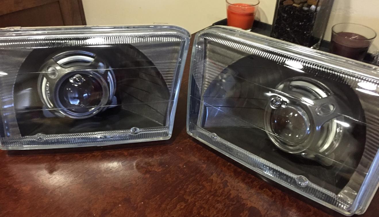

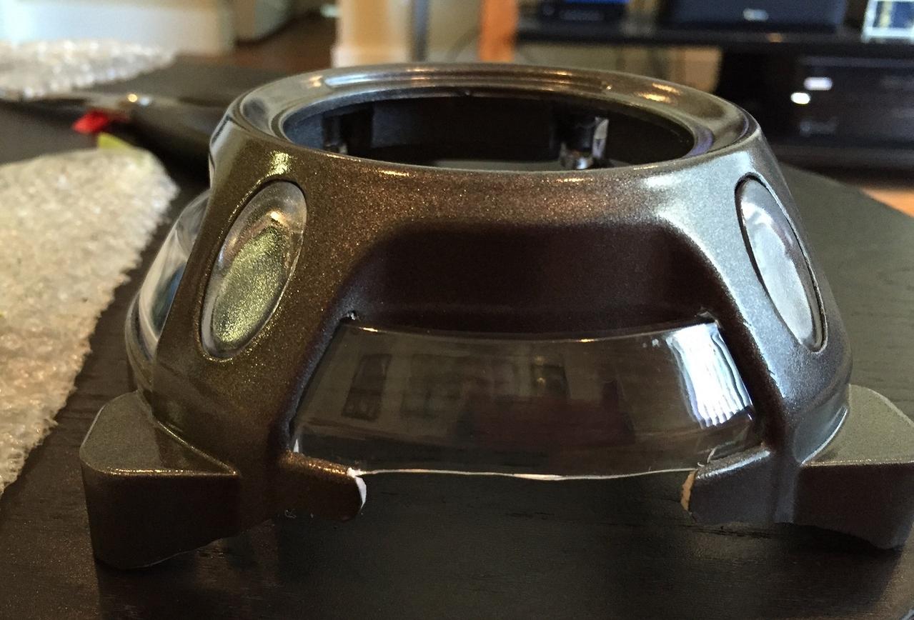

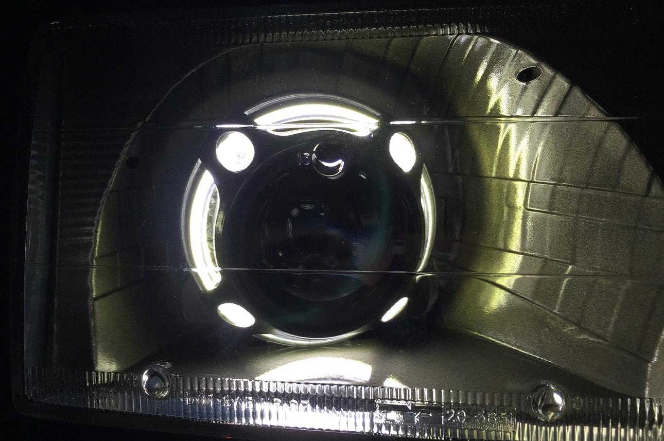

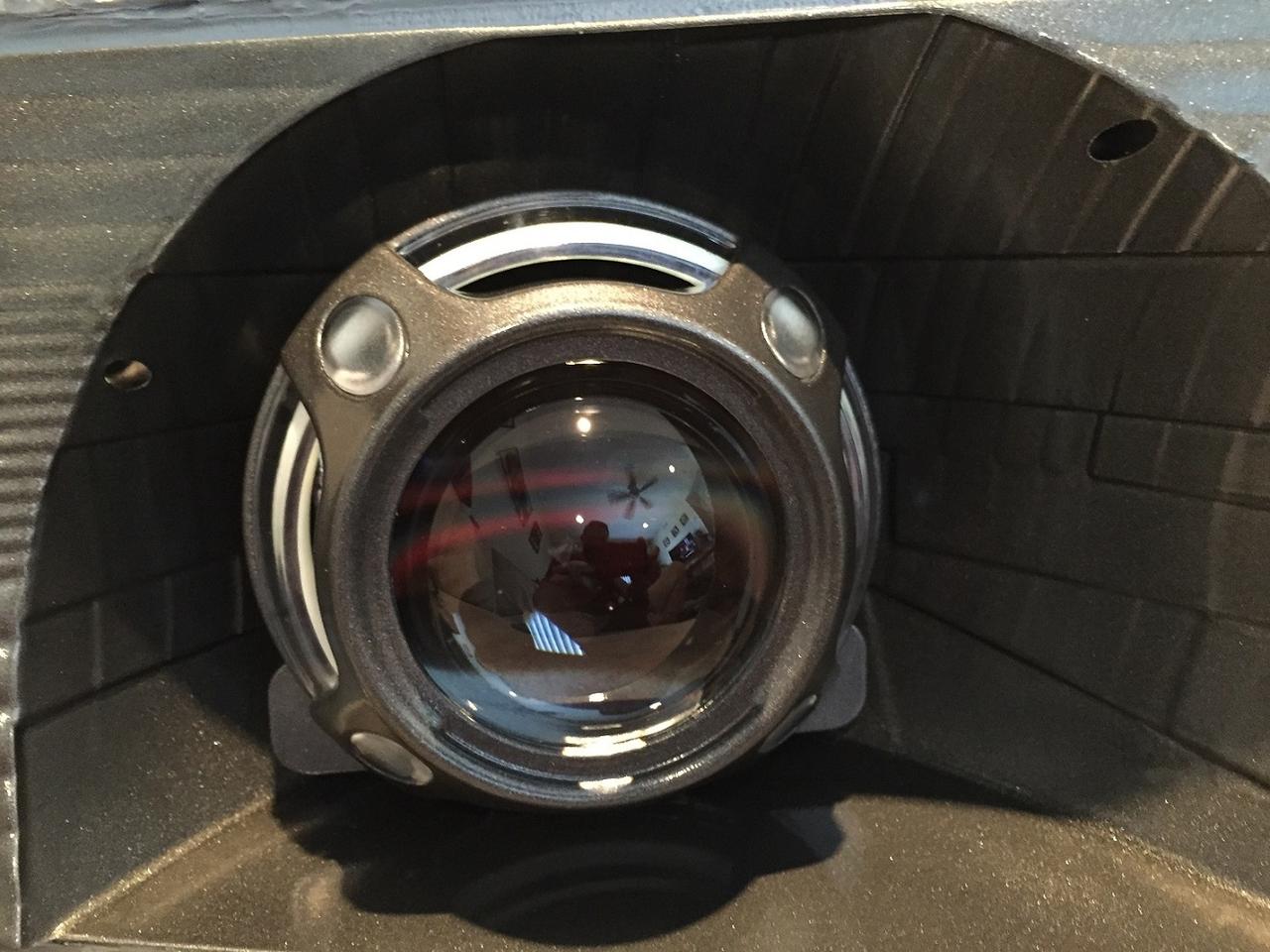

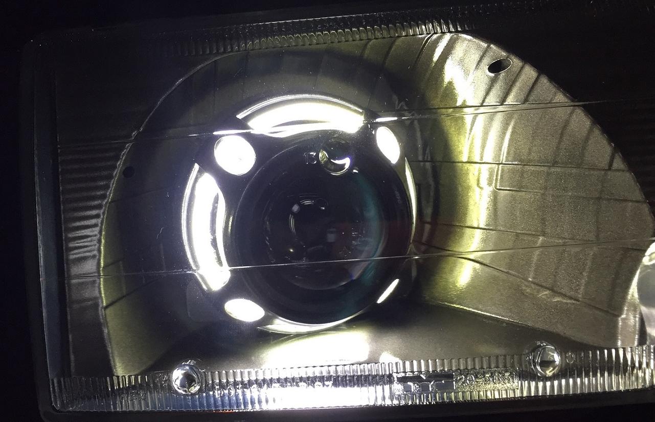

Completed a new Retrofit and wrote up a DIY.
BrianSD_42 's Morimoto Mini D2S 3.0 Panorama Halo Retrofit DIY Journey
Yes these are for sale. $700 + shipping ($50 more than last time because of the halos). The price is firm.
The thread is a DIY and is not a classified hence why I don't mention the sale or price.
Assembling and painting these took over 10 hours but I had Netflix playing the background! It is kind of like working on small models. Not that difficult but time consuming. I've still got more work to do, I need to add the breathing tubes and seal up the electrical connectors with silicone.

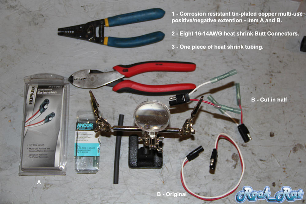

PIAA 510's to Existing Fog Lights

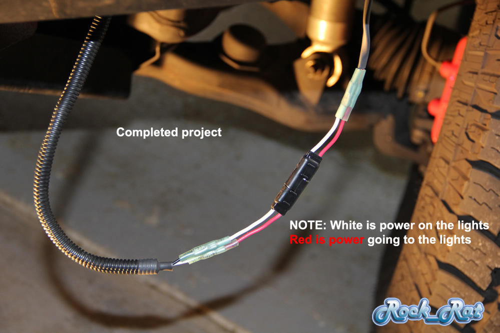

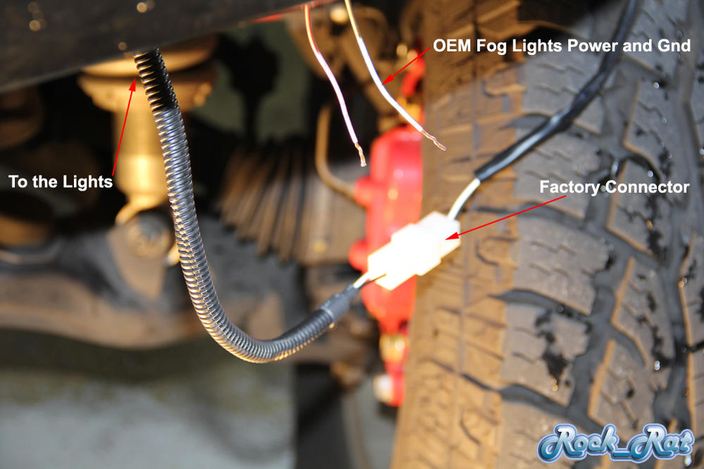

PIAA 510 Lights to Existing Fog Light Wiring
It was time for me to connect my PIAA 510's to my existing Fog Light wiring. These lights came with (ordered them) my Shrockworks bumper and also included a "nice" wiring harness.
I wasn't too fond of the connector or the harness considering the harsh environment the lights and wiring would be in. I could have used your typical male/female connectors (crimp and shrink wrap) but instead I wanted to use a waterproof tin-plated corrosion resistant positive/negative trailer style connector.
Materials Needed
  1. Heatshrink Butt Connectors 16-14 I went with marine grade for the following reasons:
    • Heat activated adhesive lining provides imperious seal to salt water, oil and acids
    • Shrinks to form a water tight seal and vibrations/strain relief
  2. Hopkins 2-prong extension Tin-Plated corrosion resistant
  3. One piece of Heat Shrink
Total cost approximately - $10
The pictures are self-explanatory.
Stow the loose wire any way you want. I prefer to clamp it down.
