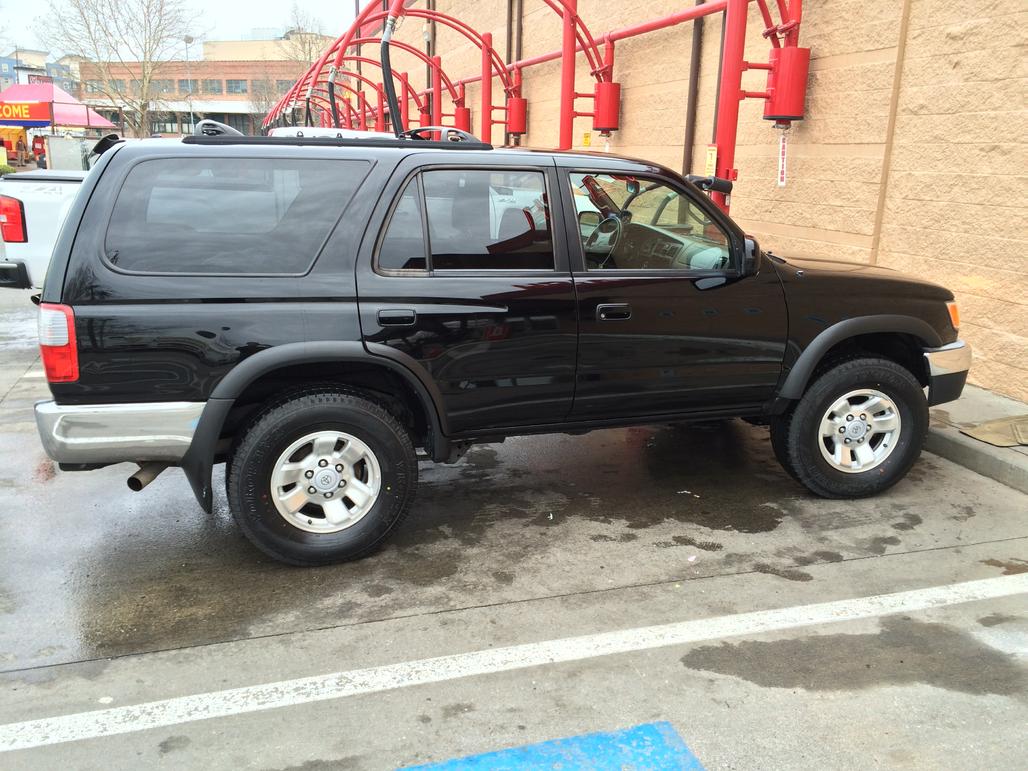

Here's a pic from the day I brought it home
Here's a pic from a few days after I bought it

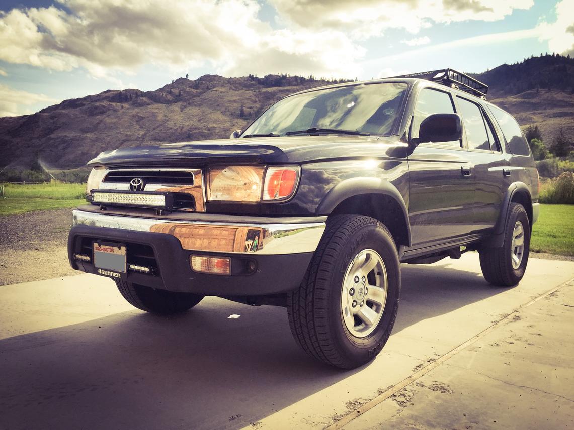

And here's one of how it sits today

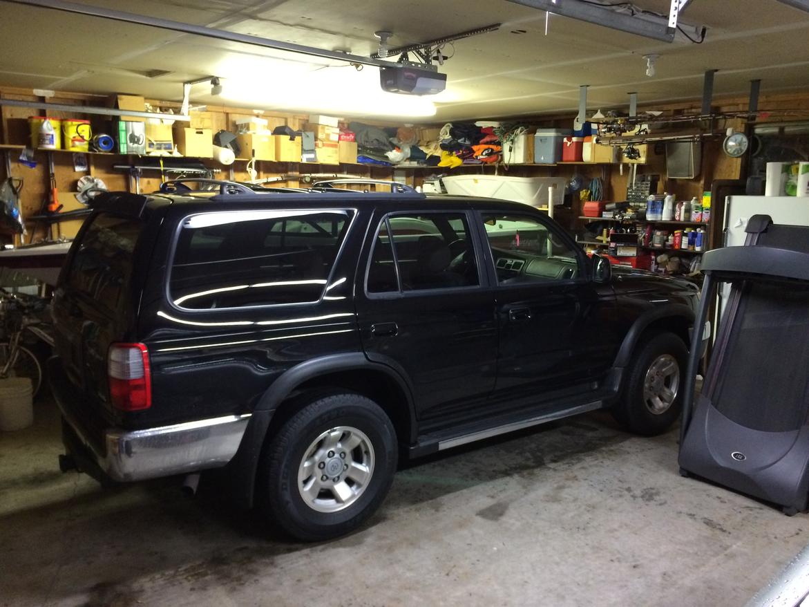

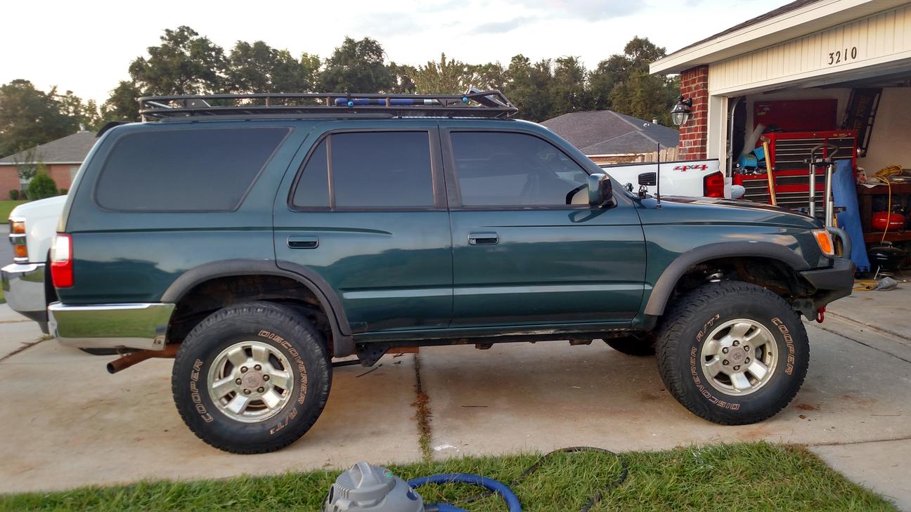

Gave ole' girl a bath and wax to cover up some pin striping from a few weekends ago at Boggs and Boulders off-road park. Got to get some paint to cover that spot under the rocker panel. Dang stump!
Very clean! Gotta give mine a wax. Waiting for the weather to cool down out here first!

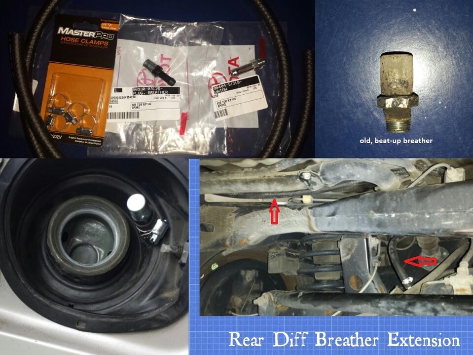

Rear diff breather extension
the Toyota parts needed arrived from my friends down at Alamo Toyota in San Antonio, and after a stop at Autozone for hose and clamps, this mod was painless.
Didn't have to undo the gas door latch, or any plastic cover in the wheel well, but I did remove the rubber boot around the gas filler tube, which required removing two retainer rings embedded in the rubber (this was not mentioned in some of the write-ups). Shoved the hose down until it popped out the other end, routed it to the newly installed union and voila!
If water reaches the breather now, well, I hope I'm wearing a snorkel.
