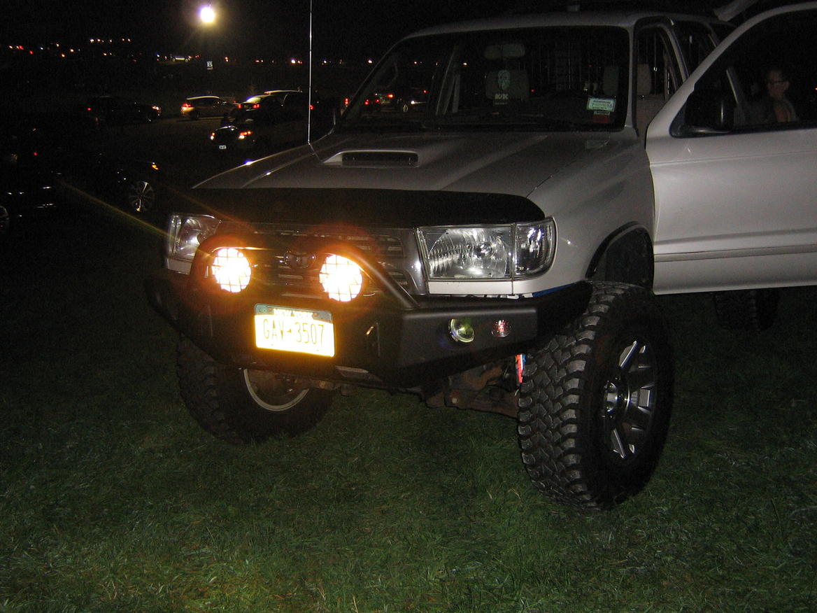

I love the Shrockworks bumper. For me and my lifestyle, it works. It has a very snug fit and not too obtrusive. The quality and craftsmanship is tremendous. It's heavy and I found it best to suspend it to put the lights in and do the install. There's a bit of grinding to do with an angle grinder for the prep work, need a 3/8th drill bit for the frame. It's a challenge but can be done in a day with a buddy.

Glad to hear you love your Shrockworks bumper. Which PIAA lights are you running in the bumper. I was going to order the driving lights, and found them for $150 buying direct from PIAA on clearance. I just don't know if I should order the 510 SMR Driving XTreme White Plus Halogen Lamp Kit or the 510 Super White Driving Lamp Kit... I can't seem to find what the difference is between the two, so I planned on calling them today. Another thing is that Shrockworks is now offering Baja Designs Squadron lights instead of PIAAs. Again, depending on my needs and what people thing of them, I might end up spending the extra money if they're that much better.
