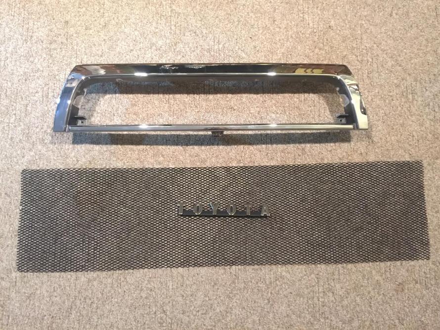

Started my Satoshi grill mod. I didn't have painters blue tape when I went to paint the inside of it after painting so it was cut short. Will hopefully get to it sometime this week.

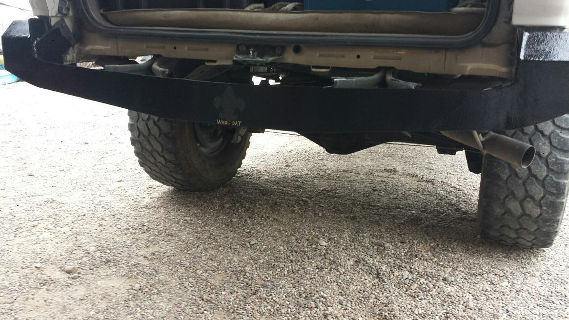

Replaced the radiator, then took it over to Whitson metalworks to have my Stubbs hd sko sliders welded on. Then gave it a bath. Too dark for pictures.
