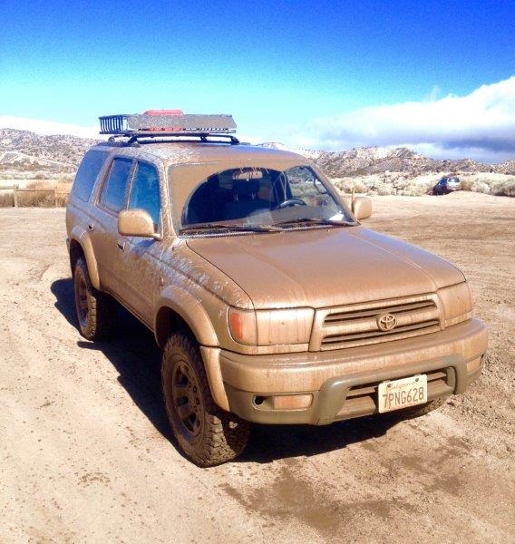

alternator
Learned to swap out an alternator (actually not that difficult at all and I'm really happy to have learned how) after the mud shorted it out.

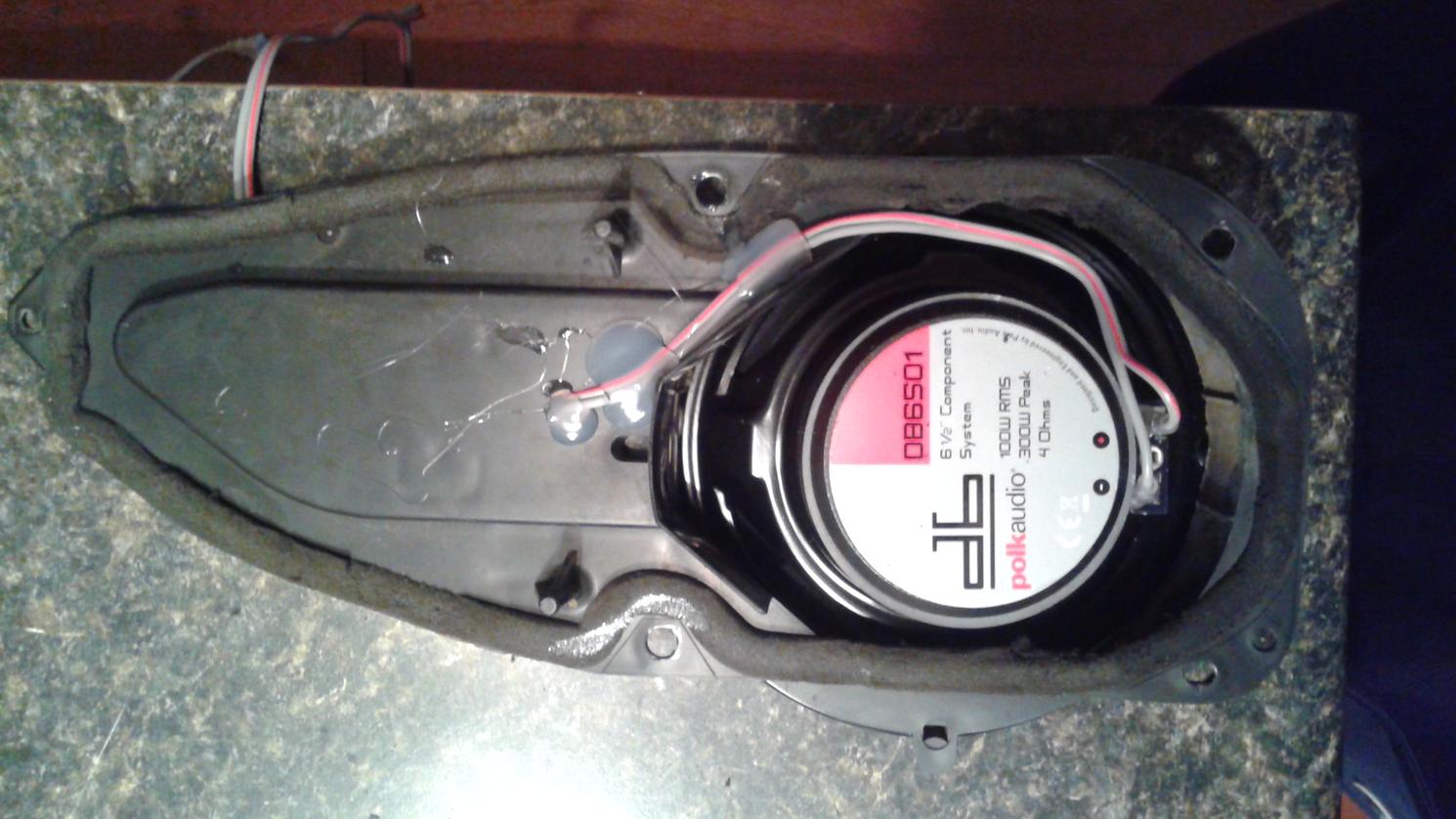

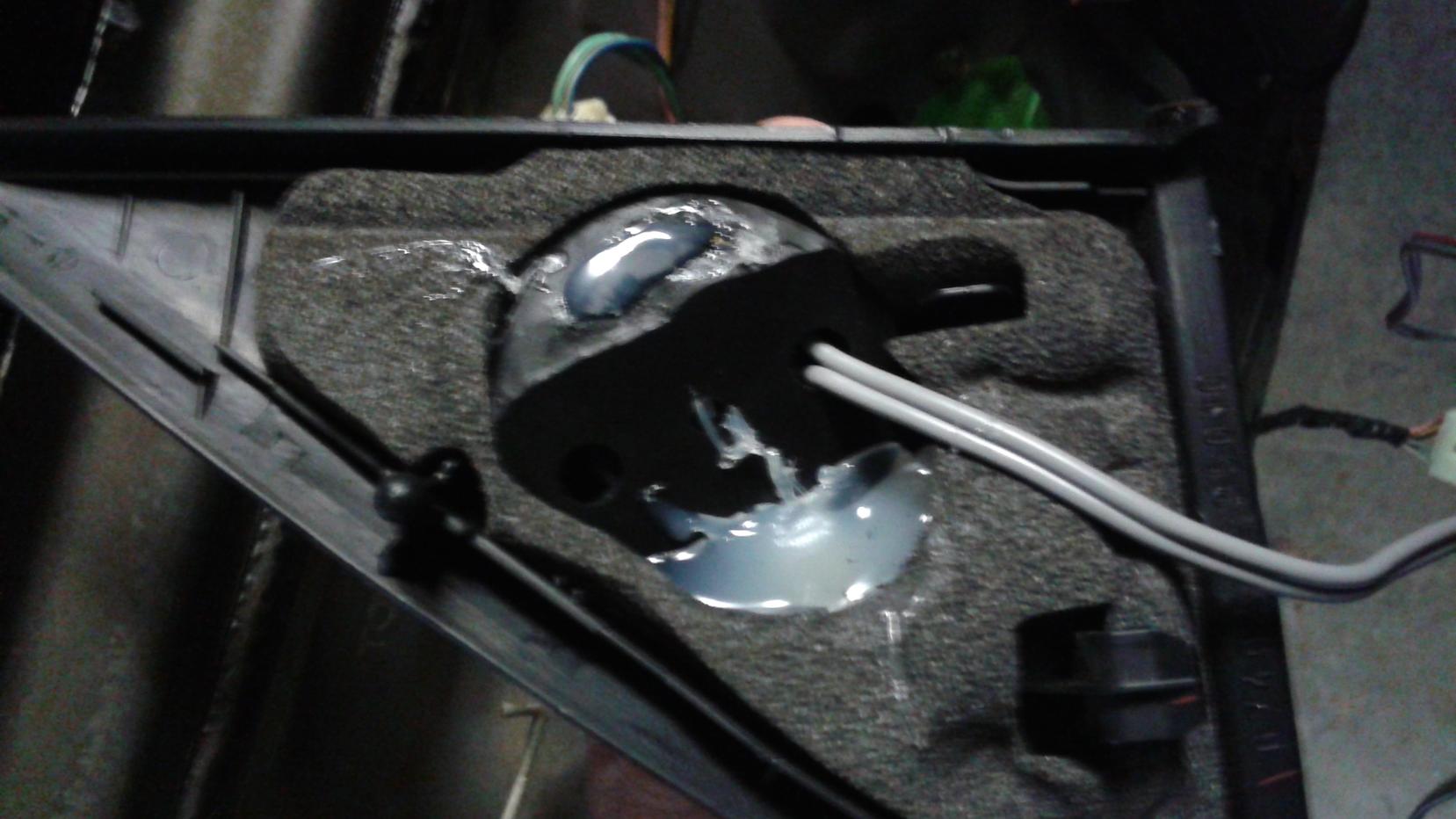

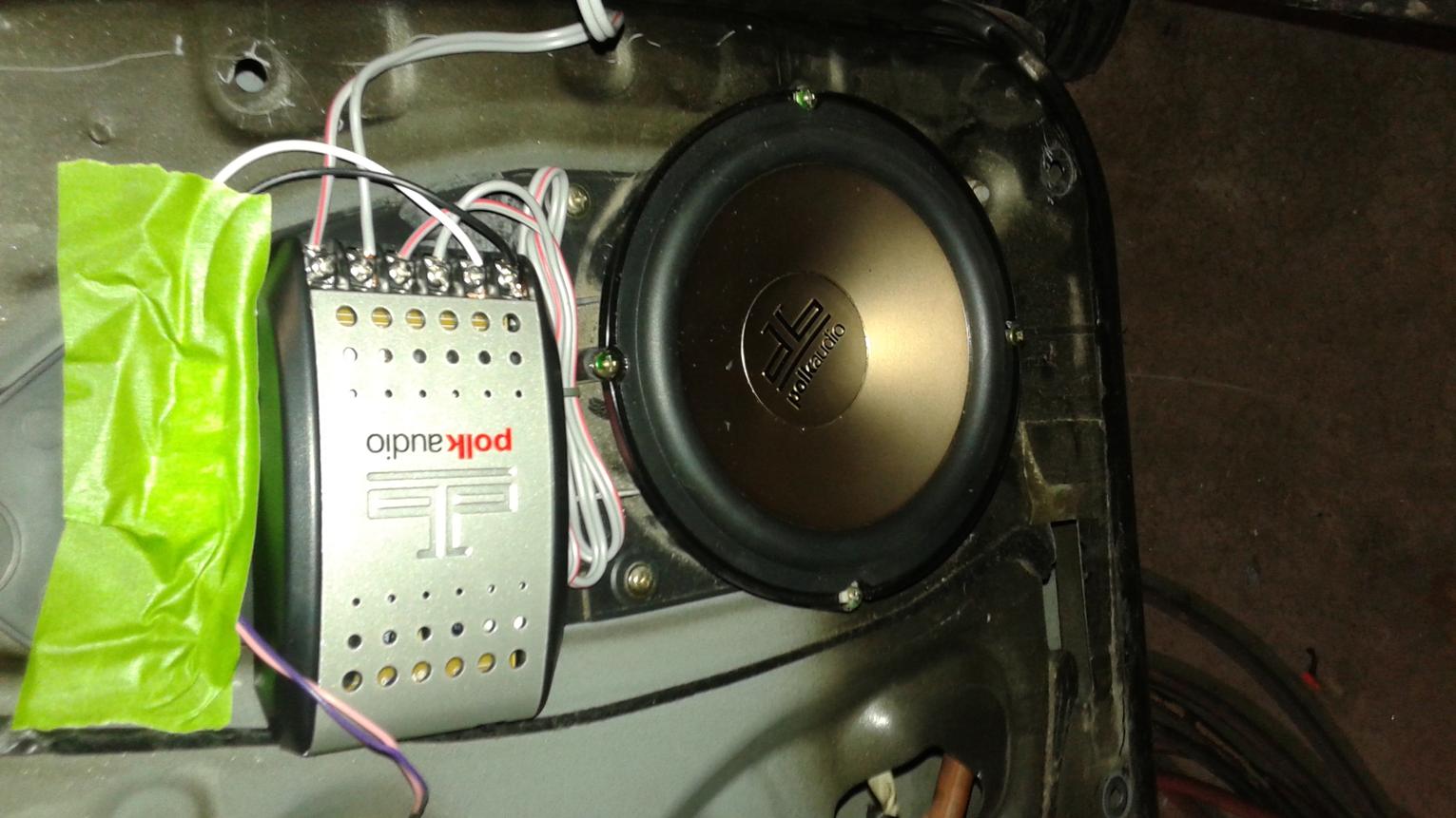

Installed some Polk db6501's. Woofer mounted into the factory panel with no mods.. I used the tweeter cup that came with speakers(the one w/o the lip), hot glued it in the factory tweeter panel and used a dremel to trim it to clear the door frame.

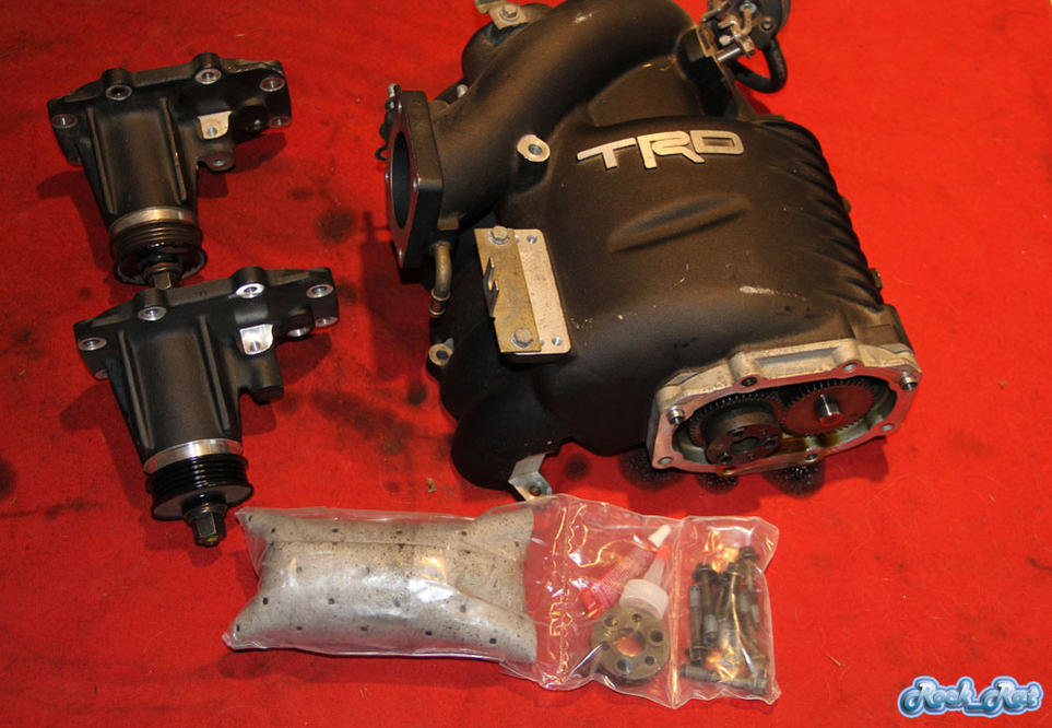

TRD SC Nose Cone
Finally got around to replacing my Nose Cone on my SC. Waiting for the rest of the "toppings" before install.

Hey when are you planning on install?
I'm heading down to San Diego for a couple weeks, leaving in a few hours, but if you aren't planning on installing it before then I'd be more then happy to help, or at least drink a few beers and watch...lol, but serious it would be good learning experience for my 1st gen SC install.

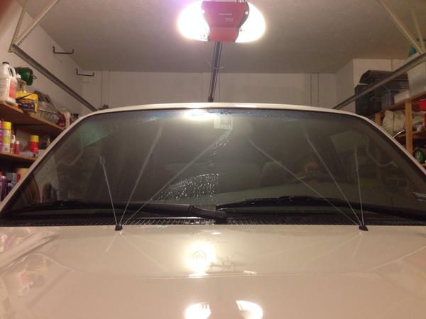

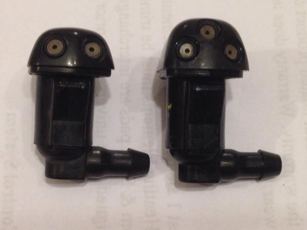

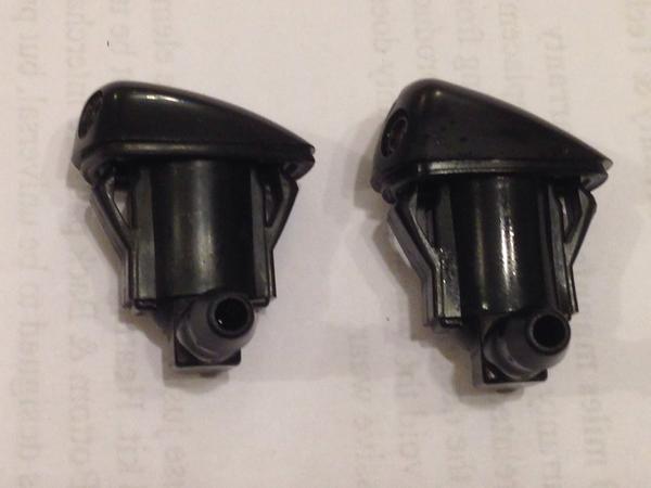

Was out at the salvage yard today looking for a headliner grab handle for the driver's compartment. Remembered what [MENTION=69868]LittleCaesar[/MENTION] had said about putting 4th gen wiper washer nozzles on his 3rd gen. No junked 4th gens in the yard, but also remembered a 2001 RAV4 being there from a previous visit. I ventured over there to see what kind of nozzles it had and 'what do ya know?' Perfect match but not with two jets per nozzle but THREE! These things are amazing. Also read that with a pin or paperclip stuck into the hole of the nozzles, they can be pointed to where the spray goes (I used a very small awl and WD-40). I had no idea that this could be done! Still have a little dialing in to do but what a comparison between the old 2-jet nozzles and the 3-jet nozzles. The best buy for a dollar that I've had in a while!!
Left: OEM. Right: '01 RAV4
You happen to know if these came from one with the cold package or just the standard? Parts diagrams differentiate between the two.

Not for a while. Probably around President's day weekend or later. Debating on whether or not to install larger injectors with a Walbro fuel pump. Also, searching for a good deal on Doug Thorley Headers. BJ's Offroad is going to add them to their website again this week. There's a few other "toppings" I need like the AEM F/IC-6. I'll keep you posted!! Finishing up my axles with the extended boots this week. Grrrrr
