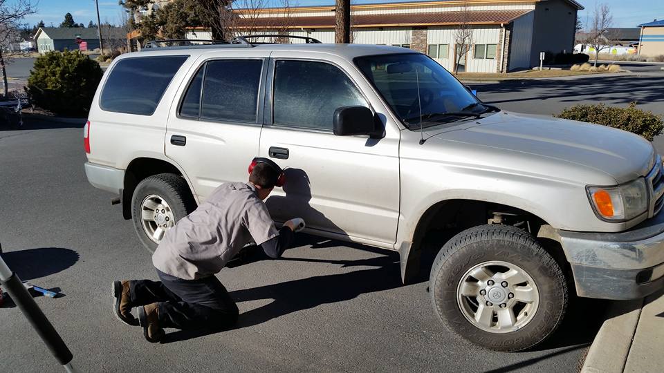

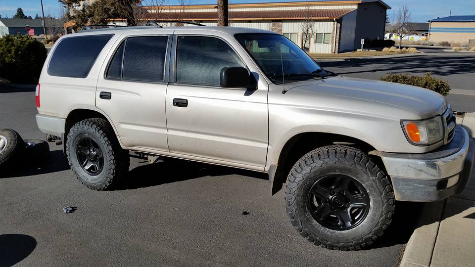

just picked up these. there is this odd looking thing on the driver side fender.
I feel better now.

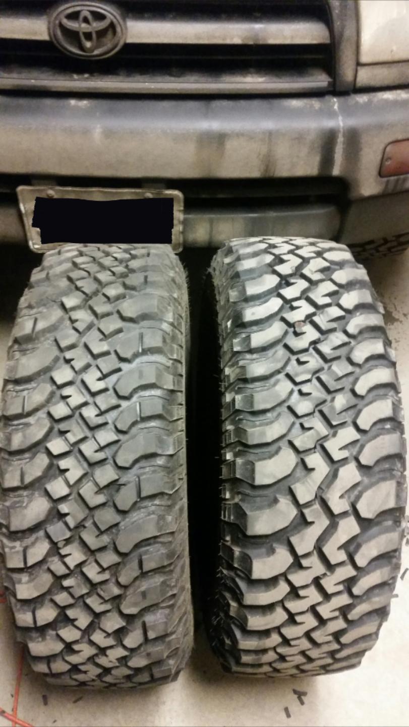

I went a little crazy the other night with the tire grooving/siping tool on my BF Goodrich Mud Terrain KM's 255/75/17.
I have been driving in a winter/snowy climate for a lot of years so I feel VERY comfortable driving in any conditions, but these tires on my '98 have been a sketchy combo. I've been feeling the back end walk out on me at even low to moderate speeds (in 2wd) on the highway so I felt that I needed to do something.
I got a GREAT deal on the tires. 1 brand new spare and 4 with under 1k miles for $500 and I couldn't pass it up.
I guess we'll see what happens once we get a little more snow.
This is just showing the grooving, I'll upload a picture of the siping once they open up a bit.
