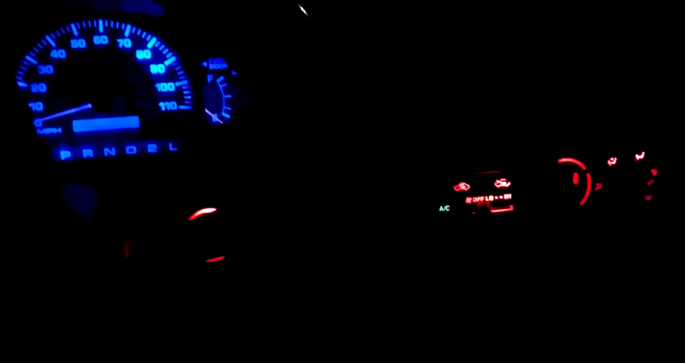

Leds!
After over a year of burnt out climate control bulbs, any sort of light is exciting :) The picture makes the hot spots much more prominant than they actually are.

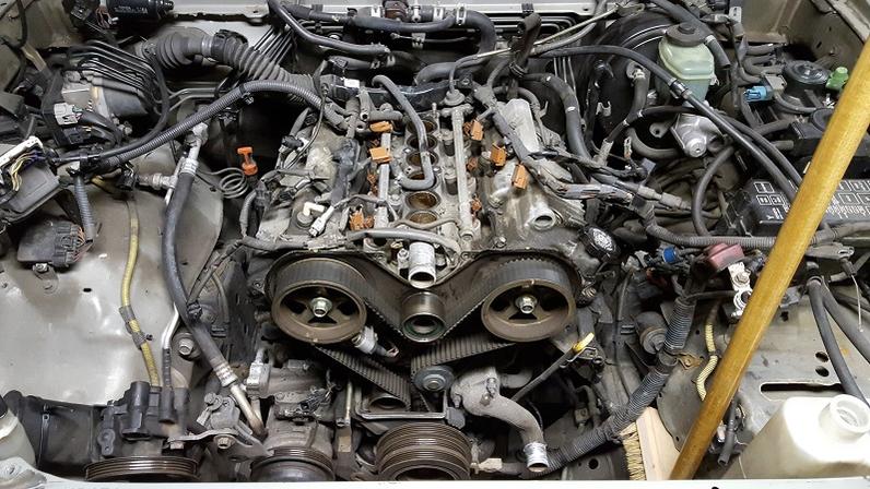

Started the tear down for head gaskets. The truck is roughly at 213000 miles.

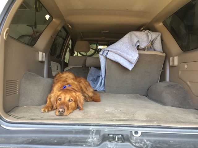

Since the beginning of February, I've been tackling a few projects on the 4wd 4Runner.
First off, since I purchased the vehicle last year, I have a had a loud disconcerting whine/grind from the driveline that was difficult to pinpoint (for me) and filled me with gloom that it was going to be an expensive affair to repair. A local 4Runner guru told me it was most likely the bearings in the rear third member. I was concerned that it might be the front as well from where the sound seemed to come from, but he assured me it was most likely the rear as the front is not under load in 2wd. Took a chance and ordered a used third member off of ebay for $300 and installed it myself and voila, the whine/grind is gone. Can't tell you what a score that is in my book!!
Thanks to [MENTION=20456]Mike07SE[/MENTION] for his install steps in the following thread:
http://www.toyota-4runner.org/4th-gen-t4rs/153135-new-3rd-member-install.html
Secondly, installed Tundra 231mm brake upgrade with stainless braided brake lines front and extended line in rear.
Thanks goes out to [MENTION=8729]Speedy[/MENTION] and [MENTION=44220]BigFishAllDay[/MENTION] for their informative posts and amazing video:
http://www.toyota-4runner.org/3rd-gen-t4rs/94923-hard-find-specs-info-measurements-231mm-13wl-tundra-calipers-rotors.html
http://www.toyota-4runner.org/3rd-gen-t4rs/152500-speedys-13wl-231mm-brake-upgrade.html
Next, installed TRD Tundra Springs w/ OME 906 in rear with Bilstein 5100s all the way around netting me 2" inches of lift front and rear. I followed [MENTION=8729]Speedy[/MENTION] 's thread and video exactly to get it done. Thanks again, Speedy, for your awesome contributions to the forum. Big thanks to [MENTION=9596]paddlenbike[/MENTION] for his advice on suspensions, as well.
http://www.toyota-4runner.org/3rd-gen-t4rs/154200-speedys-lift-install-how-video.html
Lastly, I've been having to install all new seat belts due to my dogs inability to calmly watch and wait his turn to run marks and blinds with all the other hunting dogs at the trainer's client days. It amazes me how fast he can saw through something and I'm very lucky he didn't go for the upholstery. It is definitely a hard bite on the wallet even when sourcing used retractors. Of course it is ultimately my fault for not having him in a crate in the vehicle. Still, bad dog, Wrigley, very bad dog!
