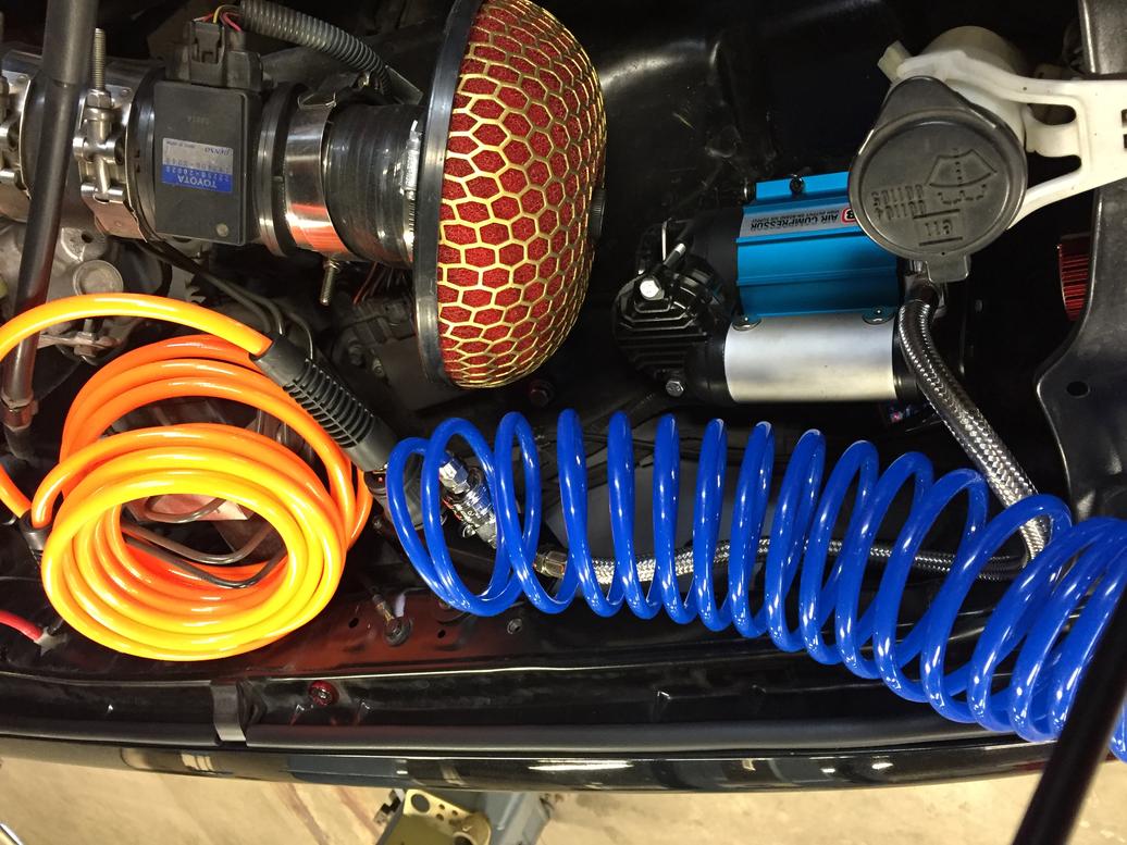

Tried to finish installing my ARB air compressor and Distro block, but I am now trying to fix all the leak points. The ARB is solid but the 1/4" plugs do not seem to be sealing up on the Distro block so I have lots of leaks. :(
That air filter really looks like it opens up a ton of room in the engine bay!
