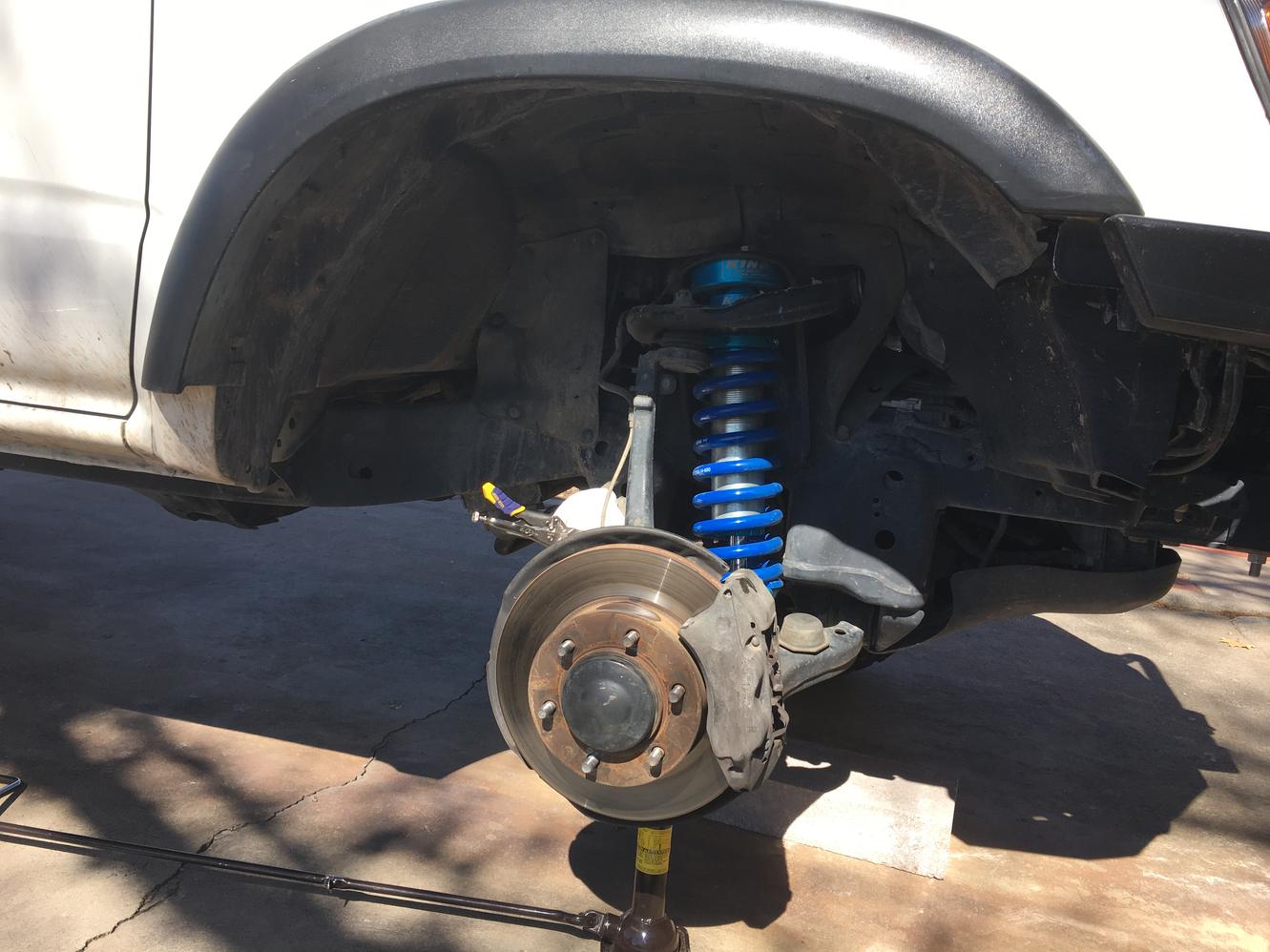

Had to order an extended rear brake line. Then realized I needed a new front sway bar bushing and bump stop set and top plate spacer from Wheelers to deal with the lift aspect finally being done after several months of being a cheap ass with accumulating parts.
bump stops in the front are just a band-aid for trimming. also your uca is going to rub even worse with a top plate spacer.
The spacer is for driver side lean. I don't intend to remove my sway bar and Wheelers kit comes with the new bump stops. Figure replacing 16 year old stuff isn't a bad idea anyway.
move the perch up one on the drivers side, running just a top plate spacer on one side is a mistake. I have my drivers side on the 4th, passenger on the 3rd.

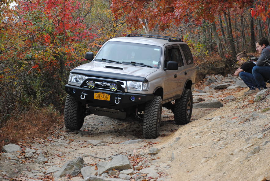

Tapered suspension lift, tapered body lift, what're you tapering next? :hug:
its the same as adding shims or moving the preload collar on a coilover. adding a top hat to one side, would be like moving the entire coilover mount up and down.
Also I'm pulling a tad more than 11" up front with 35's and my current setup, and only rub slightly at full lock, so my setup is doing exactly what i need it to however unorthodox you might think it is. I'm not the only one running a tapered body lift now ;).
