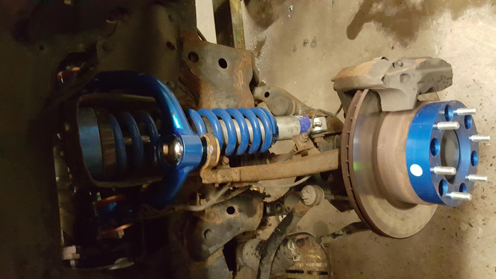

A tip on those LCA bushings... Throw them in the freezer. Now.
After you take the LCAs off, just have a shop press them out unless you've got an air hammer or a LOT of time on your hands. I did the bottle jack trick on one of mine and it launched that thing out with who knows how much energy. The other side it pushed the rubber part out, but left the metal sleeve...
With the old bushings out, and your new ones nice and cold, they're slide right into the LCAs. One of mine I had to bop once with a mallet to get it all the way in.

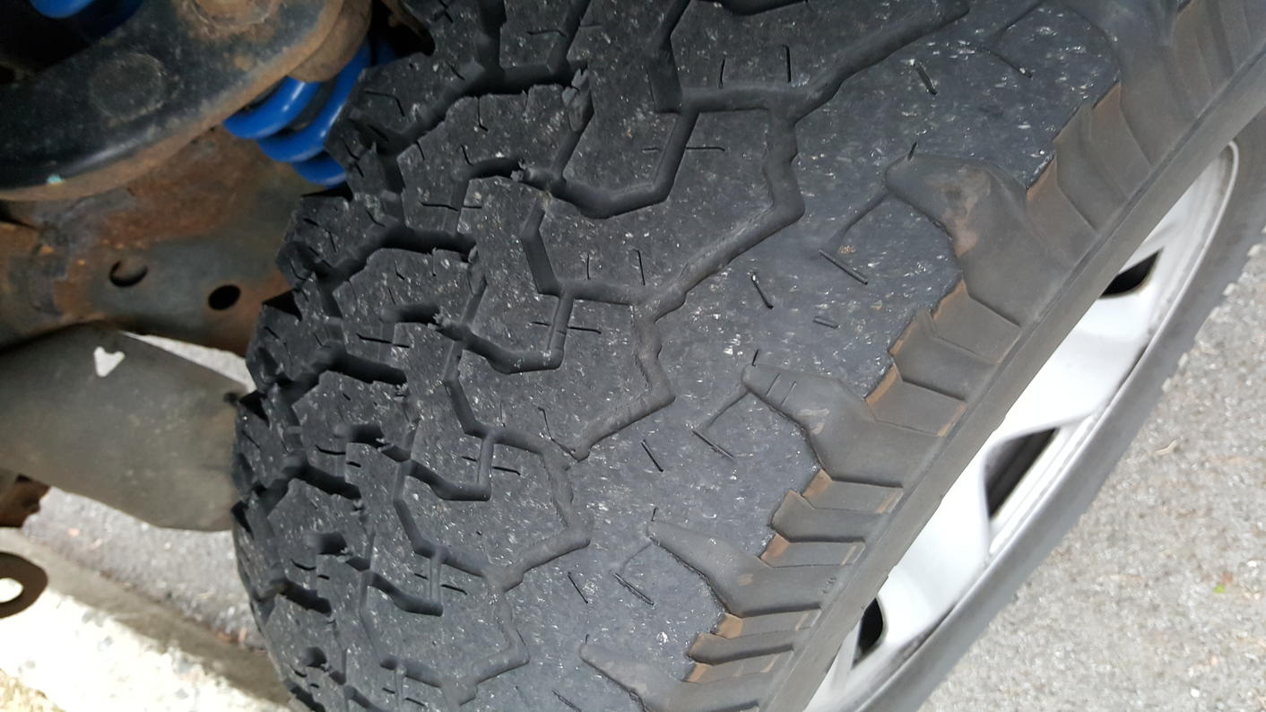

Too bad to was too late for my new tires... i can believe they wore so fast...:cry:
