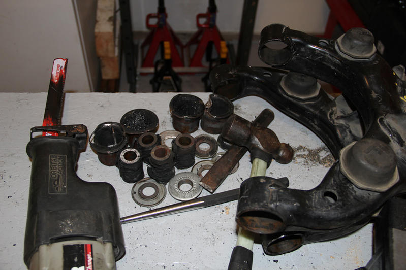

Removed LCA Bushings
Success!!!!! At least on one side. 2 full days to cut two control arms out. Press out and burn the rubber. I almost got the seized sleeve out to reuse but I used a to big socket and just pressed my 14mm into the sleeve. Lol. Went to napa and bought a new $30 bushing and burned it up just to steal it's sleeve.
Also had to use the tire vise. Table vise not good enough. I swear I could hear my truck lifting off the stands.
Once I got it down it went pretty smoothly. Got all of them out without any problems. Took a couple of hours between yard stuff and wifey things. Not that bad of a job. I'll press in the Whitelines and add in the new bump stops from Wheelers later on in the week. I'll do a write up in my build thread for others.

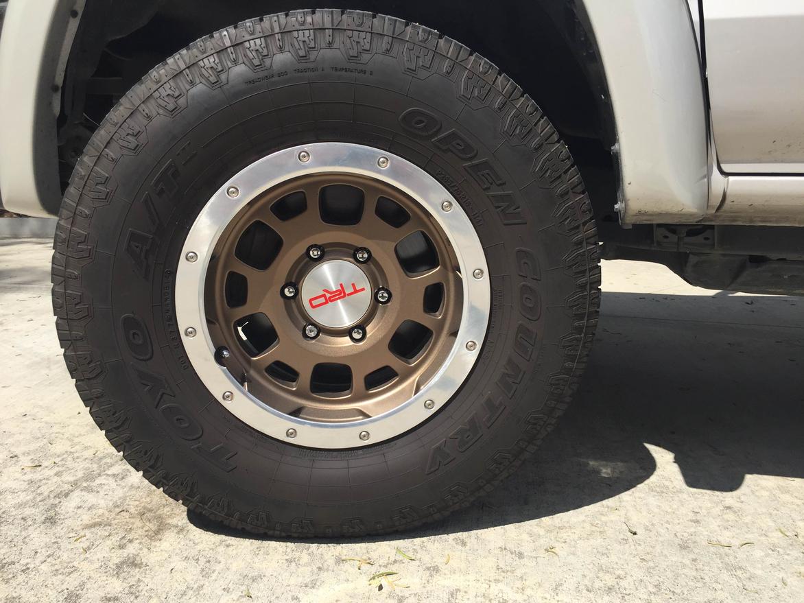

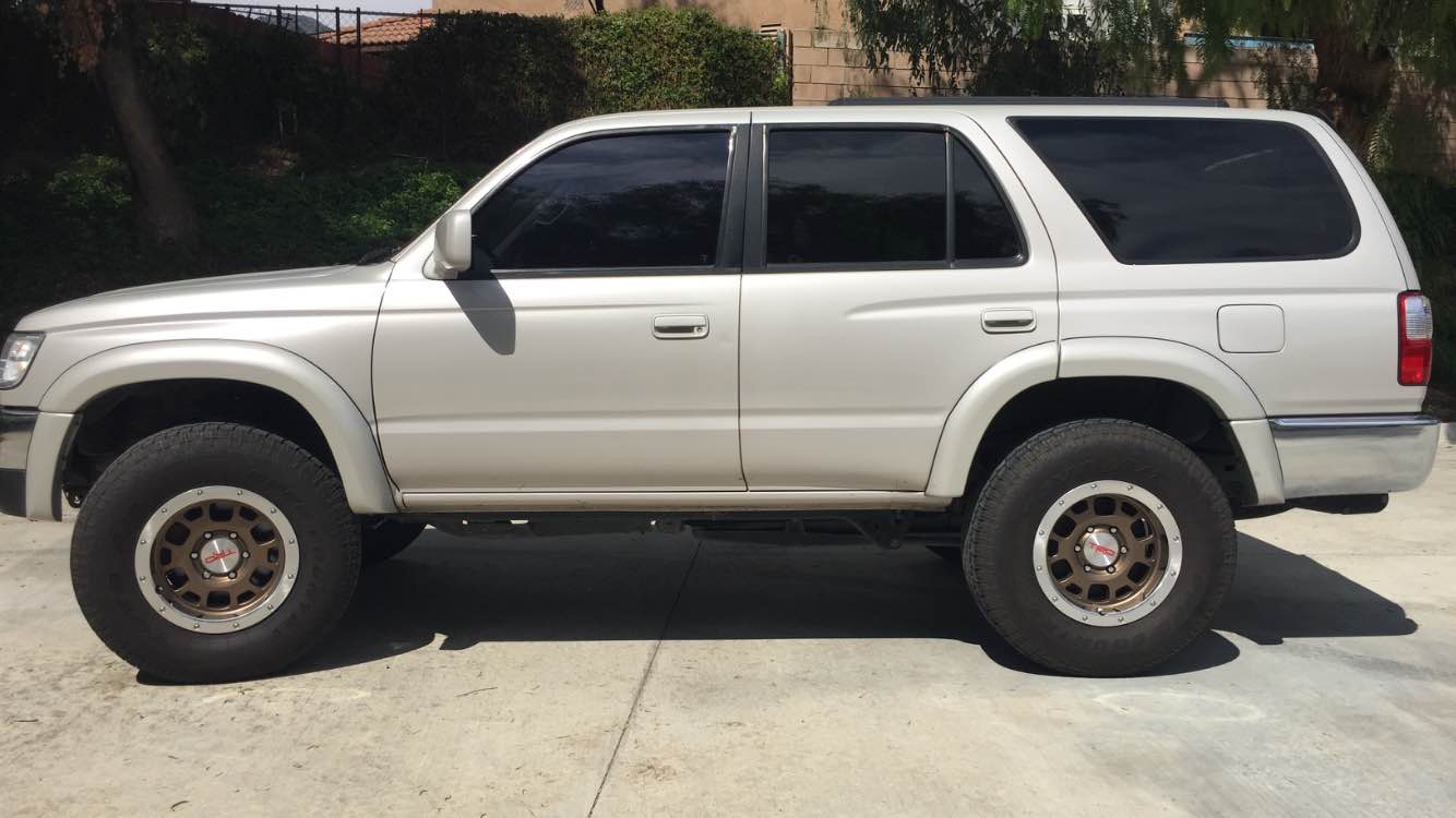

Finally pulled the trigger on TRD Bronze Wheels! Been searching for a deal and debating look and fitment for way too long. Thanks to a timely craigslist post, from new member 'Haris', I made the purchase and happy with the results. Now I just need to find a hood scoop in my area!
I LOVE those wheels. If a set fell in my lap I'd run them for sure.
